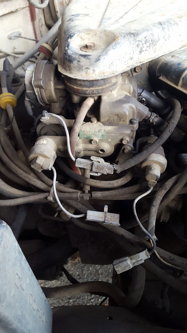

There are actually 2 disconnected wires coming off the carburetor. The choke is yet a 3rd wire but it is connected and is working. The two wires are the male end in a connector but I cant seem to find where they should connect to. The truck does seem to idle a little too fast and there is no more adjustment left to slow it down any more. The hi-idle kick down works but the base idle is too fast. I am assuming that if these wires were connected that might help as they go to what looks like a little diaphragm on either side of the base of the carburetor. I took a photo but I have no idea how to post it on this site.

Ok on my 81 300 six there is only 1 wire to the carb and that is for the choke.
So you have the idle speed screw out and not touching the stop.
Is the fast idle cam & it's screw holding it on fast idle?
If both of them are not touching the seats try and pull the throttle cable off at the carb and see if it is not lower.
Dave ----
Would like to see a picture.
Take a picture and save it to your computer.
Then go to the advance button and at the top to the right side, the box that looks like a mountain in it "insert image". Once you click it follow the screens.

If this works, here is a picture of my carb. The choke wire is at the top and connected and working. The two near the bottom are not connected and for the life of me, I can't find a connector anywhere near the two wires.

To answer the rest of the questions, The idle adjustment screw is not touching anything and the cable is not hung up. (I even checked under the dash on that end). It won't come back any further. The idle is even higher after setting the choke on a cold start but I can tap the accelerator and it drops down, just not far enough. It has no tach, but when comparing the engine speed to that of my Ranger, I would guess that it is running at a strong 1.5K. (About 2K when on hi-idle but it drops down nicely when I tap the peddle)
