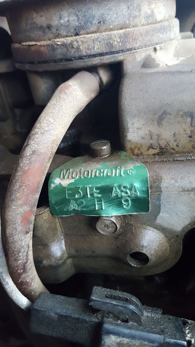

Also I see a green tag on the carb post up the numbers as I am sure someone can find what it came from or is to.

Here is a close up of the tag on the carb on my truck. I believe that this carb doesn't belong on this truck as I haven't been able to find it on the Internet when searching for 1980 F-150 300 in-line 6. As far as I can find, there should be nothing electric on the carb on my truck other than the choke. <br/>
