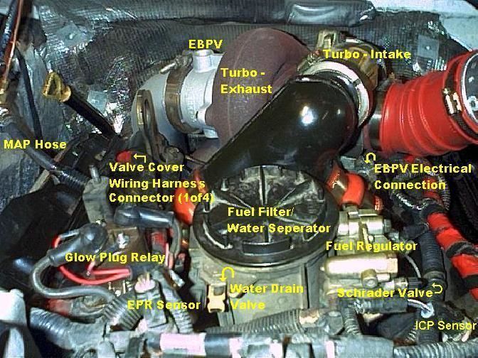

IPR is right behind the HPOP
This pic don't sow it but should be helpful for the other items names

Right on it is helpful so do I have to remove the fuel bowl to get to the hoop and ipr?
