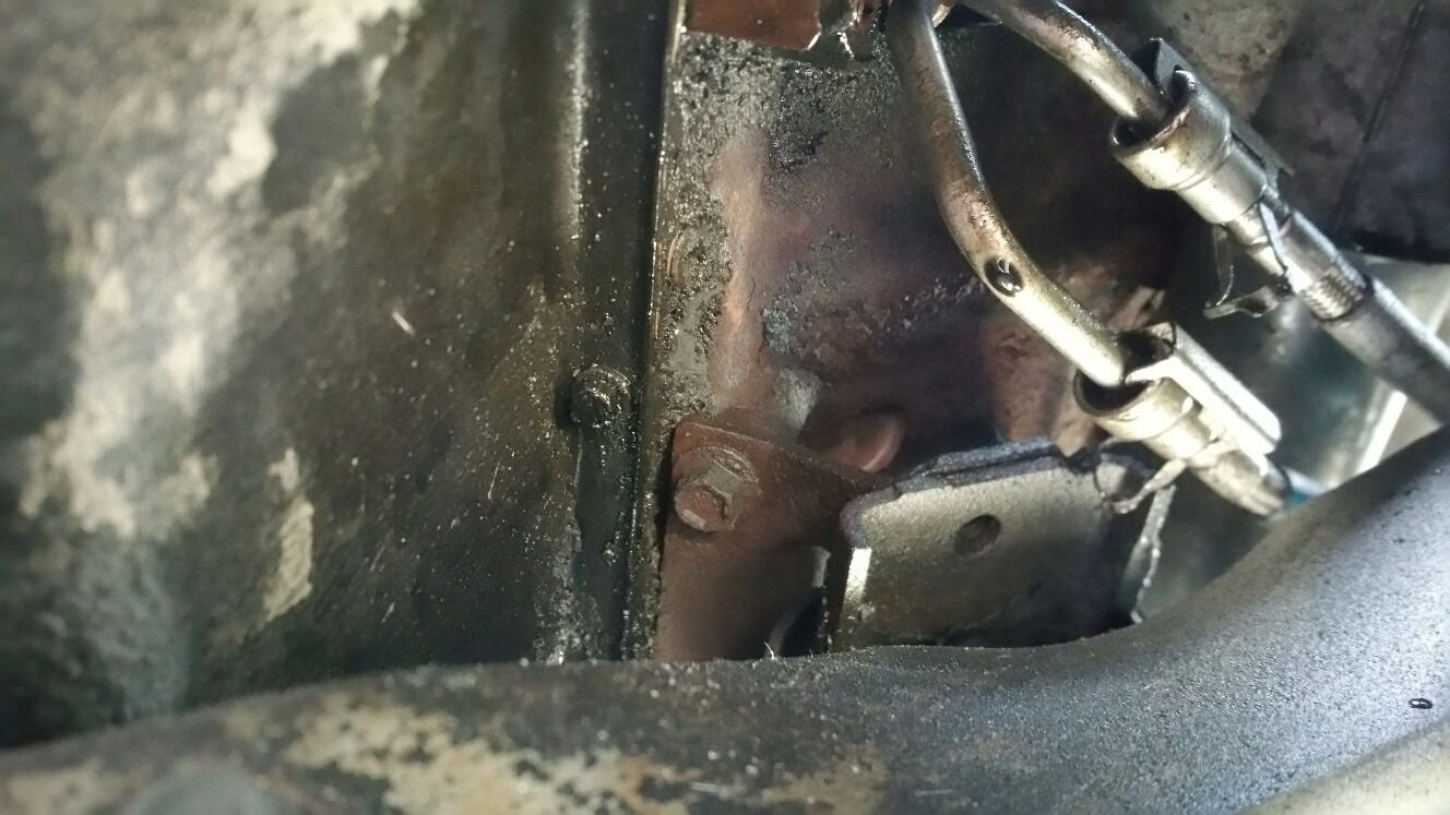

Well dang. I guess it could be just on it. Oil is all below it. I figured that it was it as it is the furthest forward part with oil on it and the wind is blowing it back. Maybe its just a valve cover leak? I don't see oil in the valley. I have all new stuff there e fuel and hoses. I don't see oil on the header. But below it in the shock tower and around it. Is there another oil port the there? I will grab some pics.

pass side
pass side
dipstick oil pan. sealed again
pass side
pass side header
pass side back of fender well oil all over
pass side
valley
front of engine
under oil cooler
drive side fuel lines all new
driv side all new. not il cooler must be o ring above?
power steering cooler line

Man, that's a mystery! I guess the only thing you can really do is clean things up good and watch it to see what gets damp first.

front main seal looks to be wet

These oil leaks apear to be from different spots, and if you have bad blow by it will only make it worst. Give the engine a good clean and look to verify where exactly the leaks are coming from. It does look like your timing cover crank shaft seal is leaking.

I cleaned everything up and it stayed dry around town. But the long trip from nv to ut and back made it come out. I think the oil under the pulley is from the drivers side. Maybe the oring? I dont have time to mess with it so it's going into the shop.

Took the truck into the shop. They found my breather was missing a o ring on one screw. The breather looks almost blocked. the o rings are dry and not leaking. we still don't know where the oil was coming from on the other side of the engine. It could have been the blowby but everything look sealed up now. They put die in the oil and asked me to come back in 200 miles or so. I had a vibration the kept getting worse. I found some bolts coming lose on one side of the rear driveshaft u joint. I got new bumpers in for the truck from Move. I just need to weld them up and paint them.
