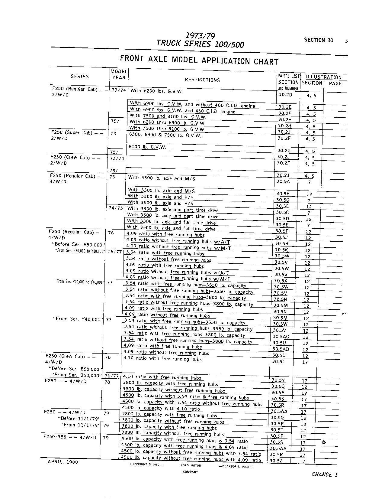

Parts listed in Ford truck parts catalogs are the original parts installed on the vehicles, not aftermarket conversion parts.
4WD rotors and other misc. brake parts are listed in the front driving axle parts section of the catalog.
Pic: Scroll down to 78 F250 4WD
For your 1978 F250 Dana 44 w/3,800 lbs capacity, the parts list is either 5Q (with free running hubs) or 5P (without free running hubs):
