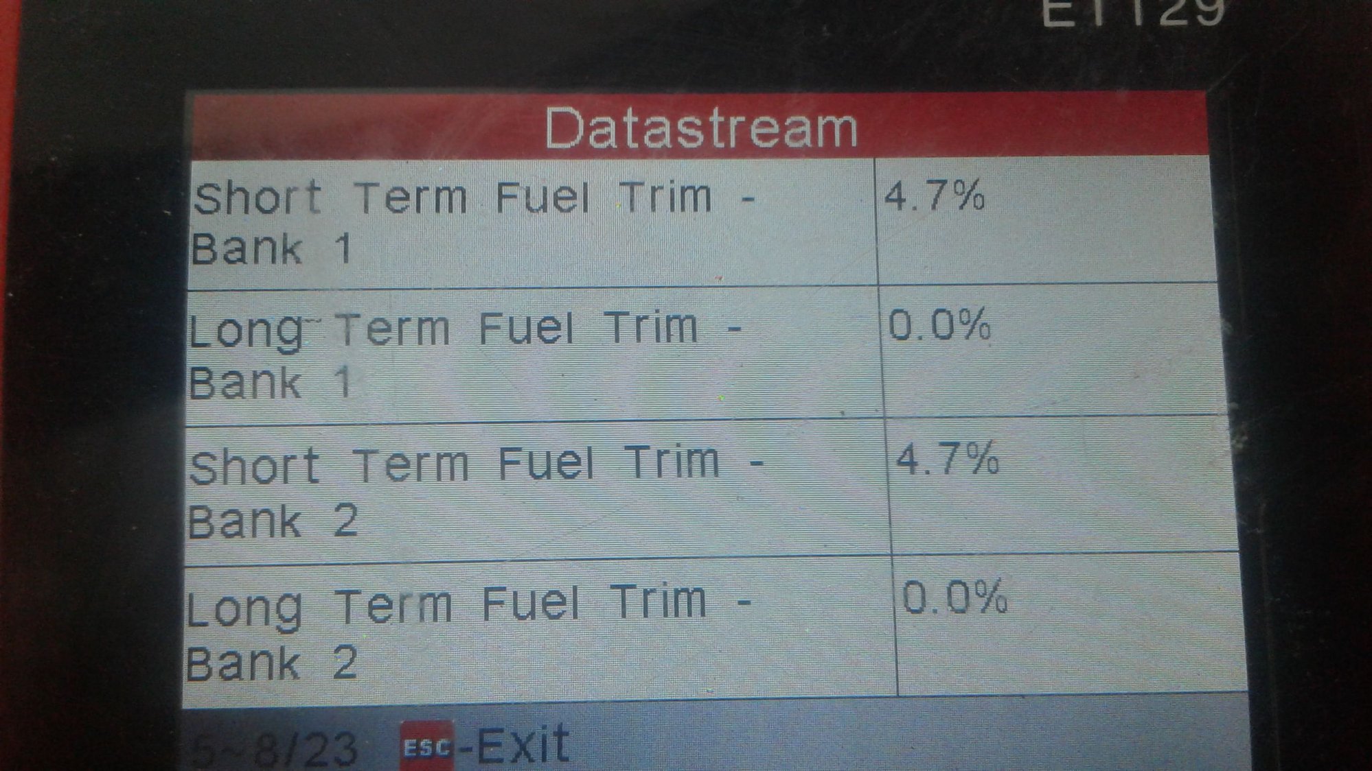

Numbers on data stream, these held fairly steady until engine up to temp then they leveled out
Numbers on data stream after leveled out
spraying carb cleaner around intake and throttle body had no effect on these numbers
