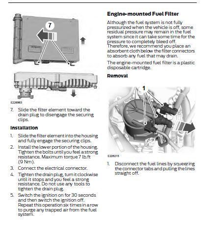

Originally Posted by oklarado
I changed filters today. Maybe I missed something but the damn thing drained for an hour , 4 gallons worth, I got tired of waiting and took it apart anyways and the result was one hell of a mess. The online videos I've seen they didn't have a mess like me, is there a valve or shutoff somewhere?
In order to prevent the fuel tank from siphoning while draining the water separator for a filter change it is necessary to disconnect the fuel line quick connect coupling from the in tank fuel pump.
The procedures for changing both the water separator and the engine mounted fuel filter can be found on pages 360 to 363 of the owners manual.
Here is a synopsis for you...
Hope this helps, this can be a messy job!
Other members here have reported the fuel line connections going to the engine mounted fuel filter being cracked if not handled properly....
DIESEL BROKEN RETURN FUEL LINES
