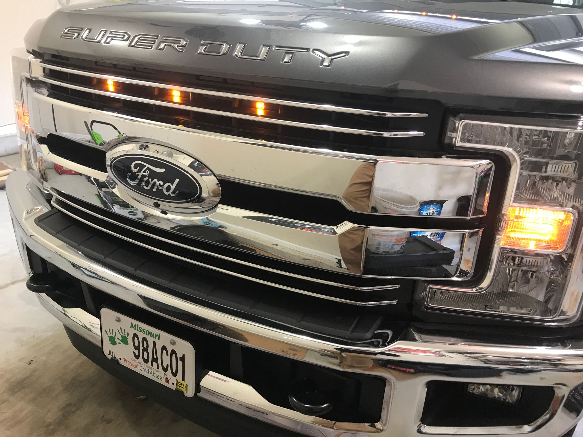

Today I undertook the project of installing the Raptor Style grill lights from Stage 3 Motorsports.
I had never removed a grill before on any vehicle.
This is a very easy project. The lights have a very OEM look to them as they match the color and intensity of the other marker lights perfectly.
If anyone decides to do this project here are some tips and thoughts.
Get a tool to remove the plastic tabs that hold the shroud covering the top of the radiator. You can get one at any auto parts store for less than $10. I bought an entire trim piece removal kit from Amazon for $15 and received several different tools.
When removing the grill I would suggest loosening it a bit from the top and then pull only on one side of the grill. It come come loose easier.
I did NOT have to remove the bottom part of the grill...I just leaned it towards me and slid the Raptor lights into position. Then did a little mock up to make sure everything was going to fit. Then I wanted to make sure the lights worked.
My hands are to big to get to the plug for the driver side marker light so I had to remove not only the washer fluid neck but also the driver side batter. It added maybe 5 minutes to the project but it sure made it easier to get to the plug.
The good news about our trucks (if you have dual batteries) is if you disconnect one battery you still have power to the truck. Everything still works. So I could keep an eye on my connections confirming all was secure and working properly while one of the batteries was disconnected.
Before I replaced the battery and washer neck I then secured the wires with some zip ties.
I have already received several compliments from a soccer game I attended today from other truck guys who saw me pull up.
Hope this helps.

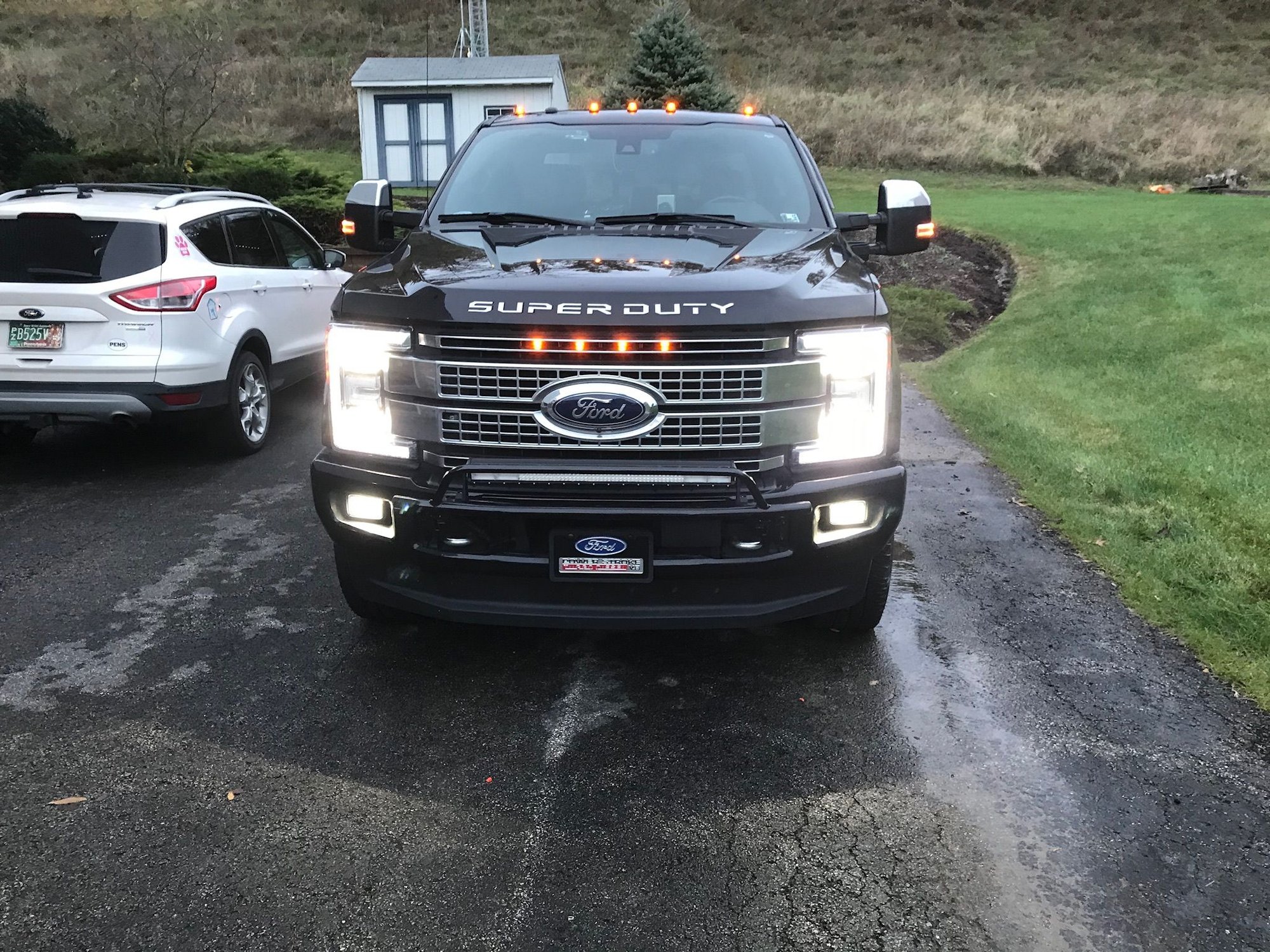

I have a platinum so I went with this:

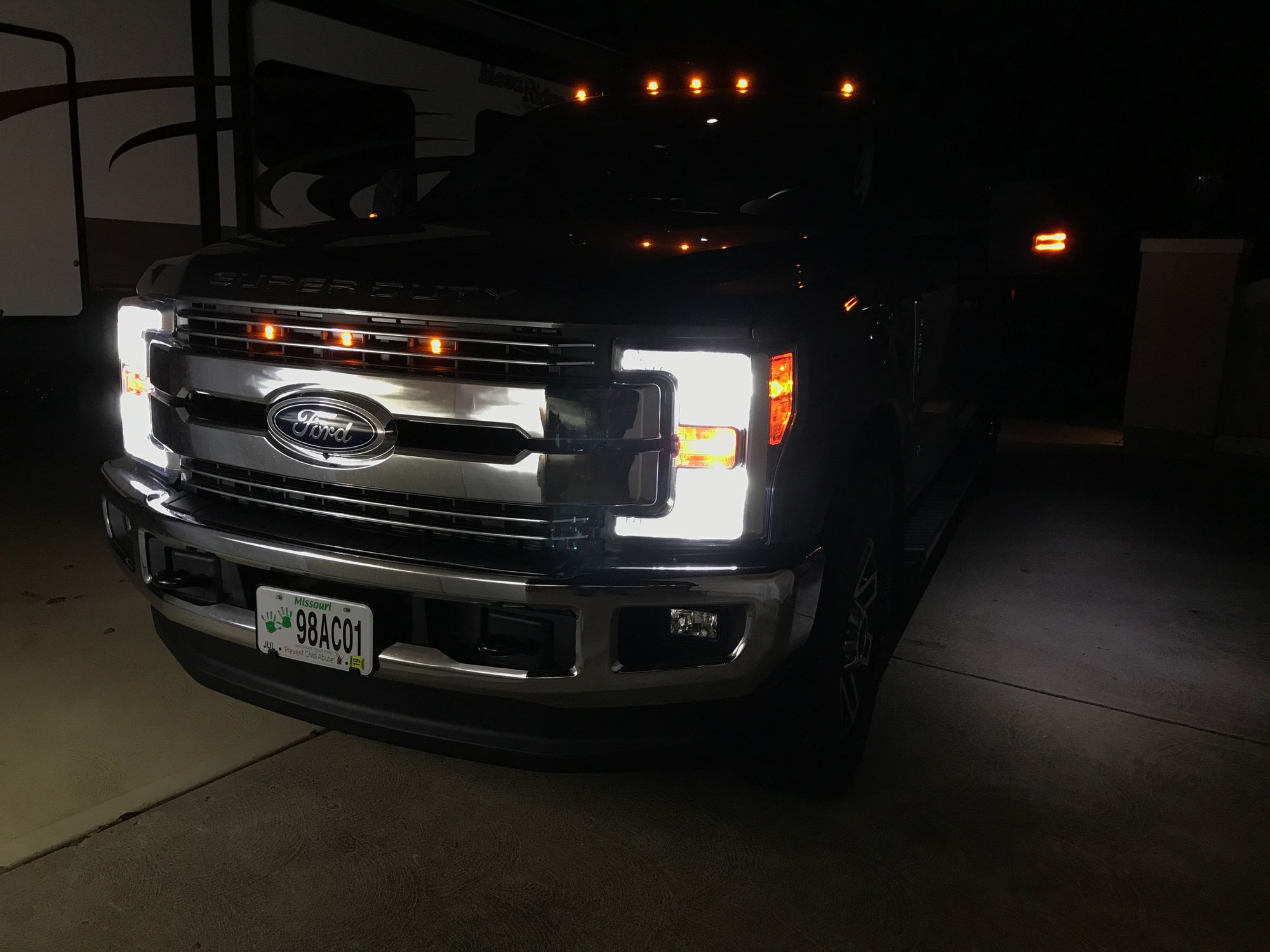

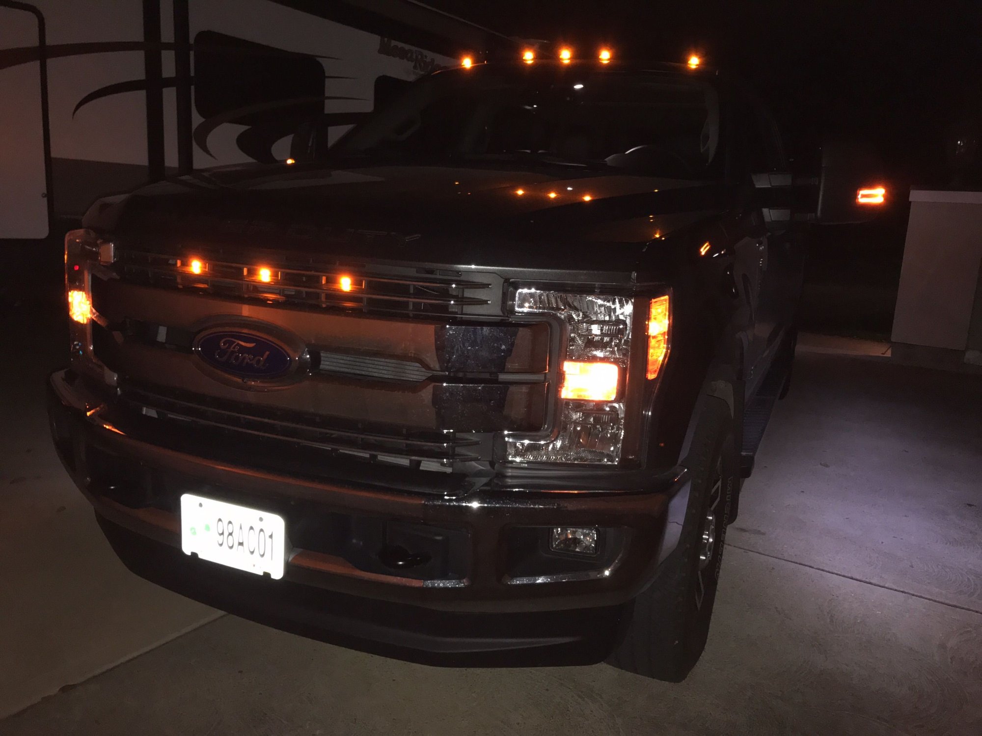

Night shots. Man, this truck needs a bath.
