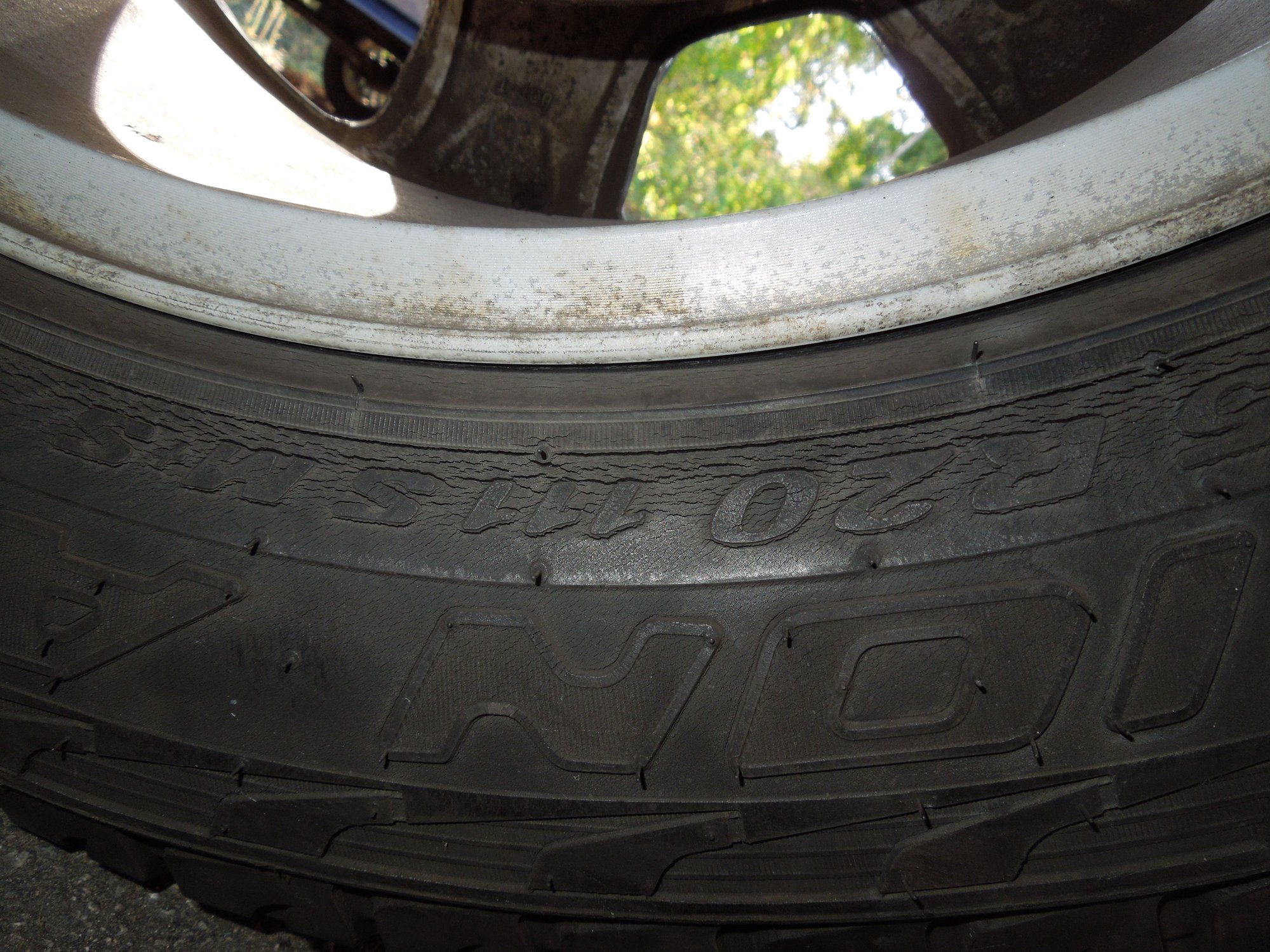

I foolishly didn't look at the inside of the tires during this inspection so didn't see the dry rot on one rear tire. When I brought the truck back I told them what problems I found and was told the repairs would be done under warranty.
When the repairs had been done I could see the rotors had been turned, new pads installed and could see sealant around the differential cover so I purchased the truck. I was told they couldn't find anything wrong with the steering effort.
At this time they couldn't bring it in for an inspection sticker because their machine was down so told me to come back in several days. The next day I got under the truck to inspect the driveshaft seal and it looks like they just cleaned off the bottom of the cab without replacing the seal. At this time I noticed the tire was cracked all the way around it. There is one split, right above a ridge, that goes all the way around the tire. The multiple cracks also go all the way around the tire.
I called the dealer and asked if a dry rotted tire with cracks all the way around it would pass inspection and was told it wouldn't because it is a safety hazard. I didn't tell the person who I was or that I had just purchased the truck. When I got to the dealership I told the service adviser that I had called about the tire and was there for a sticker. He looked at all of the tires and told me he didn't think the tire would pass inspection but told me to wait in the showroom and he would have the truck looked at. After about a half an hour I saw the sales manager go out to the service area and then return. He smiled and patted my shoulder as he walked by. I think he was smiling because he got away with not having to replace a tire. About another half hour went by until the service adviser came and told me the truck was ready and it passed inspection! I reminded him that he didn't think it would pass inspection but he said he was just the adviser and didn't know as much as the inspector. I drove to another inspection station and asked them if the tire would pass inspection and was told it wouldn't at their station.

Thanks for the buyer beware reminder. Unfortunately Ford isn't going to see this as they no longer monitor this site.
They stickered the truck and most likely shouldn't have but it's a judgement call that you'll never win.
However, tires come from the factory with a six year prorated warranty against defects such as this. You may have some luck going to a shop that sells these tires to see if you can get some assistance.
