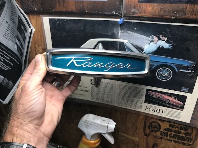

Originally Posted by Jmiller68
I'm confused, I have a 1968 Ranger. The truck has been in my family since '72.
I took ownership in 2000. The grille has the red stripe and center piece like a '69. I'm told from family the truck always had this grille.
Did '68 rangers come with this style grille?
No, only the Ranger emblem is the same 1968/69.
Only the 1969 Ranger grille (C9TZ-8200-A) has the red stripe. No 1968 Custom Cab or Ranger does, neither does the 1969 Custom Cab grille.
The original 1968 grille was not indented, but the FoMoCo 1969 "service part replacement" for the 1968 grille was.
The confusing thing is, it has a 1968 part number (C8TZ-8200-E), but it's not the original 1968 part number.
The Ranger grille emblem is the same 1968/69.
