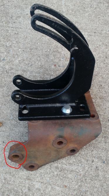

Here's a couple pics from mine.
The unpainted portion is the A/C Compressor bracket. What's circled is where the PS bracket bolts to the front of the engine.

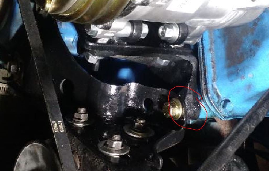

Circled part is the same as Pic1 but mounted on the front of the engine. I had a bolt there (not a stud) and replaced it with a new one when doing my AC upgrade.
