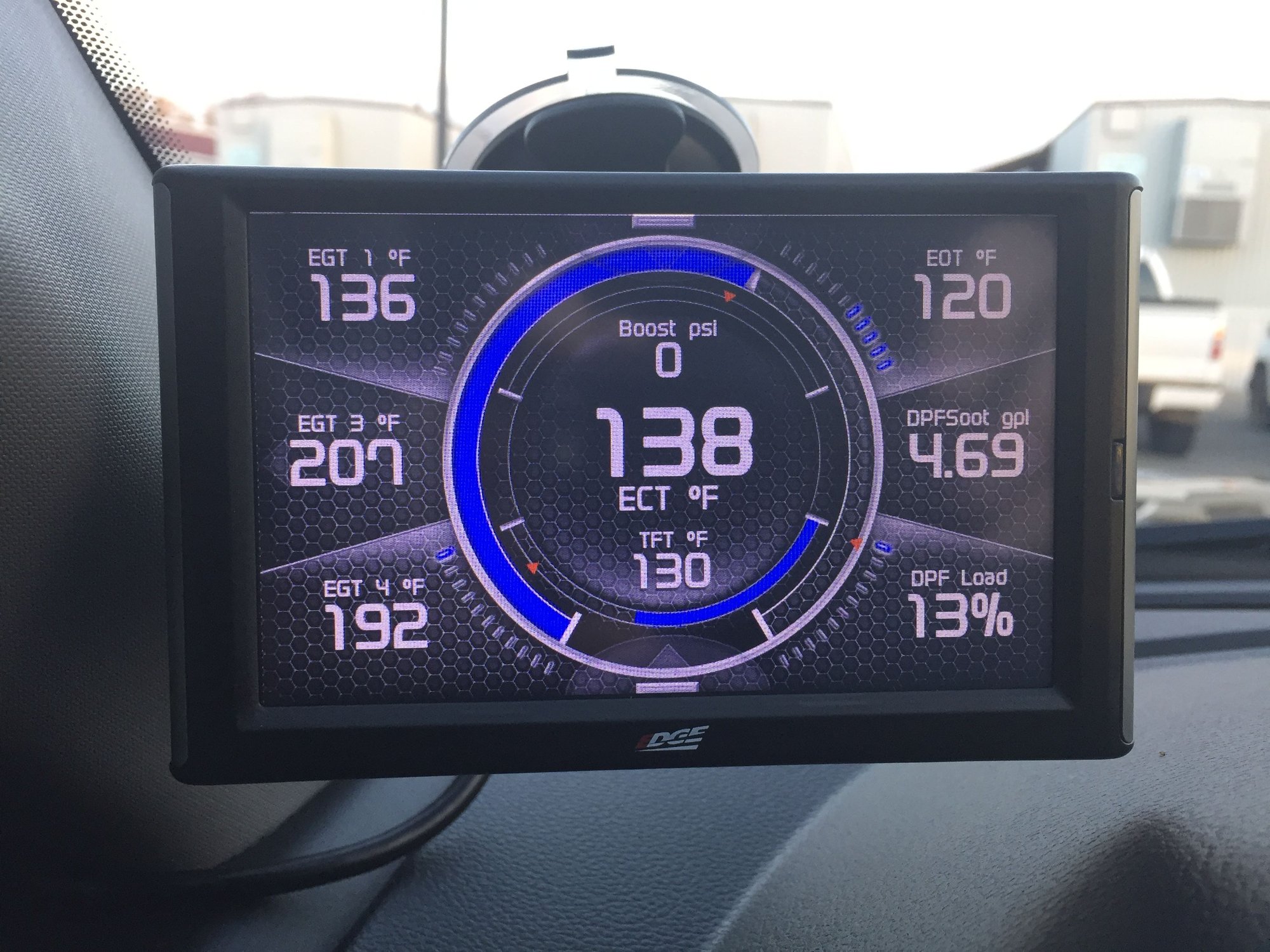

Great thanks Brandon. To get the exhaust temps did you need to place any additional sensors or are you able to grab a reading just by plugging in the insight to you connection? Also if can post a pic of your set up? That would be great! Ty sir.

No additional sensors required. Once you plug the monitor into your obdii port, it will ask if its Ford, Chevy, etc., when you get to the monitor screen, you can replace any gauge. When you go to replace the gauge a list of items appears for you to choose. I beleive there are 4 or 5 exhaust sensors to choose from. I have 3 in mine, also have dpf soot level and dpf % as well as trans temp, oil temp and boost. There is another for dpf status but it did not work on mine, I just watch for a regen when it hits 100%, you will see exhaust temps climb and you know its in regen, usually takes about 15 minutes of driving to complete. I will snap a pic here in a few.

I am also running the CTS 2 and had it ever since my 2010 SD lost a HP fuel pump while I was towing in the mountains. The idiot gauges in my '10 showed everything was "normal". Bought the Edge and never looked back. When I bought my '17, I updated the unit and installed it and have been monitoring everything at a glance. I use the 12 space grid now to see all the pids at once. Great to know when your in regen and can run it all the way through. It helps me montior while towing as I now know exactly what is going on and can possibly shut down if I feel something is going south. The '17s monitor so much more than my '10 did in stock configuration, but you have to flip through different screens. The Edge is always on and a glance away.
I only wish Edge would come out with a better mounting solution. The mount I had in the '10 looked factory. I really hate this thing being suction cupped to my windshield.
