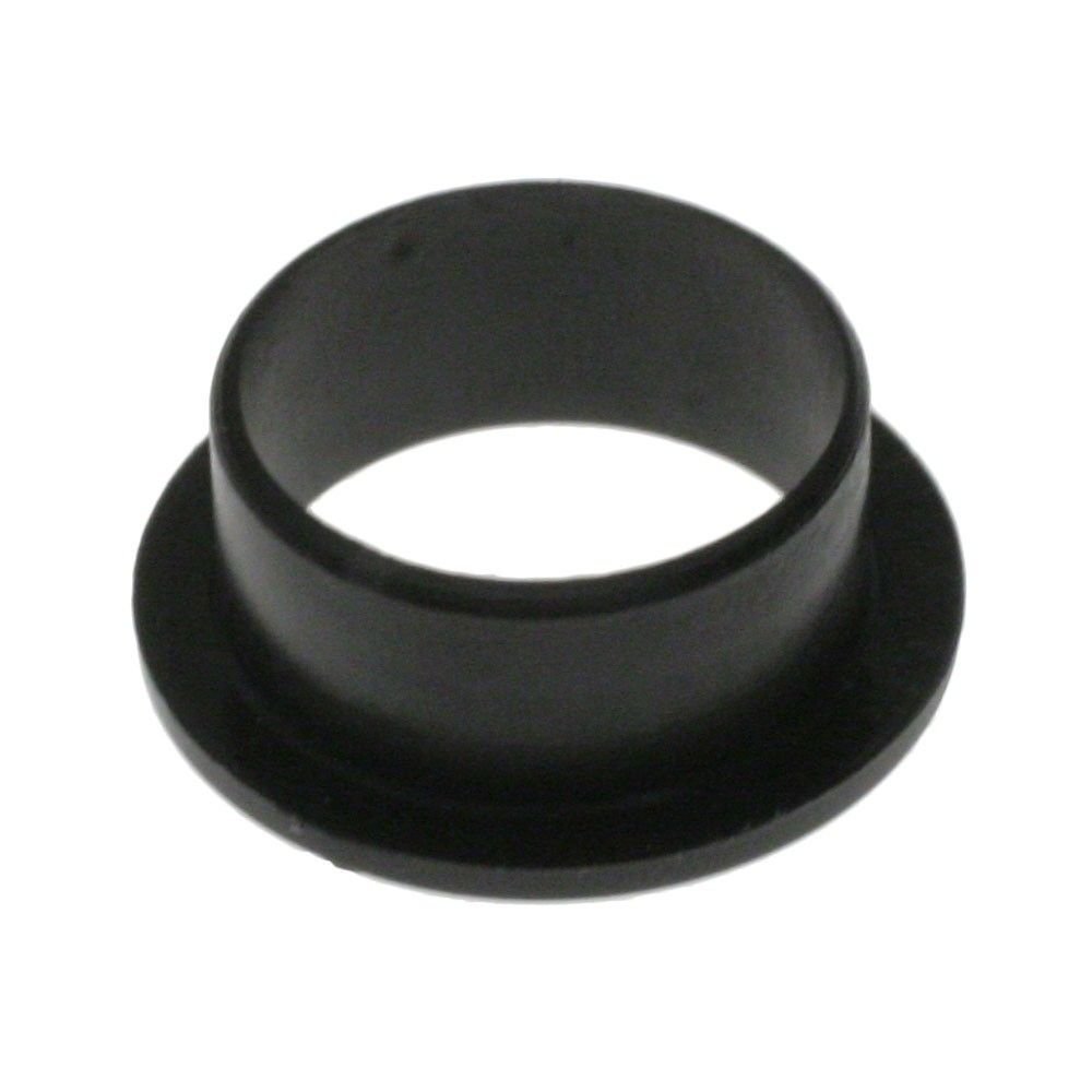

Thanks a bunch Steve. Have you ever installed the bushing for master cylinder arm?
There's one in the eyelet of the booster input rod on my truck. You just can't see it in my previous photo because the brake pedal is blocking the view of it from this side.

Thanks Steve, just ordered it. Kept chasing down why the brake lights stayed on, looks like the PO either left it off or it fell off. His fix was to add a SPRING to the pedal to pull it back against the brake switch

That's what caught my eye, I noticed the reflection on the wall in the garage and thought "that's weird". When I went to adjust the switch I noticed the pedal actually wobbled just enough to relieve the tension on the switch. I am hoping that after I replace the nylon bushing things tighten back up. If that doesn't work I was thinking of getting an adjustable master cylinder push rod.
