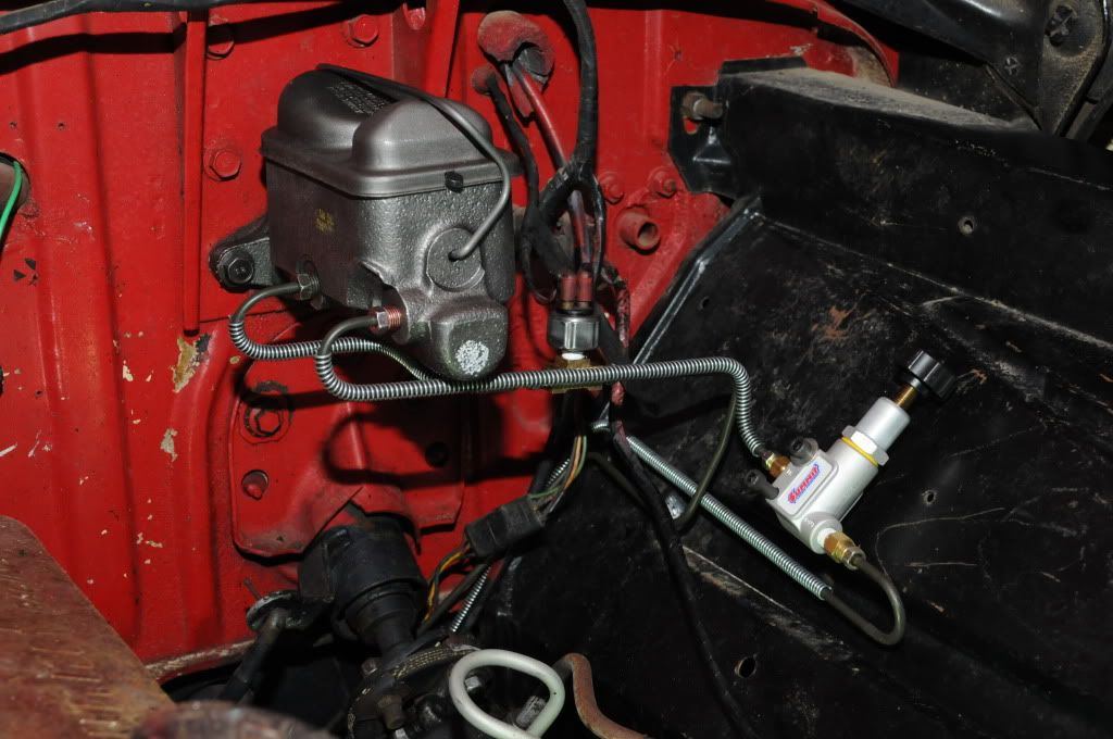

Originally Posted by CougarJohn
I am thinking about a pressure switch at the master cylinder. Anybody have any advice on theat?
For a more graceful installation, this would be one solution --'95 Ford Explorer MC with cruise control (NAPA p/n M3247). In this application, there was a pressure switch screwed into the 'rhino horn' at the forward end of the MC. It was to sense pressure when you stepped on the brakes to cancel the cruise control.
3/8"-24 inverted flare port.
https://www.napaonline.com/en/p/NMAM3247
However, this MC has a 1-1/16" bore diameter so, it would be best to have a dual diaphragm booster if using this MC.
There's also the option of using a Tee to connect a pressure switch into, as I did here on my friend's '65 F100, when discs were added to the front and I removed the single pot MC and installed and plumbed in a tandem MC.
I have already planned for the power brake upgrade, I have a donated MC and booster tucked away in my garage now. Going to wait until I have the front disc brakes kit/assembly. Still thinking of staying with the Ford parts
