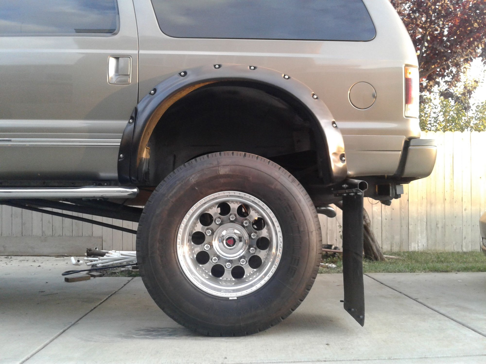

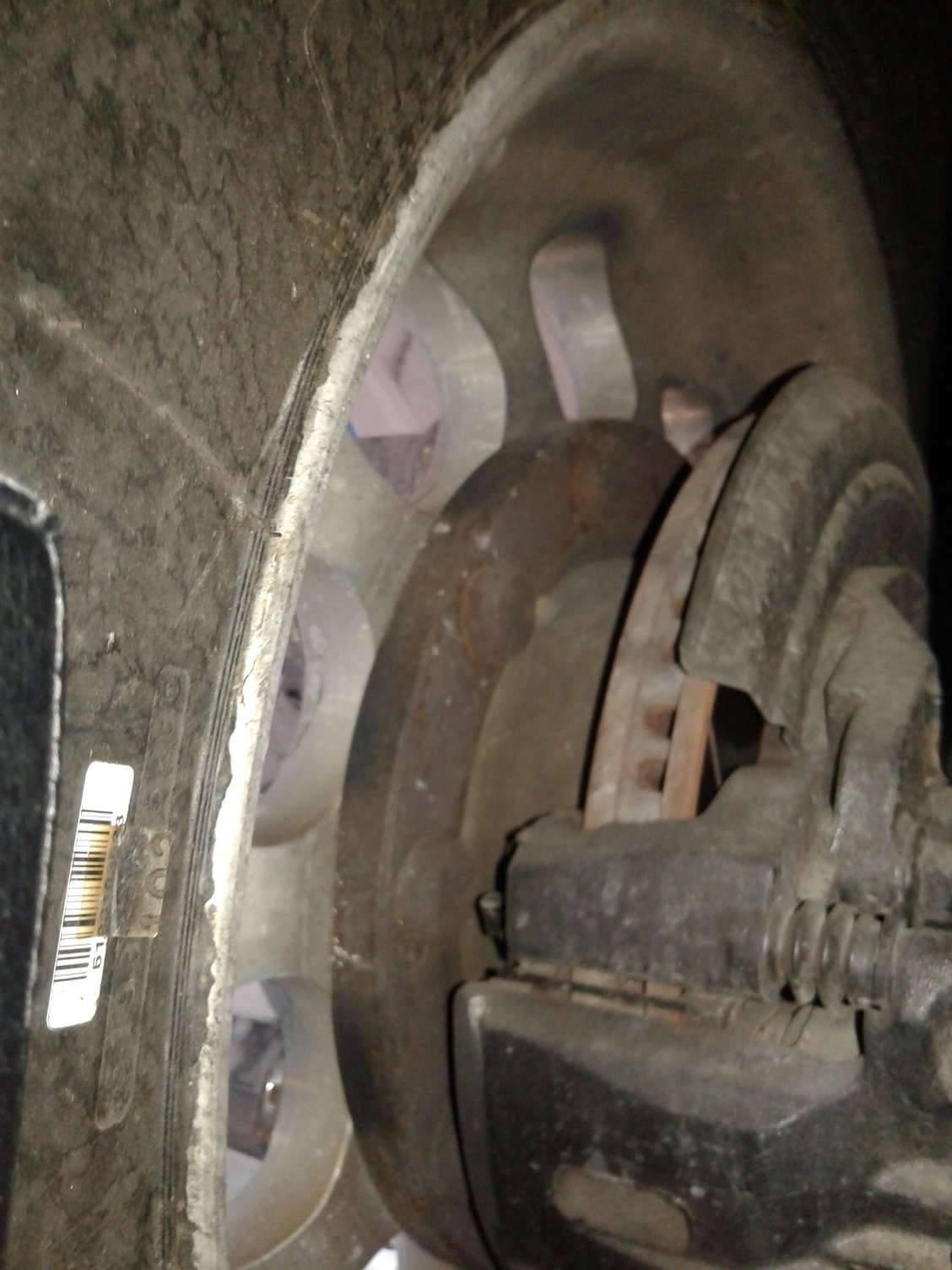

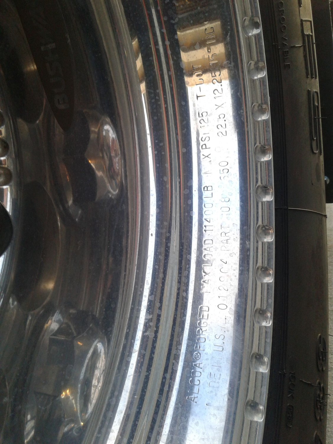

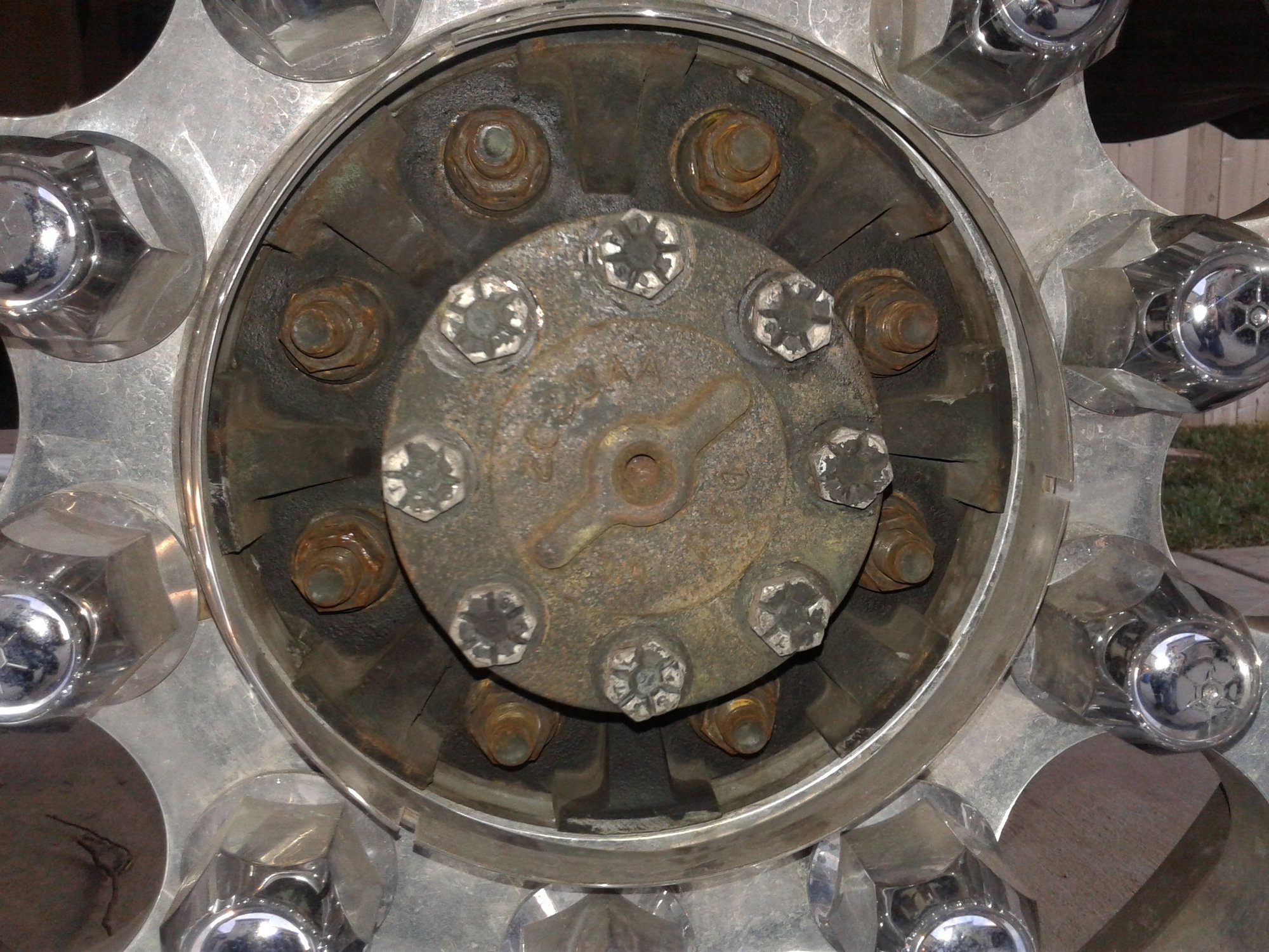

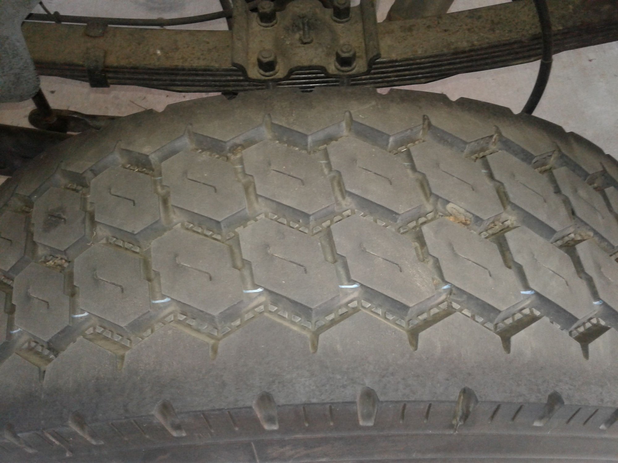

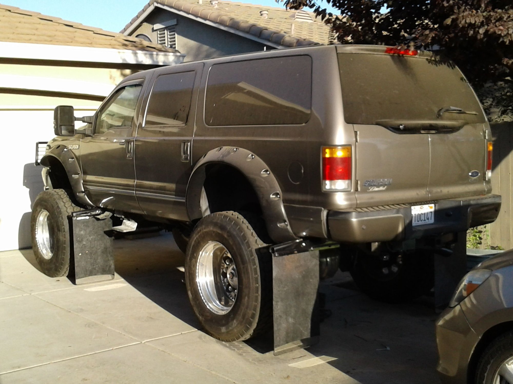

It appears this question has been posted in a few different places and is attracting a lot of comments. I'll provide the specifications on mine and answer any questions.
8x170 to 10 lug adapters
22.5x12.25 Alcoa's
385/65R22.5 Hercules
Tread is 11.75"
I can't remember the total weight but it's a real heavy tire and wheel package.
Still, I love the look. 10 luggin
