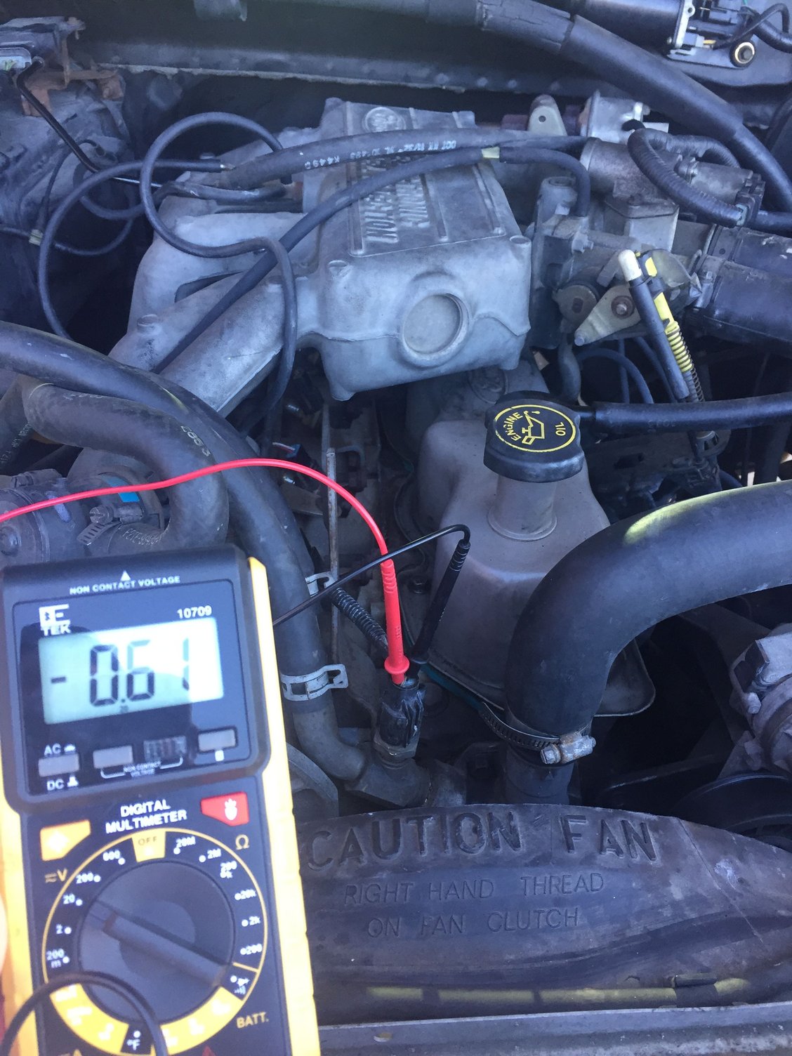

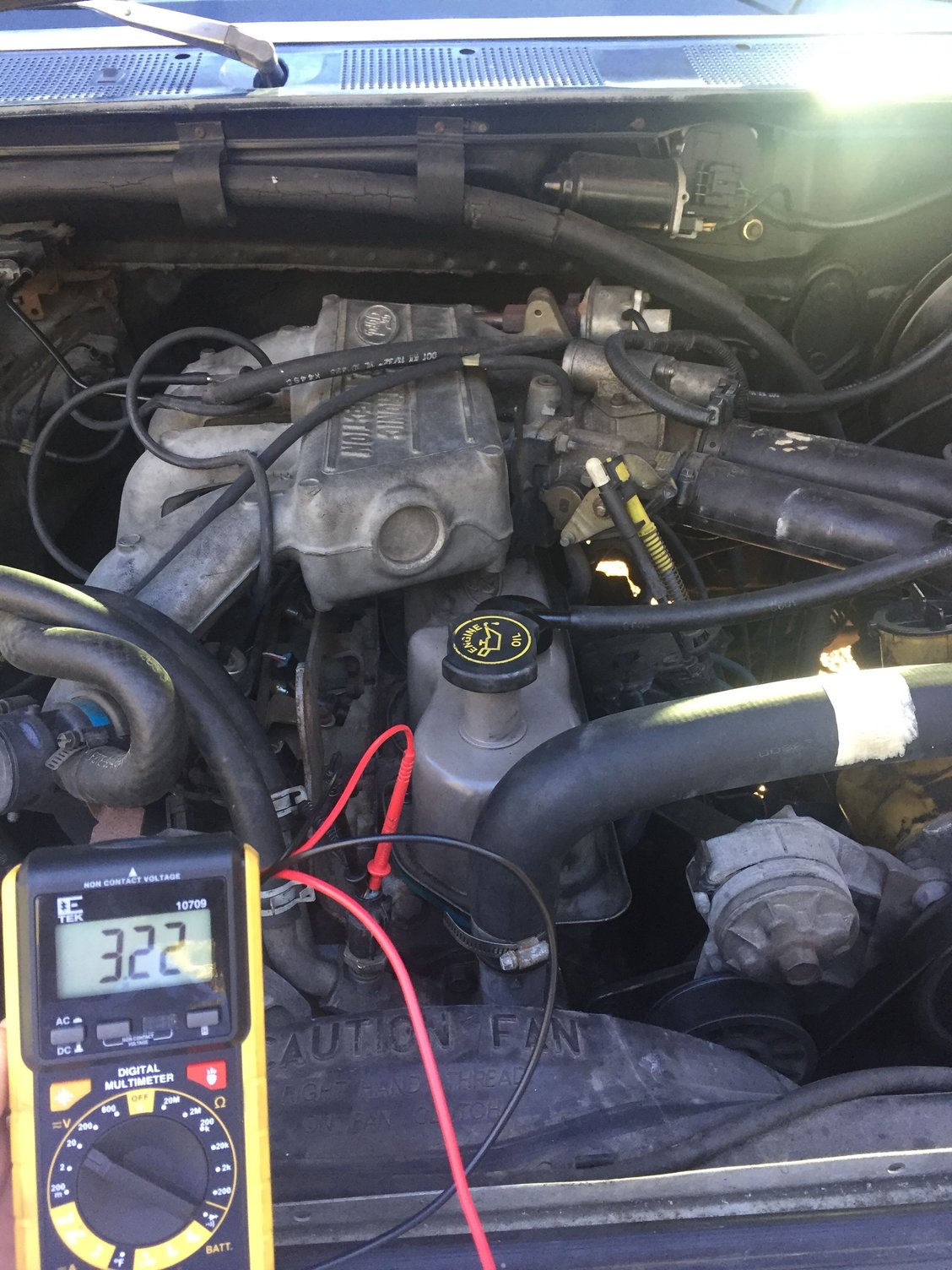

Got some readings from the ECT:
KOEO - Cold - Awesome 63 Degrees here in New Orleans
(wrong polarity) KOEO - After CEL came on.
Sensors are factory from what I can tell. According the oldfuelinjection chart, the values seem dead on:
3.22v = Somewhere just south of 68 degrees.
.61v = 194 coolant temp after running at 45MPH for a while. Good enough to get into open loop.
Also, I've replaced the fuel filter about a month ago. I updated the top post for all the newer tests I've done.
