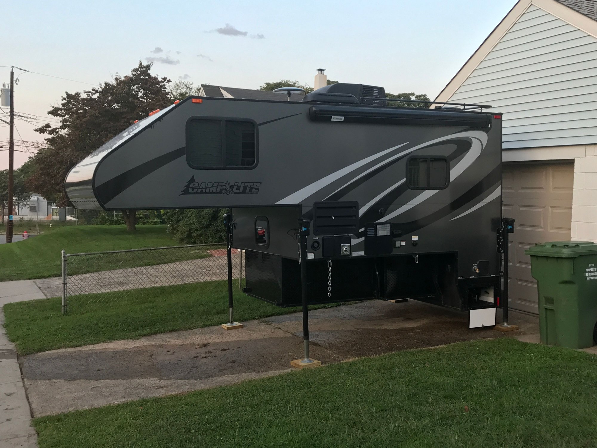

Well it might not be a Host Mammoth...but its decent enough for me...this thing has been sitting in my driveway for the last 7 weeks waiting for the my truck to be built...if a brand new F-350 SCSB SRW XL cant handle 3360lbs (actual scaled weight with all my crap in it) that's pretty sad...

Good for you to have scaled the camper and know what it truly weighs. Nice rig. Good luck with the truck when it arrives. At that camper weight, with a Super Cab XL, I think from my own TC experience with a SC XL (LB dually) you should be in the ballpark.

Sorry, i had meant to say decent weighted, as in large. While at the dealer this weekend guy came in with a 450 dually with a slide in. 3 slides. Things was amazing.
Thats what I had in my head.
Nice camper!

Oh jeez ... no offense taken at all...I'm just hoping that the truck I had built is going to work with this thing. 3 campers in 3 years and I hope we finally got it right ?
My wife loves to camp ...I don't at all ...I use the camper as lodging for events I go to (about 8 a year) with my antique truck. Plus about 4 camping trips a year to keep her happy.
I bought my first TC because the one event I go to rooms start at 189.00 a night (and those places are "traps") and 20 miles away from the venue.
Ill know when I get the truck in a couple more weeks if I made the right choices.
