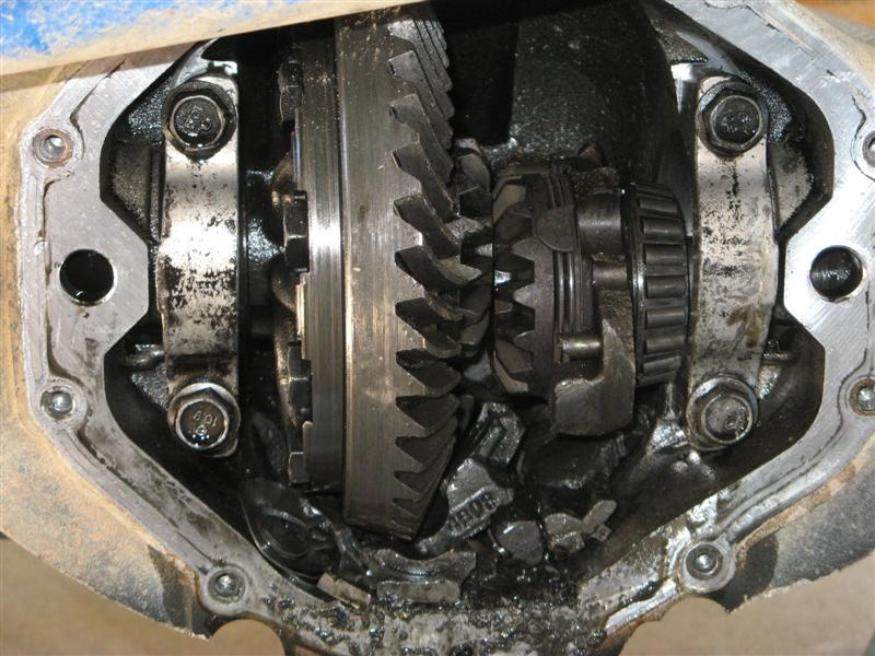

Since you said you would update the other thread, I thought I would just copy this here and reply so you have 1 thread going on.
Originally Posted by Im50fast
Setting gears is more complicated than the average (or skilled) backyard mechanic can do. And the risk is too high if it's incorrect (safety and wasted money). I recommend you don't do that yourself. There's a lot of trial and error and "feel" to get it correct. I've read articles and talked to experts in detail about setting rear end gears.
The crush sleeve is finicky but has to be correct. And you can't just reuse it with new bearings and expect it to be correct. You can reuse it with your exact same old parts but even then there's room for error. And just a little too much torque on the pinion nut will crush it beyond spec.
In the world of local racing there's always some excessively wrinkled 50-year old guy with a cigarette hanging off his dirty lips that does it for $150 cash. Also in the world of local racing the rear ends always last exactly 3/4 of the season and then break.
im leaning towards getting the $300 junkyard axle with 130,000 miles. It should get me through another 50-75,000 miles... I'll update the other thread about this.
Well i have not had good luck with shops around here. I took my GMC to a well established and reputable transmission shop that also rebuilt rear ends. My GMC had a bad bearing in the rear axle somewhere so the mechanic rebuilt it. When I picked it up there was a grinding noise from the rear axle as I was pulling out of his shop. He said, OH I know what it is and took it back in the bay and tightened the pinion yoke nut. Well back then I had changed out axle bearings and seals but knew little about differentials and so assumed he did what he needed to.
WEll about a month or so later the differential developed a roaring sound and when i took it back he told me that he had used axle saver bearings so I wouldn't need to buy anew axle. Apparently the axle shaft was too far gone and the axle had chewed up the new bearing, more expense..
Shortly after I traded the GMC for my Ford van.
Now, though I am not a pro, but do know much more about differentials, I know you don't just tighten a pinion nut and send the car dawn the road. I know you have to set the pinion depth and then pinion bearing preload. Once that is done you do not remove the pinion nut again!. So then why was it loose to start with?
SO my thoughts are if I am going to pay good money to get crappy work, the I will learn how to do it myself. That is part of the reason why I mentioned in another thread about swapping the 9" out of my 85 into my 88. On the 9" one can buy a complete third member already set up and swap it yourself for about a third the price a shop charges to rebuild one. On the 9" you just pull the axles and the differential just unbolts from the housing all in one complete unit. I already did that once on my 85 to clean out the axle housing while changing the axle bearing and seals.
I understand your concern about setting the differential up correctly and at one point I would have been more confidant rebuilding an engine then a differential but I have been thinking about this for over year now and researching, reading, and watching videos off and on till I am just about ready to give it a shot myself. As my father was also a machinist and taught me a good bit as he always made any parts we needed to fix something, I have all the micks and gauges needed to set one up and know how to use them. It doesn't seem so intimidating any more.
This is an example of a bad axle bearing race from my 9" axle
Here is the housing after I cleaned it up inside and ready to reinstall the differential
So I am not afraid to jump in there and do it in the future... I know there is a big difference in cleaning parts and setting up a differential
