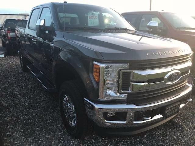

Old Oct 15, 2017 | 09:00 PM
lcgeek's Avatar
lcgeek
Joined: Sep 2014
Posts: 130
Likes: 10
Pics
Here she sits...so far away
