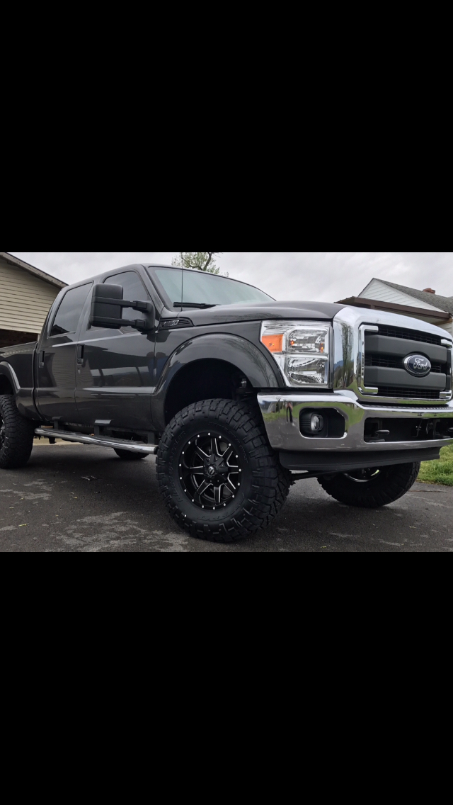

I went with the readylift 3.5" spacer kit that comes with a drop trac bar bracket and 3" larger factory style rear lift blocks. I have 0 complaints. I am using the provided shock extensions, but plan on upgrading to full length bilsteins in the near future. The snow prep springs will lift your front 1-2", but will also result in a much harsher empty ride.
