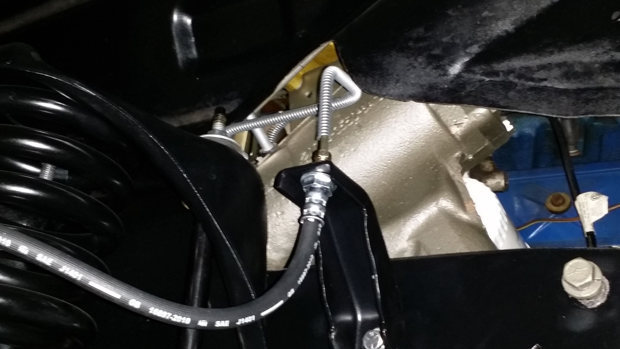

If you're using disc brake/suspension donor parts on a '65/'66 F100, from a Dentside, you would need the discs/suspension from a '73-'79 F100 or from a '75-'79 F150.
You would also need the disc/drum brake valve from the donor and the frame brackets on each side where the hard brake lines connect to the flexible caliper hoses.
'77 F100 donor disc brake/front suspension I installed on my '69 F100.
Hard line-to-flexible brake line bracket you would need (for both sides).

Thank you for shearing, Did you bend the hard limes or did they come like that? Nice job, I hope mine looks hat nice, when I am done.

Originally Posted by Rust Smith
Thank you for sharing, Did you bend the hard lines or did they come like that? Nice job, I hope mine looks that nice, when I am done.
Thanks. I bend/flare all my own brake, fuel and transmission hard lines.
