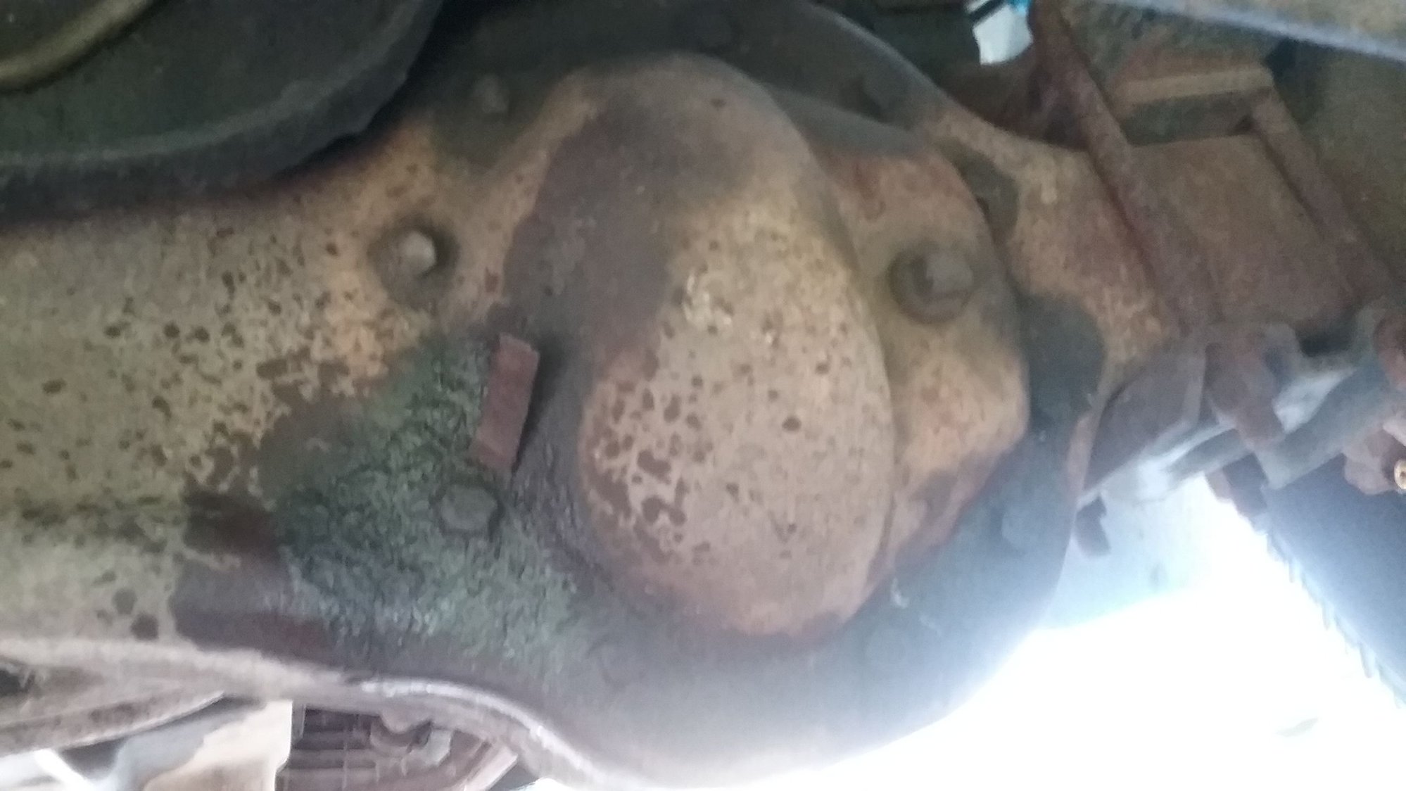

I'm having trouble identifying the front differential on my 95 Ford F-250, I think it's a DANA 44 INF but with all other different front end configuration I would like to be sure.

clean and read the tag.
another way to tell is by the locking hub. if it is slightly smaller than the axle flange it is mounted to, it is a D-44.
if the locking hub is the same size as the mounting flange, it is a D-50
