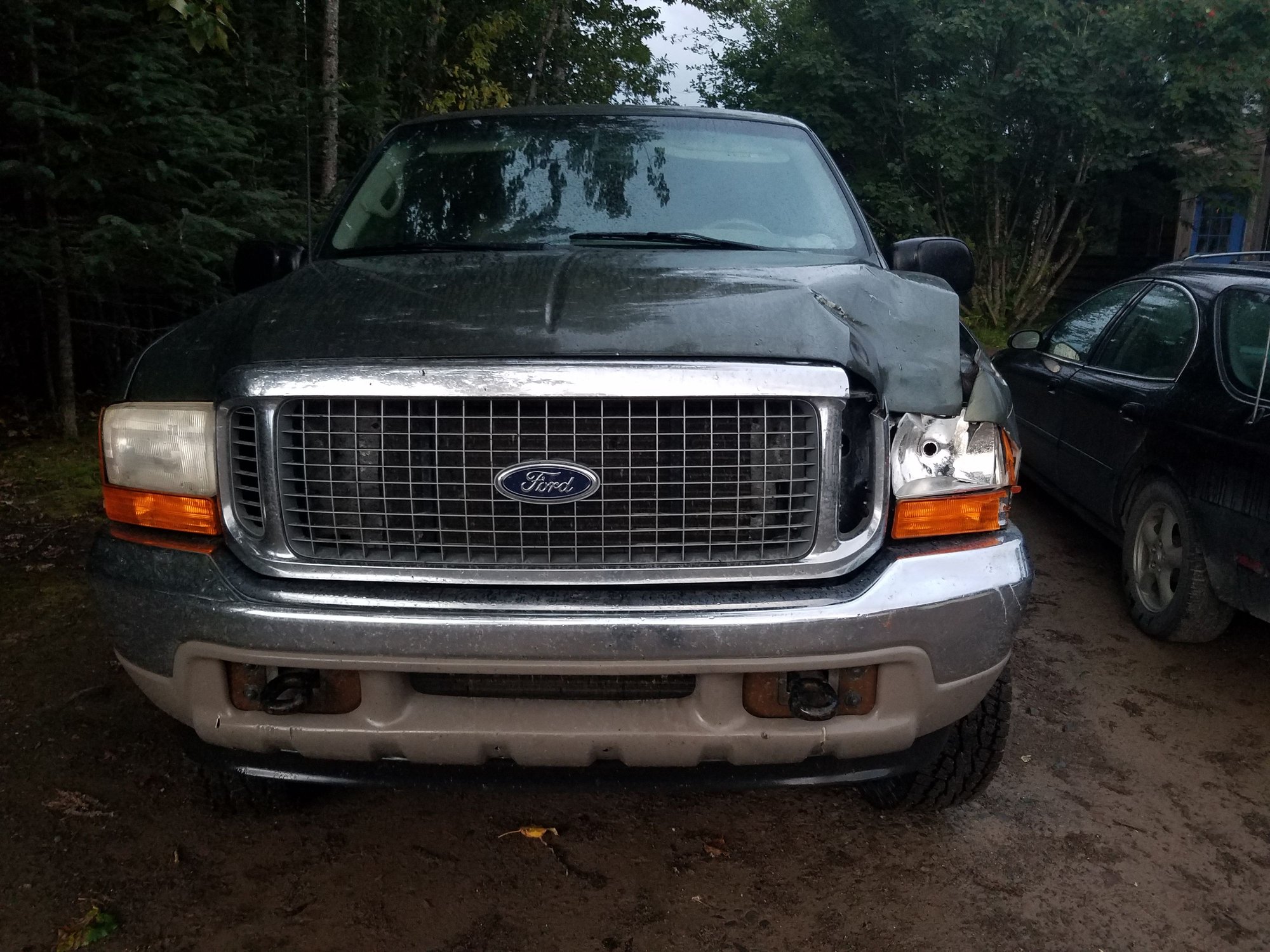

So last winter, I spent about 6 weeks in a sub zero garage rebuilding the top half of my 2000 Excursion gas V10. I straight piped the exhaust, replaced most of the brake system and put on new rims and tires.

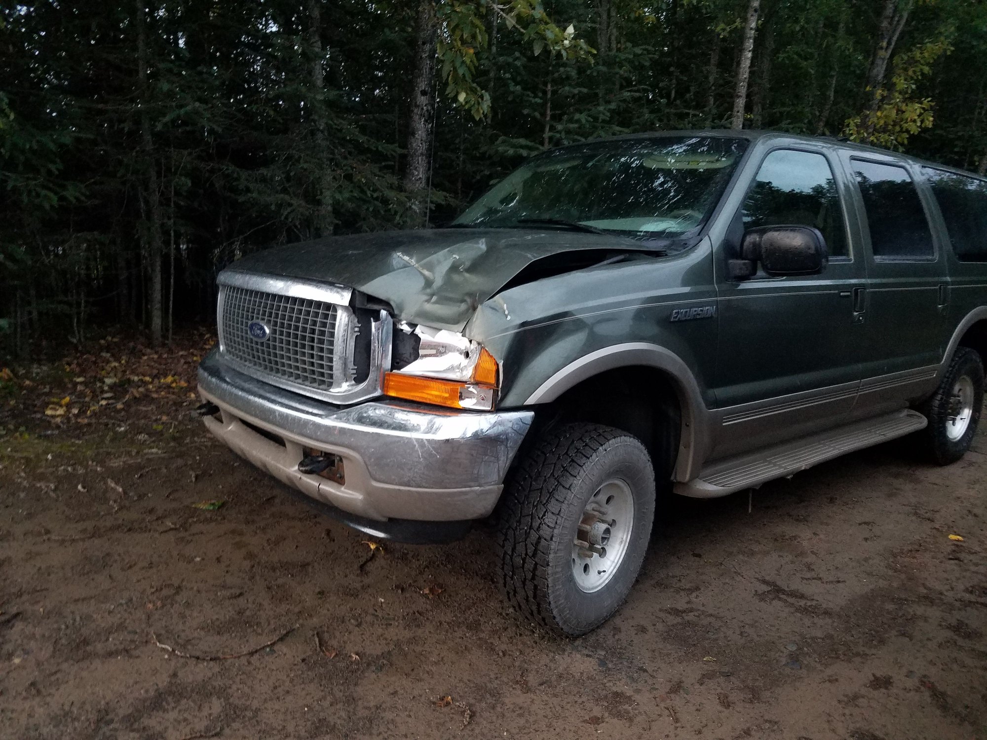

So with all that money spent, what happened last month really hurt. I tagged a moose at about 30 mph. The truck took it quite well and because I was moving the same day of the accident, it was a good two weeks before I could get it to the repair shop. Fortunately, the insurance covered the $4000 repair.
Moose collisions are a regular occurrence here in Alaska, and I've been blessed to have gone 7 years without hitting one. The fact that the truck is paid off and reliable and the fact that my family fills it up completely (with the additional 4 row) makes this truck invaluable. I refuse to go back to a van.

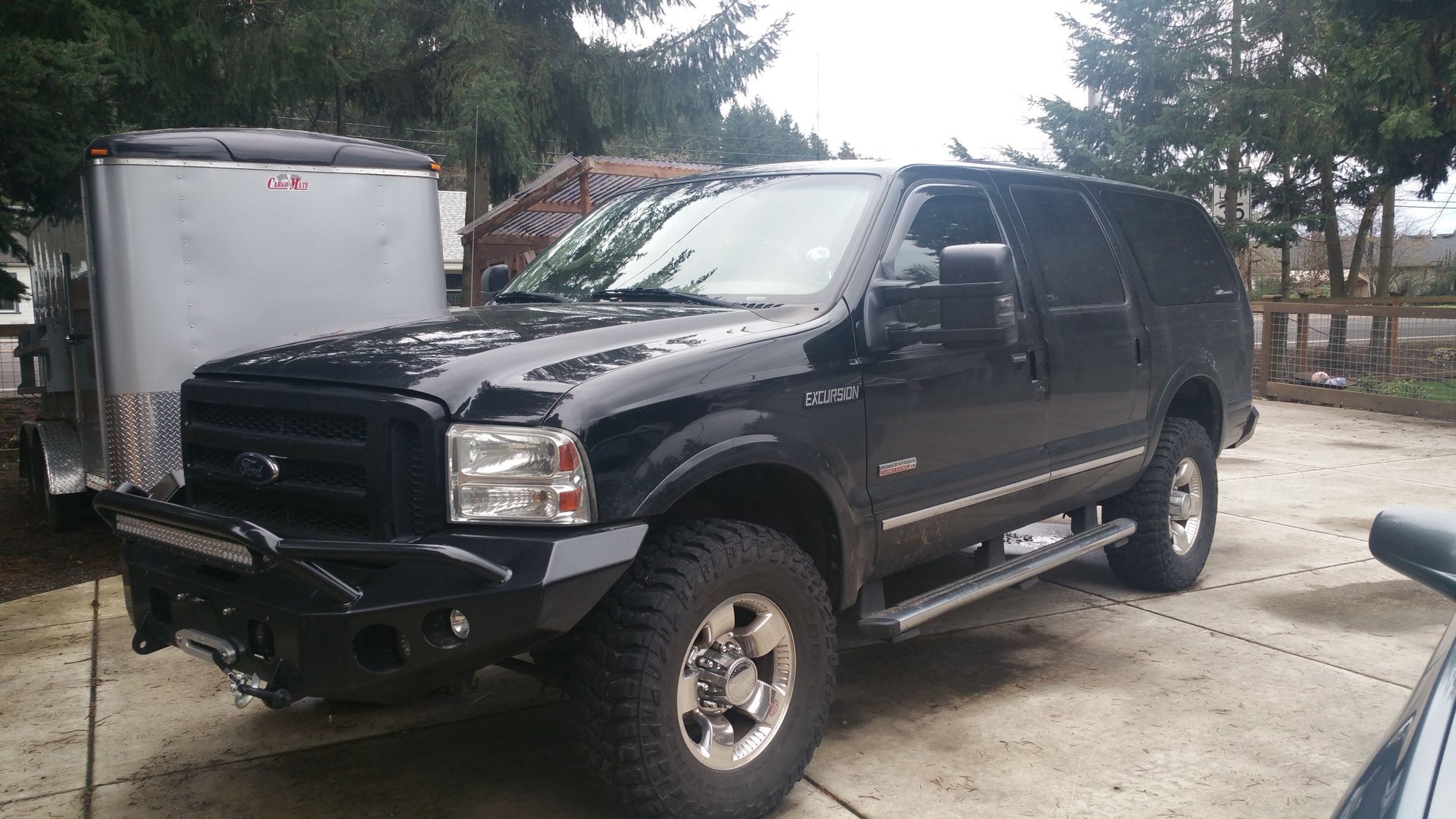

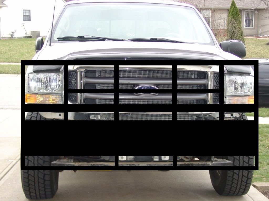

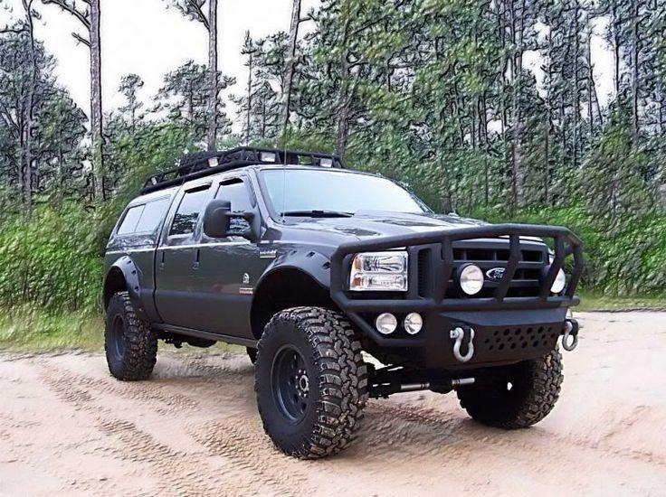

Because of this I want to make sure any future moose collisions are damage free. I am going to build a bumper that will take an impact. Granted I have no way of knowing how well it will work, but I think my plans will. I have attached some pictures of my damaged truck and two pictures (altered with the paint program for a visual prospective) with the rough idea of my plans. Just to put everything in prospective, the beam at bumper level will either be a 6x6 or 8x8 square tubing (1/4"thick) and all the other beams will be 3x3x 1/4" thick. The gussets will be upwards of 1/2".

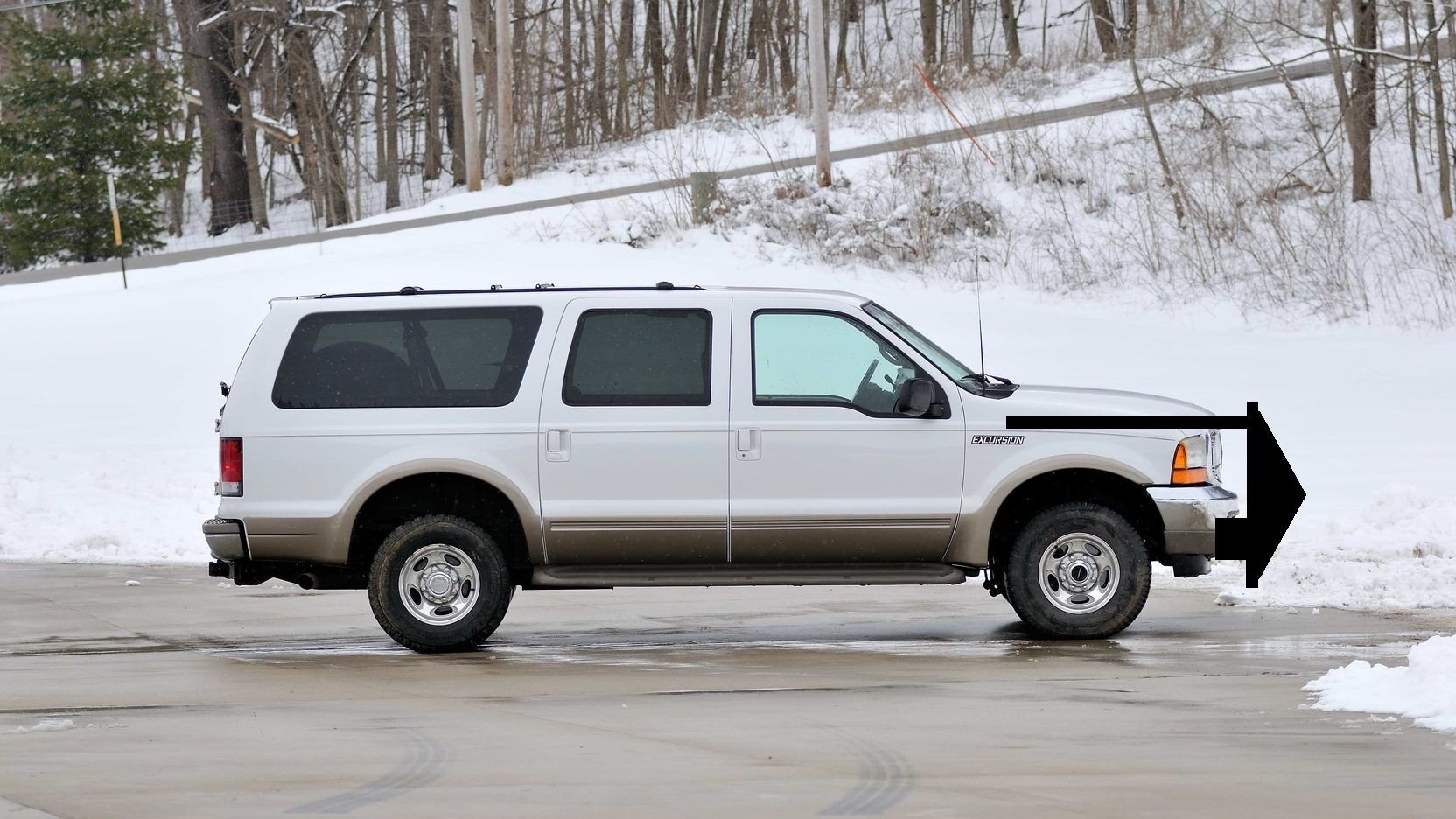

As the photo of the white excursion depicts, I want to run a brace somewhere down the side. Since my truck is still in the shop and I can't look at it right now. I'm trying to determine if there are any solid areas to bolt / weld the brace to. The overall bumper may be strong enough without this brace, but I would rather it be too overbuilt rather than under built.

curious how that is $4k in damages? using OEM take-offs, I can see about $1k max

Used hood, new quarter panel, new light assembly / HID replacement, front bumper(was dented) supports behind the light assembly, grill, paint job and not to forget everything is more expensive in Alaska.

If you're gonna be the one making this, get rid of that ridiculous, stupid brace at the top. It's useless based on what you're wanting. Just brace the vertical extension properly and you'll have better results.

I like this one:
Just add some spikes along the top to "catch" those pesky little moose as they try to roll their long-legged bodies over the top, and you are golden!
http://www.pinterest.com/aluminess/f...-road-bumpers/

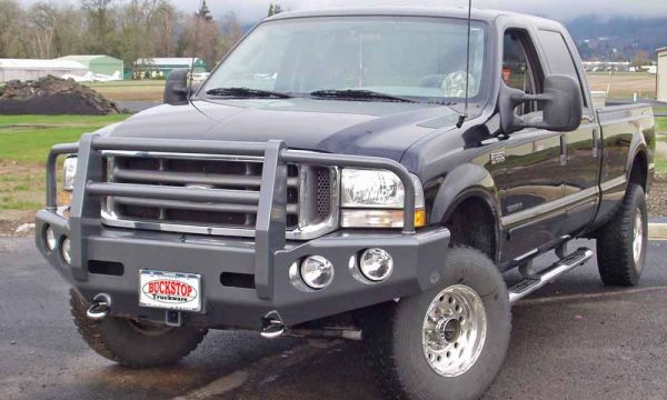

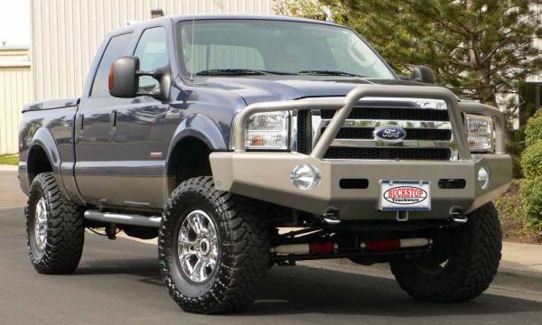

It sounds like you are pretty set on building your own, but for another aftermarket option would be Buckstop in case you change your mind.
