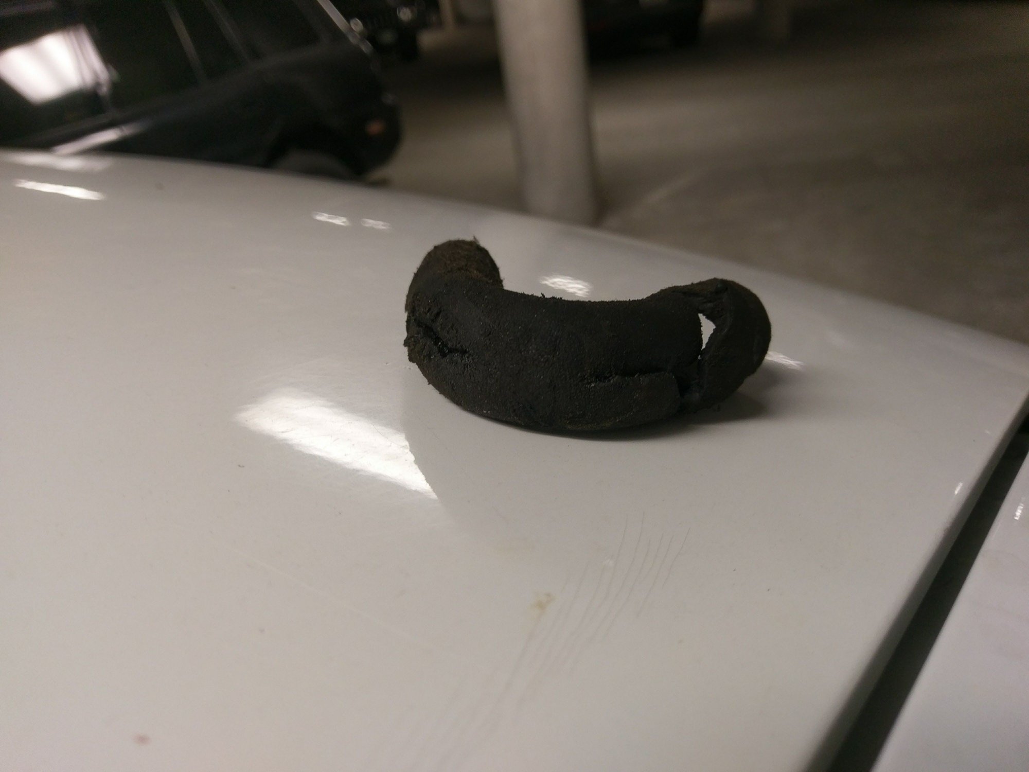

I tore into it a bit more tonight, and I have this PCV hose problem. I was able to locate the tear in the hose. Need to get a new one now.

I wonder what damaged it? Usually they die of brittleness.

I think it fell apart when I moved the other end of the PCV hose, while doing the spark plugs. This is what it looks like after I got it off. I had to use needle nose pliers to grab it, it didn't want to come off. So the hole is probably from me using the pliers, the rest is it falling apart. I highly recommend taking the throttle cable bracket off first to make your life easier. I couldn't get the new hose back in, until I unbolted that bracket.

Nice find on that vacuum elbow...

I believe those PCV elbows are a common issue. When I first got my 99 V10 a few years ago, it had that same cracked hose.
