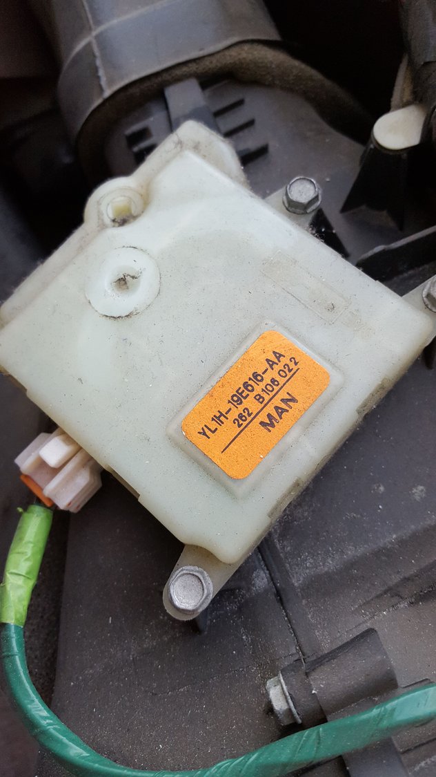

make sure the front is on or on rear a.c.. then make sure the blend doors for them aren't stuck in one position. the blend door motors go out. my was stuck on heat. so I swapped the motors to allow to change to a.c.. it just comes out of the roof for now but I can change the temp for the kids if i remember correctly the green is the heating and cooling and tbe red is the floor or panel.
this is one of mine and the part number for it.
