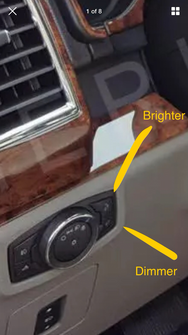

Originally Posted by boulderbronco
This is really bugging me. I've had my 2017 F350 Lariat (value package) for two weeks and can not figure out these lights. They go on when you open the door and start the truck. But then they go off and I can't get them to go back on. They do go on at night but not during the day, even when I turn the light **** to on. By the way, it's those headlight control lights as well that aren't lighting up. The controls on the door are lit up. Even on a dark rainy day like today, no lights. This can't be right. Shouldn't these lights come on whenever I turn on the park or headlights just like all vehcles use to?
Have you tried manually adjusting it here (picture attached).

Originally Posted by ZAR2USA
Attachment 245548
Yes. It sounds like it's a beyond stupid "feature" that Fords brilliant engineers thought of. It's absolutely awful and I'm actually fuming about it. It's a very cloudy/dark day today and I can't turn on the lights. This is insane! I can barely see the switch icons on the various buttons. I'm so pissed about this I am considering taking the truck back.
