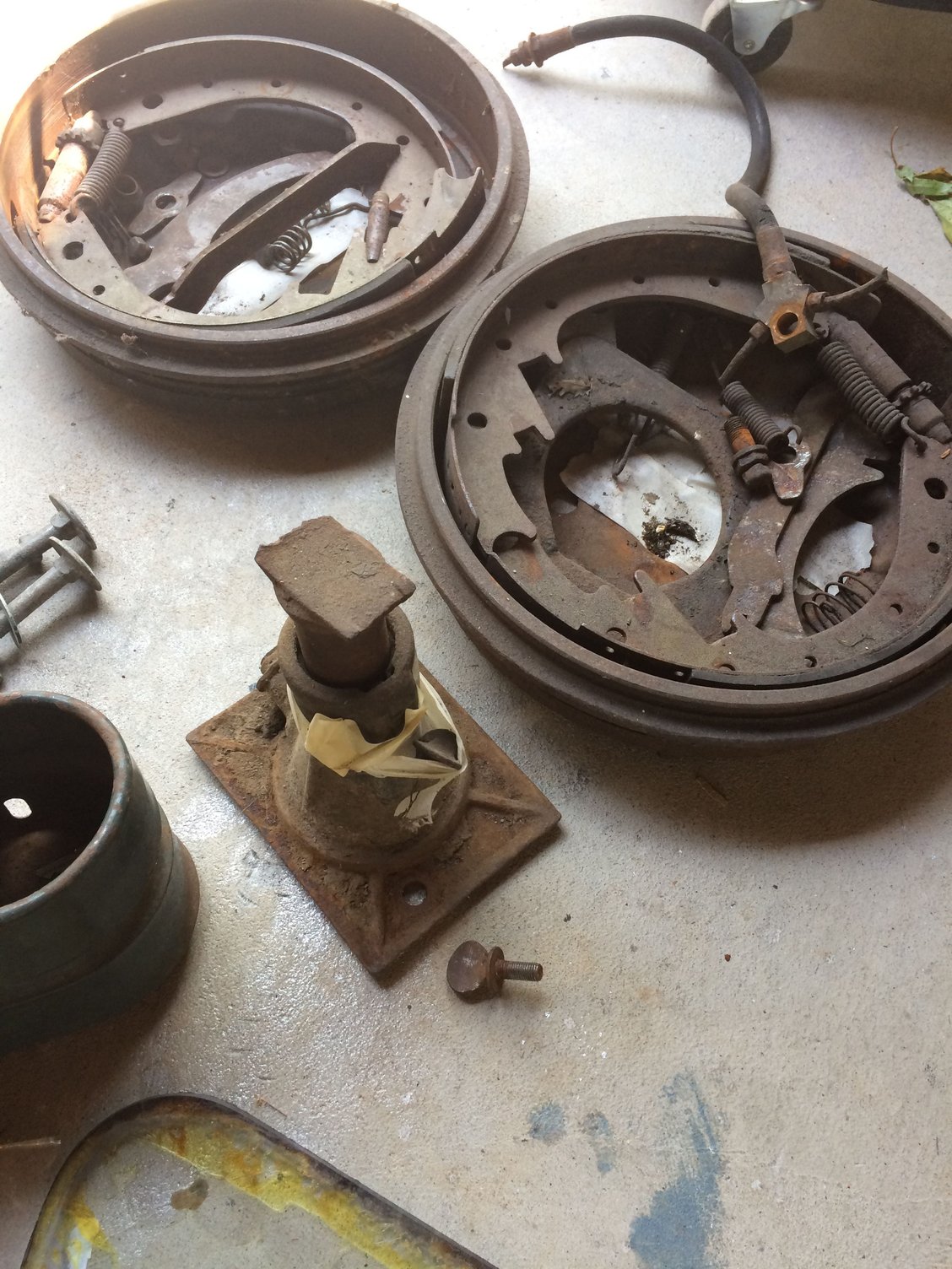

Does anyone know where I can buy a replacement for the ebrake lever in the rear drum.
Im missing the lever, pin and retaining clip on the drivers side.
Thanx.

I must be missing something. The picture looks like it IS the drivers side

Originally Posted by bjmayberry2
Go to the junk yard. Any Ford 1/2 ton with the same drum size will work.
C1SS-2A637-A Right & C1SS-2A638-A Left .. Parking Brake Operating Levers / Obsolete
1948/52 F1; 1953/63 F100; 1961/62 Thunderbird.
MUSTANG'S ETC. in Van Nuys CA has the right side (818-787-7634), no one has the left.
