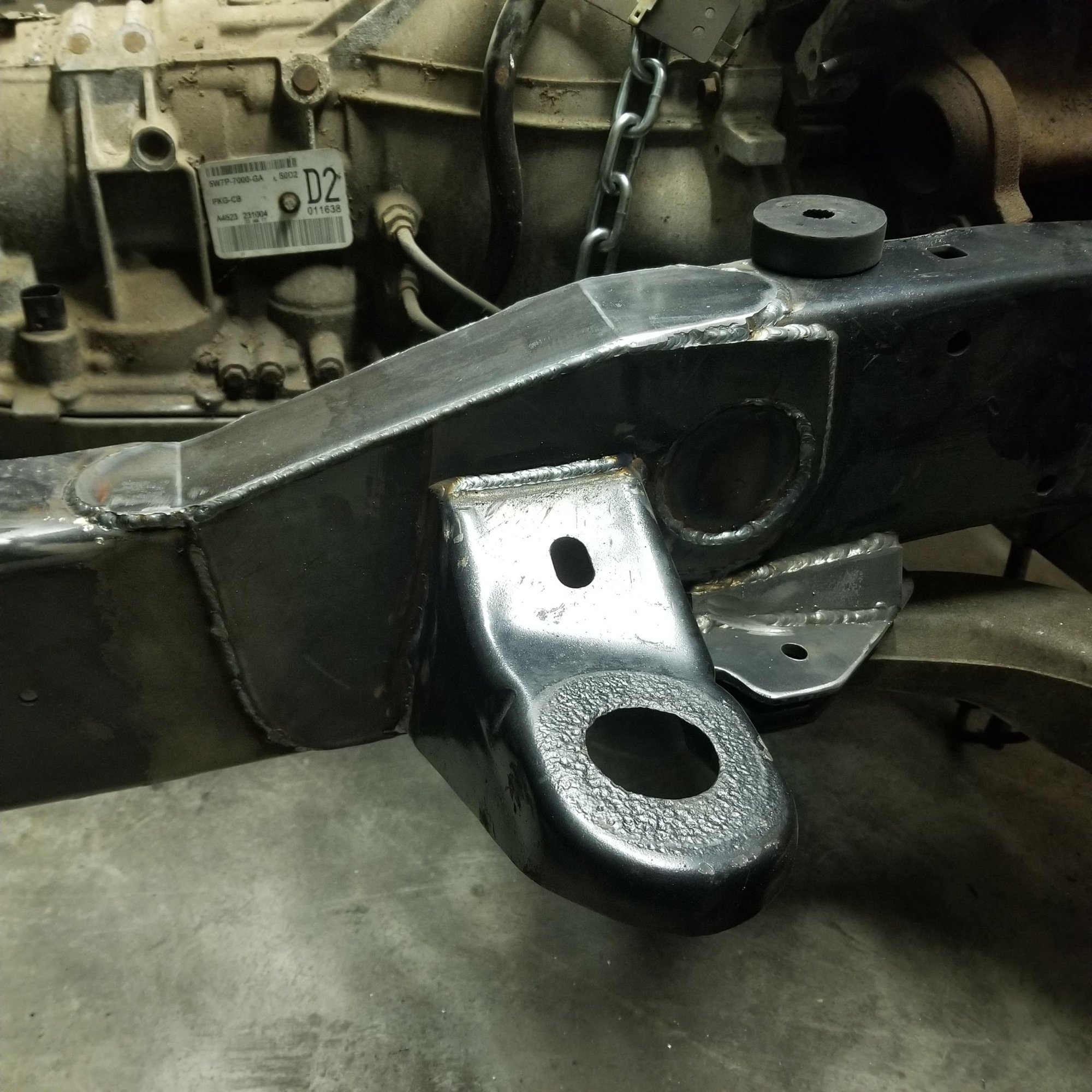

Loving it. I have an FE c6 in my '75 Super cab sitting at my dad's in northern Wyoming. Don't know if you are still driving with the leaking c6 but I have no plans to use mine.
I have not seen frame notches like that before, who makes those?
I pulled the c6 and had the case welded until I decide on a permanent drivetrain for the truck.
The notches are from art morrison. They are 2x4 mendrel bent, "the hard way" is what they call them.

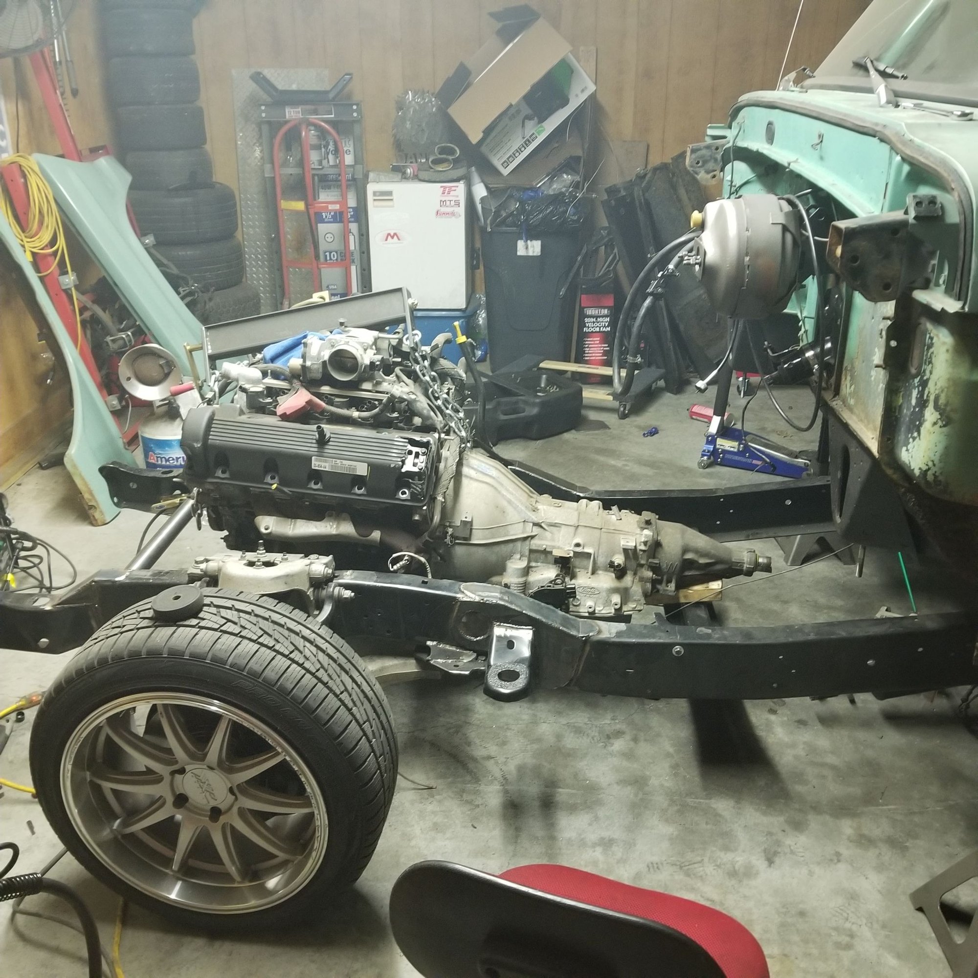

Based on that last picture you used a chain to pull the 4.6, like I did....and smashed the valve cover as well, like I did. Very nice work to slam it.
Not exactly. I picked this up from a wreck and the valve cover made contact with the brake booster in the 05 grand marquis it was in.
thanks for the compliment!

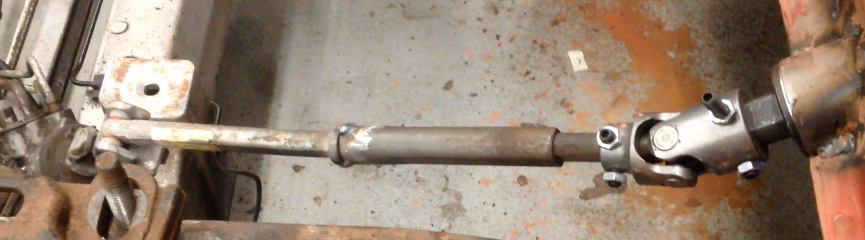

I was going through all of the photos in your thread just to review. I noticed with your steering shaft you have a straight run, nothing to collapse in the event of a front end hit. I've attached a picture of mine, I used the CV joints at the bottom and a GM Suburban intermediate shaft. In the pic it's just tack till final fitting but together it allows about 3-4 inches of collapse. I know it would be a PITA to change but consider the safety factor.
Enjoying your build, Pat
Thanks Pat!
I've seen other builds where people used a collapsible shaft that can be picked up from summit. I think I am going to go with one of those when it goes back together. I wasn't aware those were an option the first time I threw the truck back together. This time, I'm going back and building what I wanted to the first time.

The pictures of the frame mod are they to get the truck lower? If so how much lower did you go? I'm thinking about just notching the frame to make sit down over the CV frontend and adding to the top of the frame. Your build is awesome! Keep up the great work! I just got my front end all cut apart yesterday.
Thanks man! Yes, the whole idea was to get the vic front end recessed in the frame 2 more inches. I have seen where people did 3, even 4", but you would start getting into the cab mounts if you went over 2" based on how far back you would have to cut to clear the lower control arm trailing arm mount. 2" was just perfect for avoiding the cab mounts, as well as not getting into the floor to clear the trans on the 4.6. If you are running anything other than a 4.6, you may want to consider how much floor would need to be cut to clear the trans. I know my 360/c6 sat farther back, and would not have allowed this cut without also cutting the floor.

Originally Posted by danman223
Thanks Pat!
The Summit steering shafts look pretty good. I'm going to have to consider replacing mine sometime in the future. Thanks for the info...
