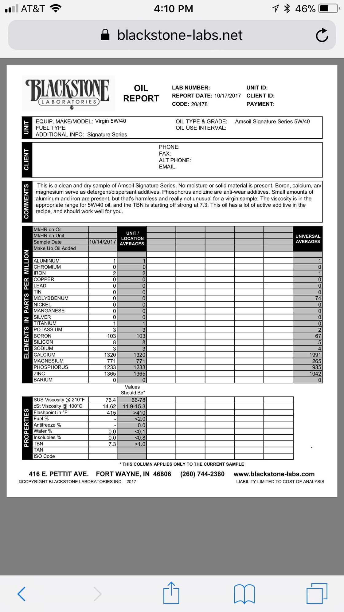

Hi Guys...I posted this over on the 6.7 forum page but I know many of us don't go over there as often as here.
Just got back the virgin oil analysis on the AMSOIL Max Duty Synthetic 5w40 I sent in a few days ago.
The new Ford spec main difference has to do with Phosphorus. Oils with less than 1,000 PPM they were seeing accelerated valve train wear. Likely if your CK-4 oil had more than 1,000 PPM then you got approved to the new standard...WSSM2C171-F1.
Looks like this AMSOIL comes in with a score of 1,233. Much higher than what is required by the new F1 standard.
So while this oil is not on Fords approved list it seems to check all the correct boxes.
I may eat my words...but when I get the oil analysis of this exact oil I will post that...Fingers crossed this oil performs.
Someone should send it a virgin sample of T6 to Blackstone to see what those results are. Or Schaeffer for that matter. Could be interesting!
Here is an article with details on the new F1 standard.
https://noln.net/2017/06/30/new-dies...ords-reaction/
