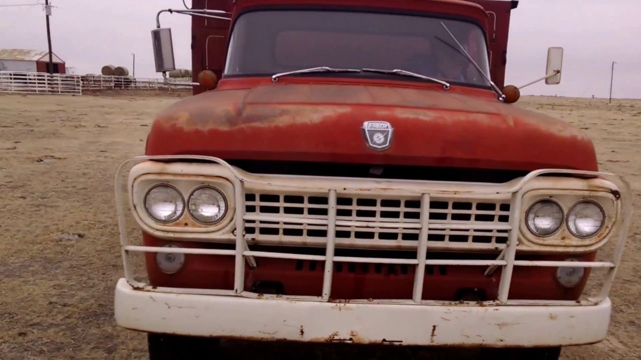

Original ford grille guards
Does anyone have one of them on their truck? I would like to look at how the braces to the frame are made. Better yet, does anyone have a pair of extra braces?
I will be installing this factory grille guard on the 1960.
Thanks for any help.

at work now, will get close up pics tomorrow
Old Sep 18, 2017 | 12:22 PM
78_f800crewcab4x4's Avatar
78_f800crewcab4x4
Joined: Jan 2008
Posts: 2,219
Likes: 190
From: Colorado Springs
Awesome thank you!
That is an awesome looking front end by the way.
I wonder if the braces are a U-shape channel, possibly the same stock as the cross-bars are made from, or maybe just round tube.

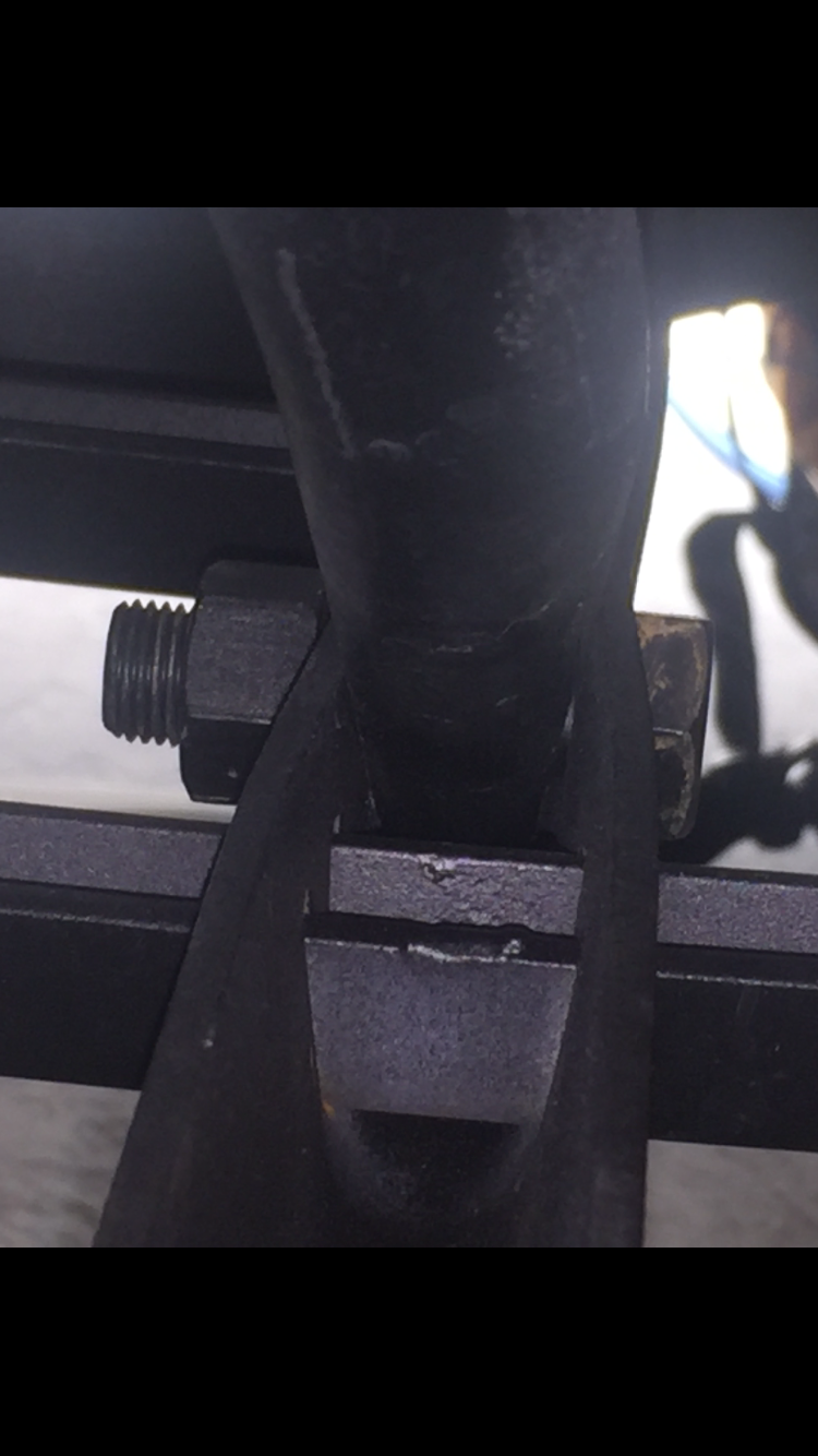

Solid steel bar bolted to front arm of frame on bottom and bolted thru back of brushguard. If I remember the brace weighs just over 4 lbs
View under from frame
Back side of brush guatd

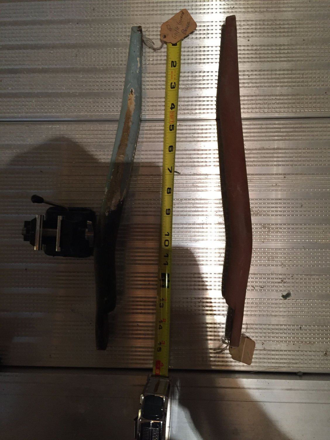

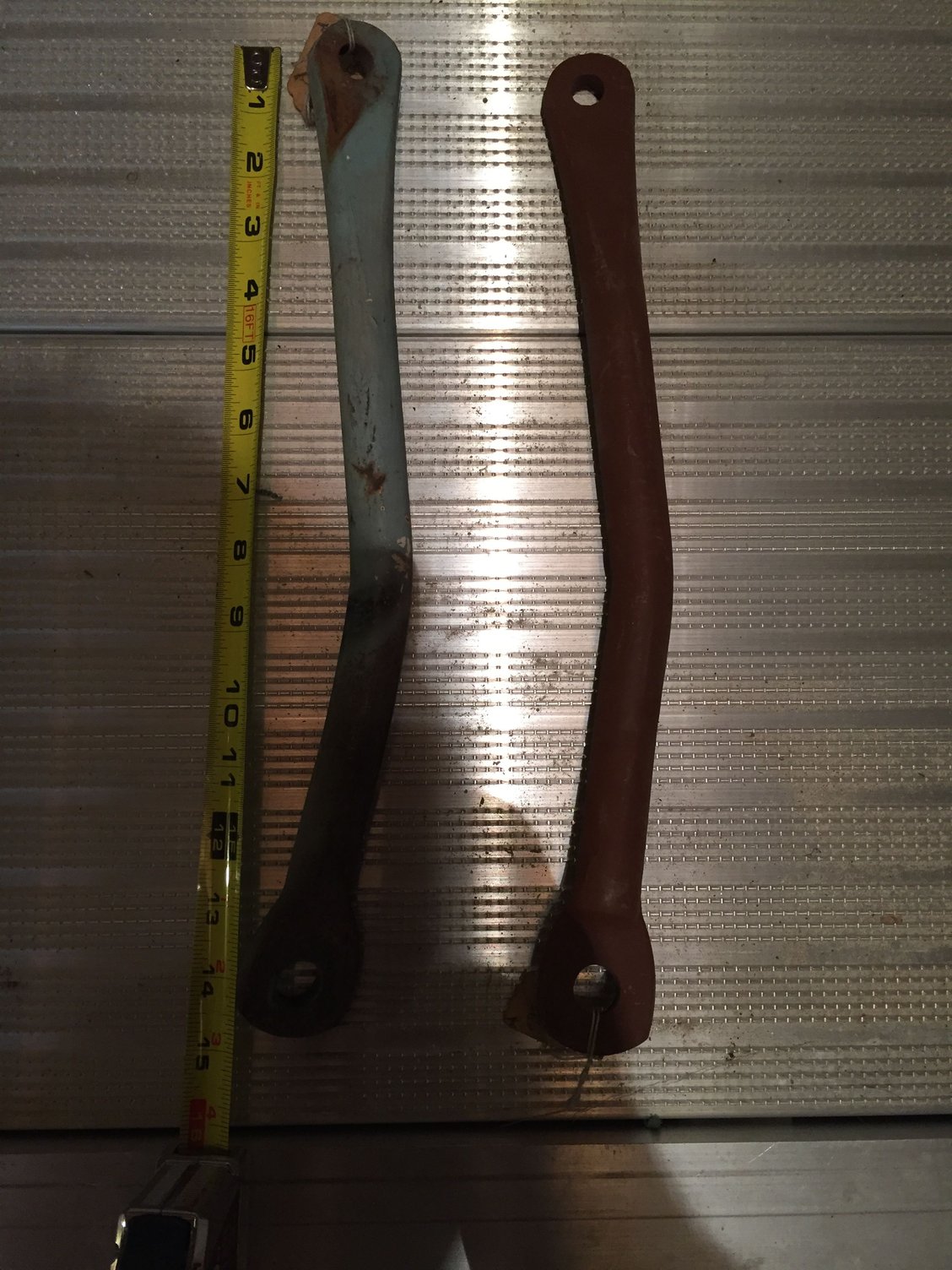

Found a set of braces with a 1953 part number. Most likely are the same units used on the bigger trucks thru at least 1960. Bolt right to the top of frame rail.
Old Sep 28, 2017 | 01:36 PM
78_f800crewcab4x4
Joined: Jan 2008
Posts: 2,219
Likes: 190
Just reference photos:

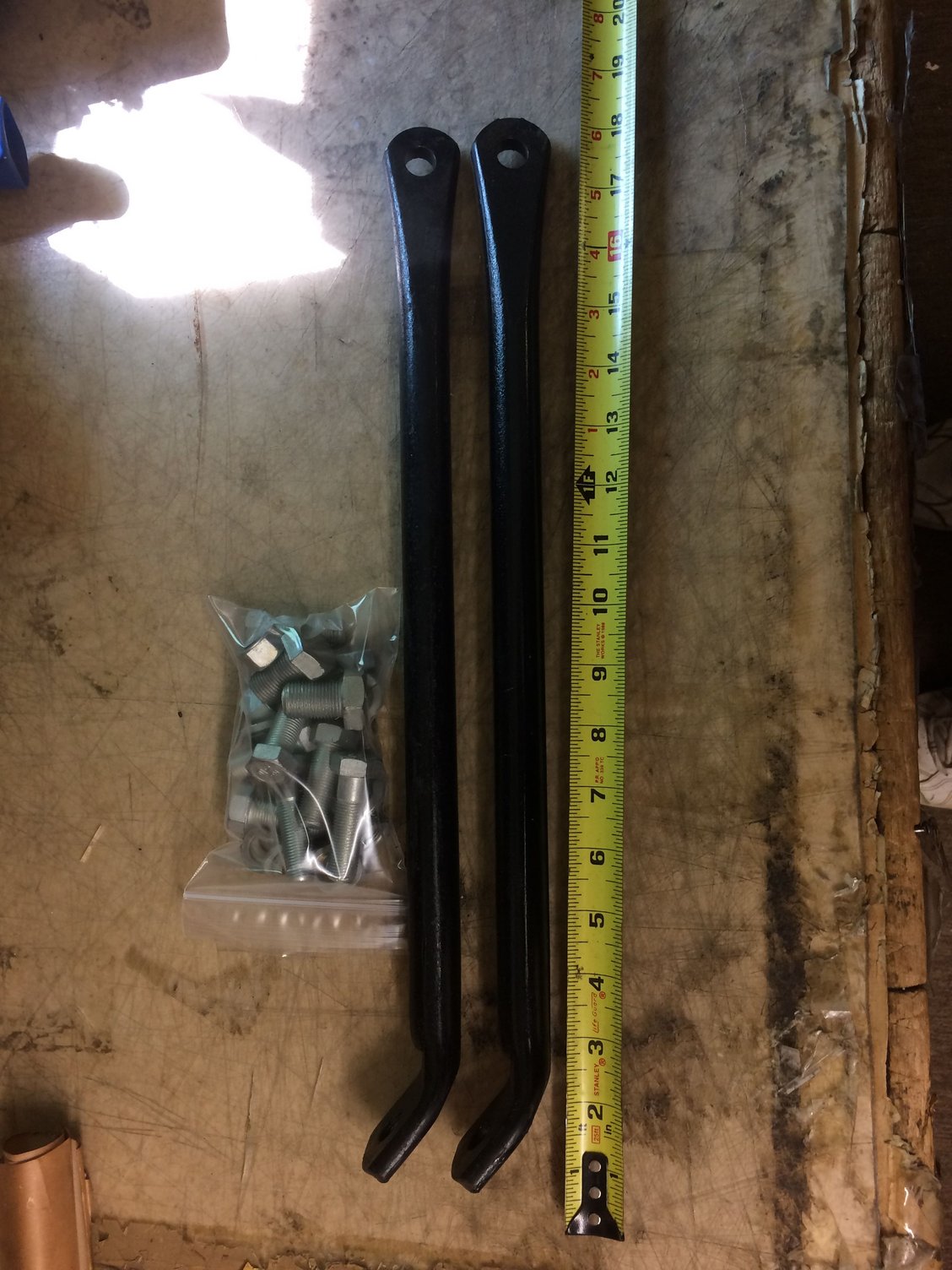

Here are some pictures of the braces for my '58.
Lou Manglass

Thanks for the reference photos.
