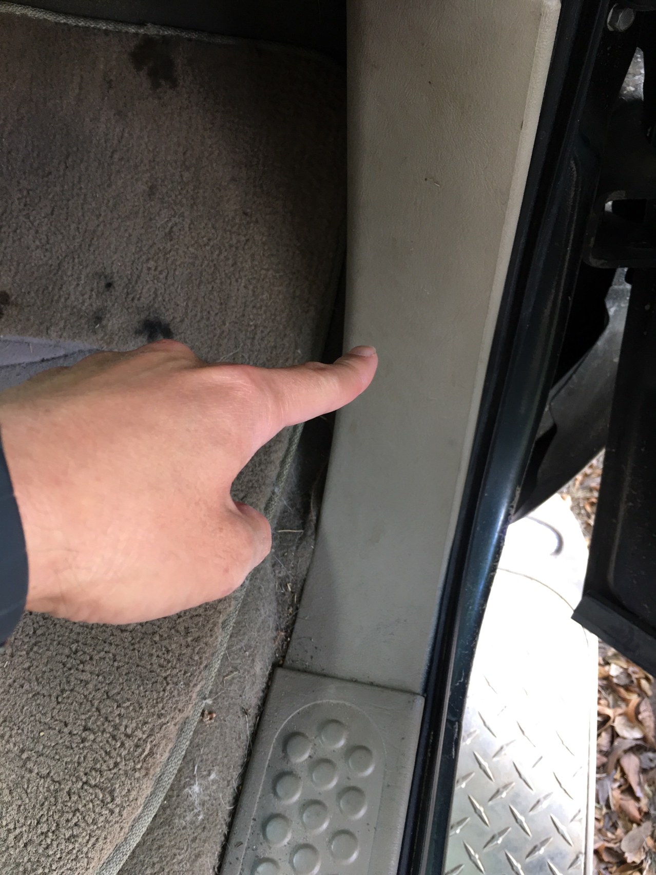

Hello does anyone have photos showing where the speaker back up location is for 2006 F3 50? I know it's somewhere under or behind the passenger glove box but I have not been able to find it

It's not where u think it is. It's under the side kick panel below the passenger glove box. I'll grab a pic for u in a bit.Name:  photo303.jpg

It's not where u think it is. It's under the side kick panel below the passenger glove box. I'll grab a pic for u in a bit.Attachment 244817
thanks!! Worth a 1,000 words.

DOM!
I see some sand in your truck I hope all stayed dry.
I know that the PAM is over under that panel but I did not recall seeing the speaker. PAM = Parking Assist Module.
I'll remove the cover and check it out. It was my brother's truck and he drove it like a mad man so there's no telling what it's been thru.

I just checked and both the PAM and the speaker are in the passenger side kick panel.
Photo and video! May this help the next guy!

i looked in there twice and it was not there, UNTIL I SAW YOUR GREAT MINI DRONE FOOTAGE, NOW I SEE IT, AND IT IS IN FACT THERE, 2004 F350 4 DOOR DUALLY

I had to make an account just to thank you for this video. Yours is the best post on the internet today! I've been searching for that darn speaker for a while. All fixed now! Thank you!
