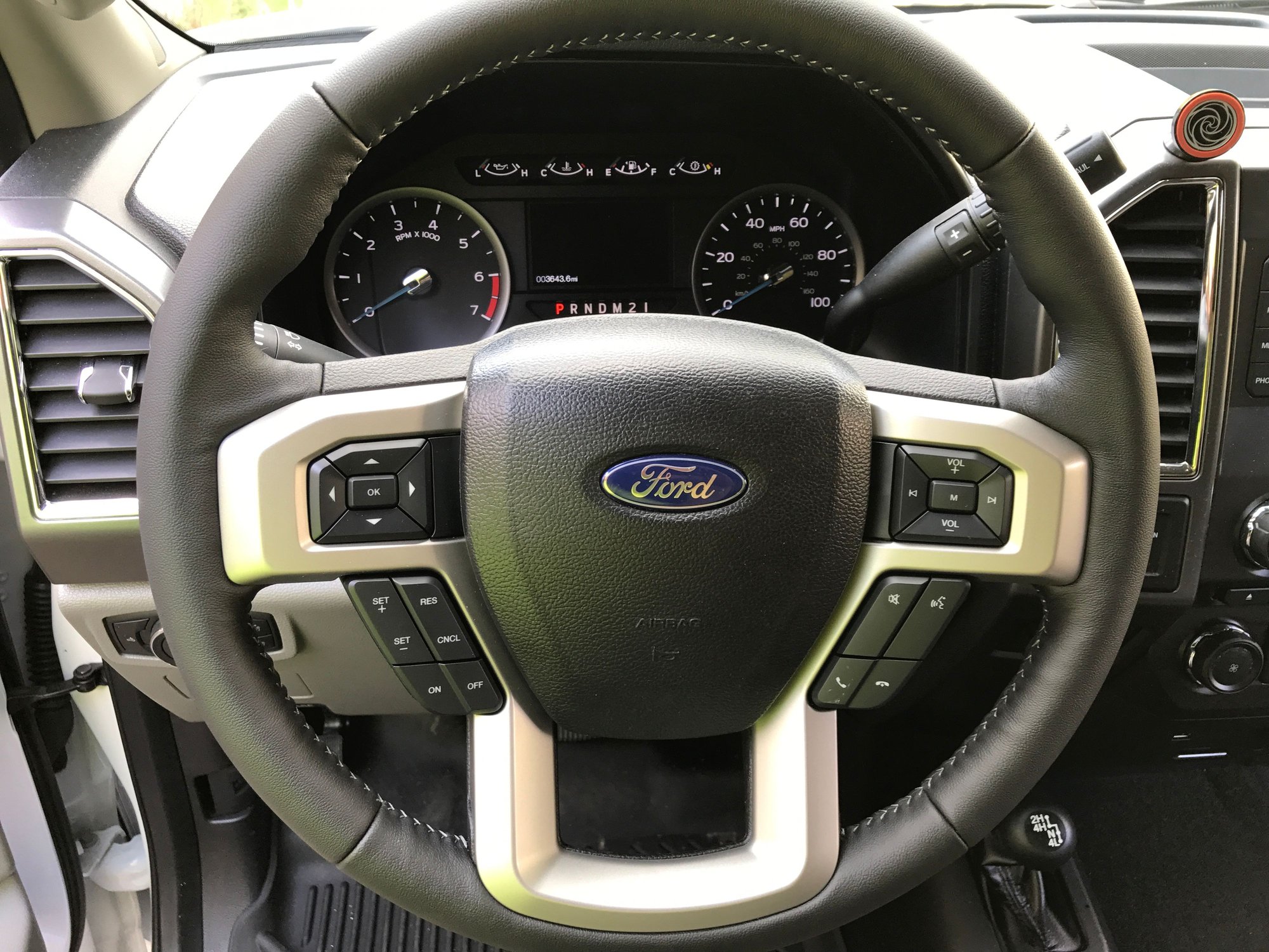

Bringing back an older thread because I am looking for a way to mount my TPMS for my camper and this might be the way.
Where did you mount this Hackenbush? Can you share a picture?

Little orange disk right of steering wheel, Works perfect

That's perfect. I was thinking of putting it above the vent to the left of the steering wheel. In my F150 I just used the suction cup mount on the windshield but I really hate those.
Thanks a bunch

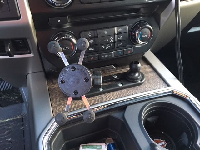

Piece of wood flooring with same wood grain. Inserted under rear with slot cut to fit and sliding door over front slot to hold in place. RAM rail mounted to wood
RAM T-Ball installed to rail.
Two RAM ***** installed that can be easily remove or whole wood bracket can be removed in seconds.
RAM X-Grip and short arm installed
Phone installed (prior to rail install) to X-Grip and USB data cord passed through slot in wood above mount bracket. Can keep phone charged, use phone map for navigation on truck screen and use Apple Car Play on trips
