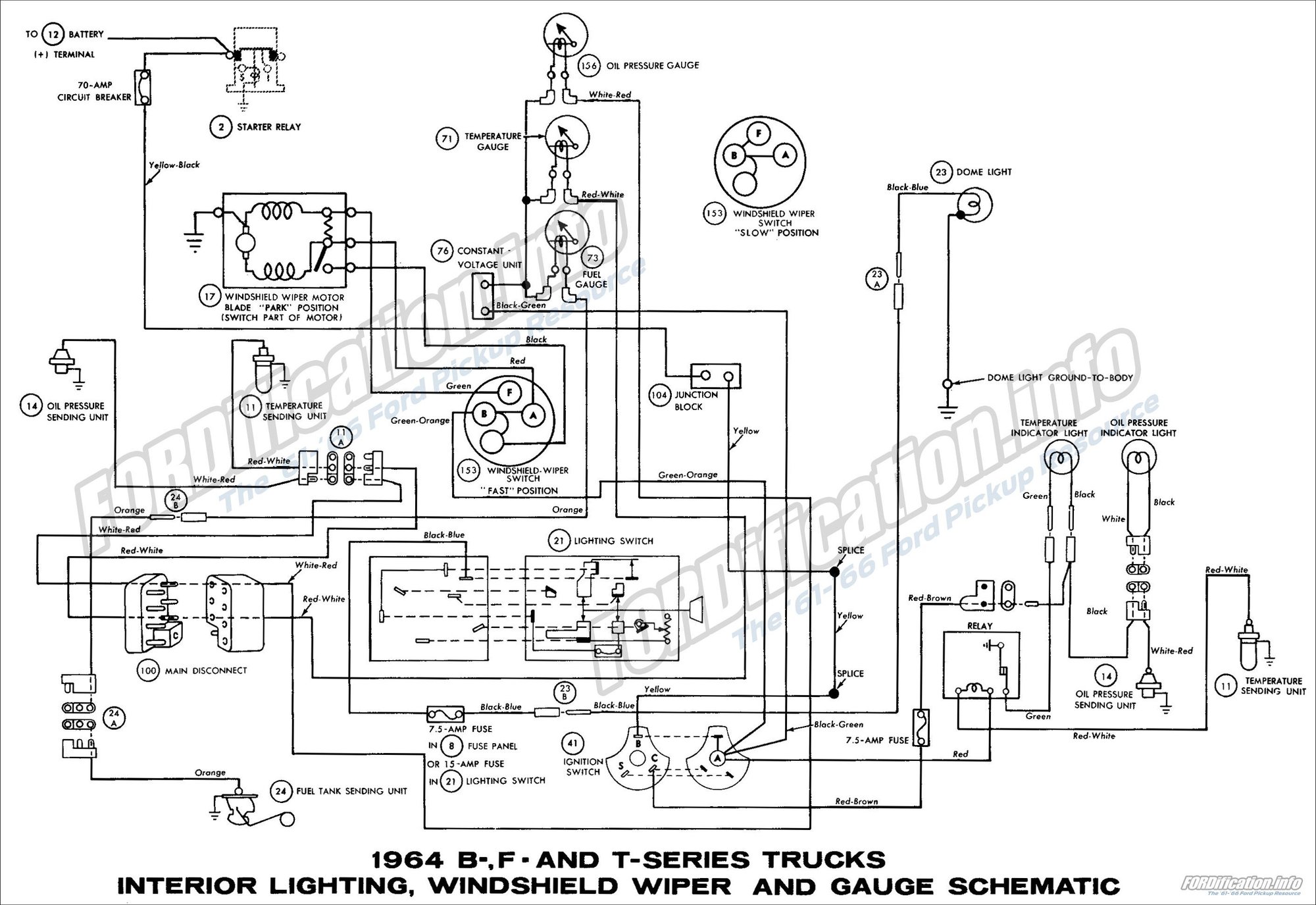

My truck didn't come with a dome light or headliner. It now has both. The blue/black wire was there. The dome light works when tested out of vehicle but otherwise does not. The blue/back runs down and disappears into a harness never to be seen again but has no power to it that I can read. Likewise the door switch wires. Can someone point me to a procedure for tracking down how to get power to the door switches as well as the dome? There are so many wires under the dash just hanging. All seem dead. It's amazing everything else seems to work.

The dome light would only have power to it when the light switch it turned all the way counterclockwise until it clicks... the power side comes out of the light switch/fuse block and there should be a short ground wire that goes to a seam where the roof panel and the real panel meet. There should be a fuse in line, but other than that It goes right into the fuse block.... check those fuses.

Thank you very much! There is no ground wire present. Only the blue/black connector. Fuses appear to be good as the cigarette lighter works. And thanks for the diagram!!

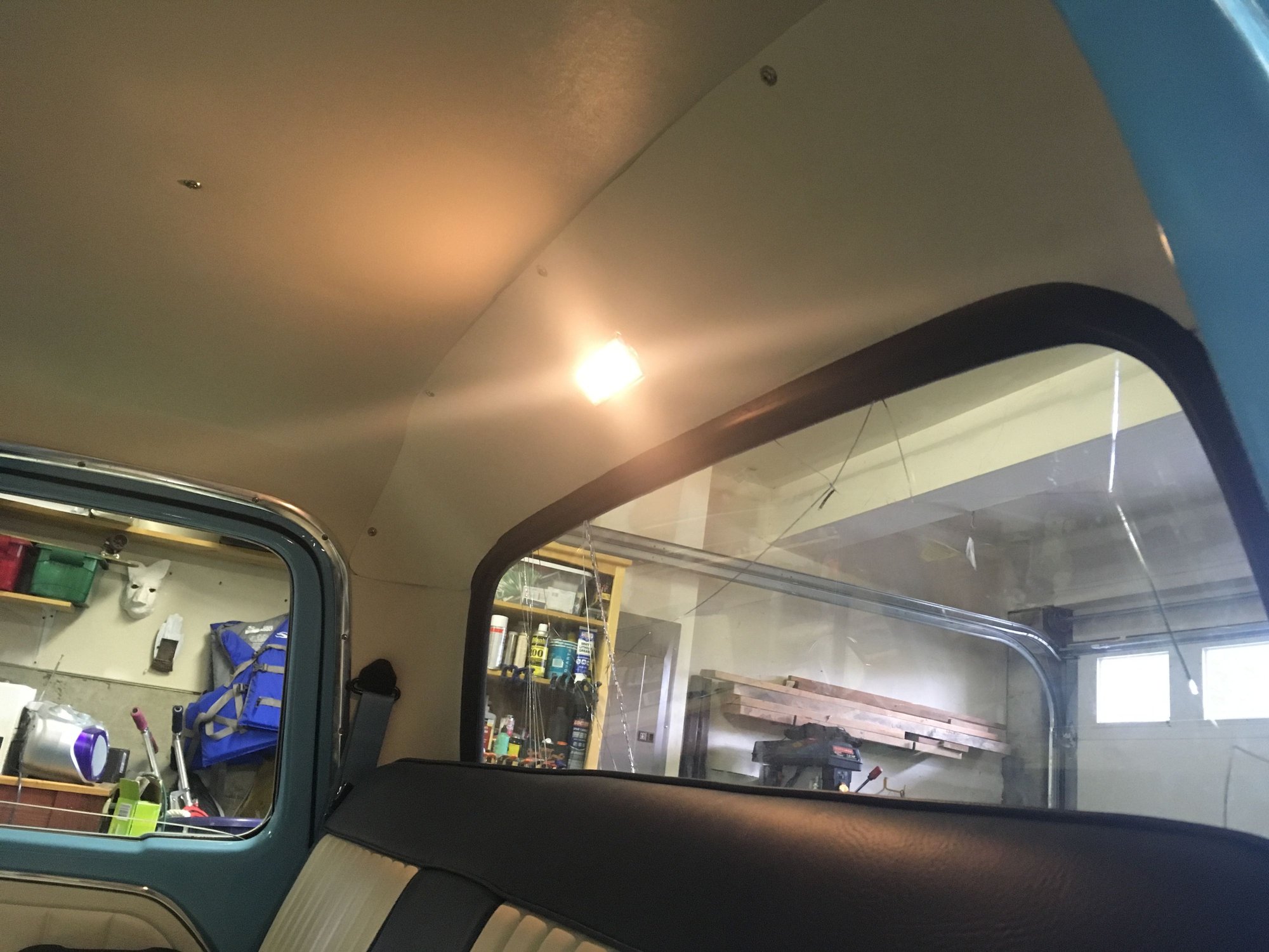

Thanks for all the help! Light is working. A combination of grounding and turning the switch! ha
