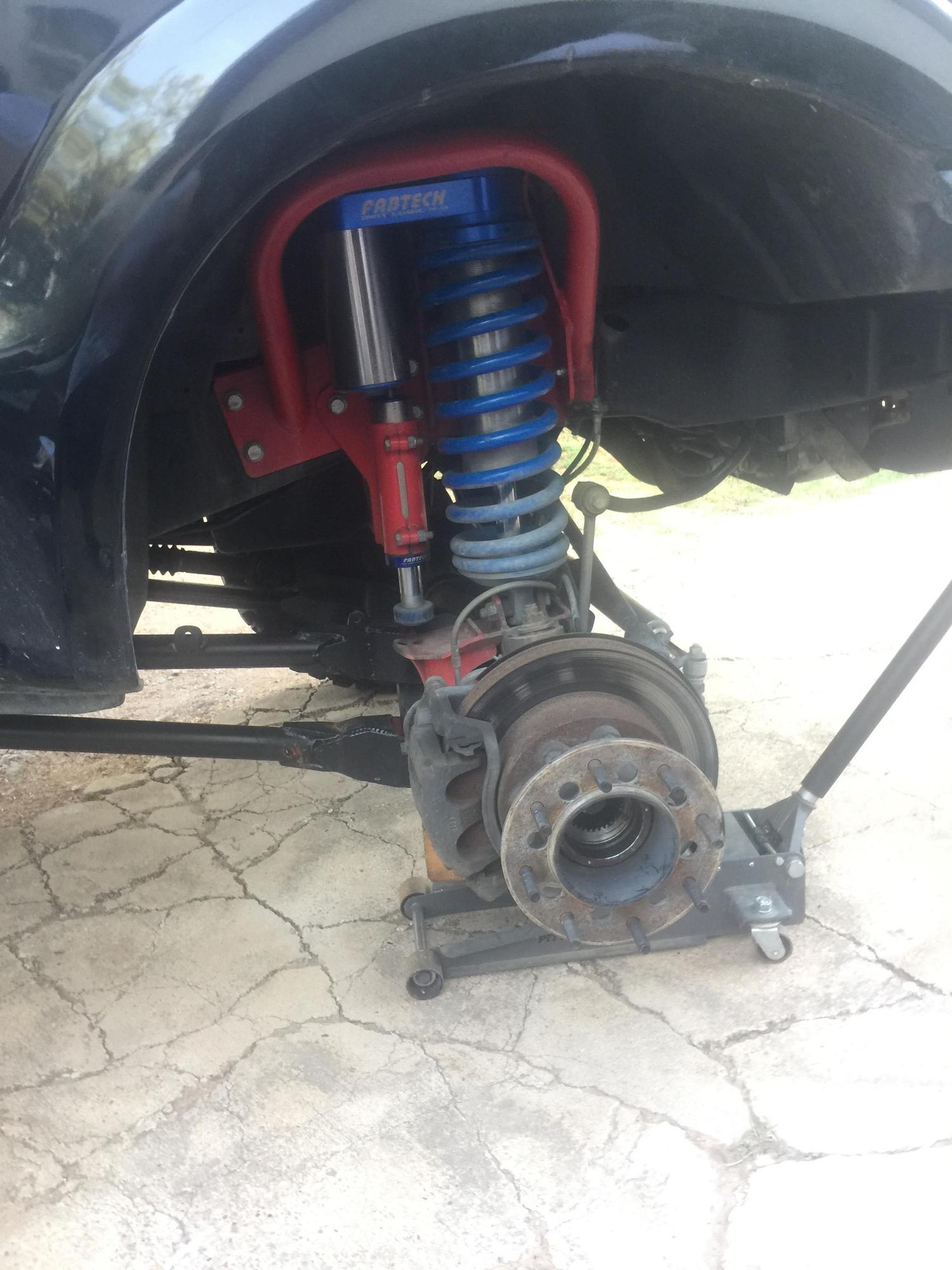

Hey guys, I just ordered the spanner wrench to adjust the coilover height, but was curios if anyone knows how to adjust it to ride softer? There is also a bolt on the bottom of the resivior and I can't find any info on what its purpose is. Can anyone school me on this ?
Heres a pic of the setup, getting rid of the red and making it black soon.

I'm also curious about how to ensure the bump stop is set at the correct height.

I had the same system on my 08. The coil over is already at the top of the adjustment. The only way to soften the ride up would be replacing the coils springs. Which fabtech does offer. Theirs a printed marking on the coil over itself that will give you the pound rating. Just give them a call and see what they would recommend.
As for the bolt at the bottom of the reservoir it's were it's filled up at.
