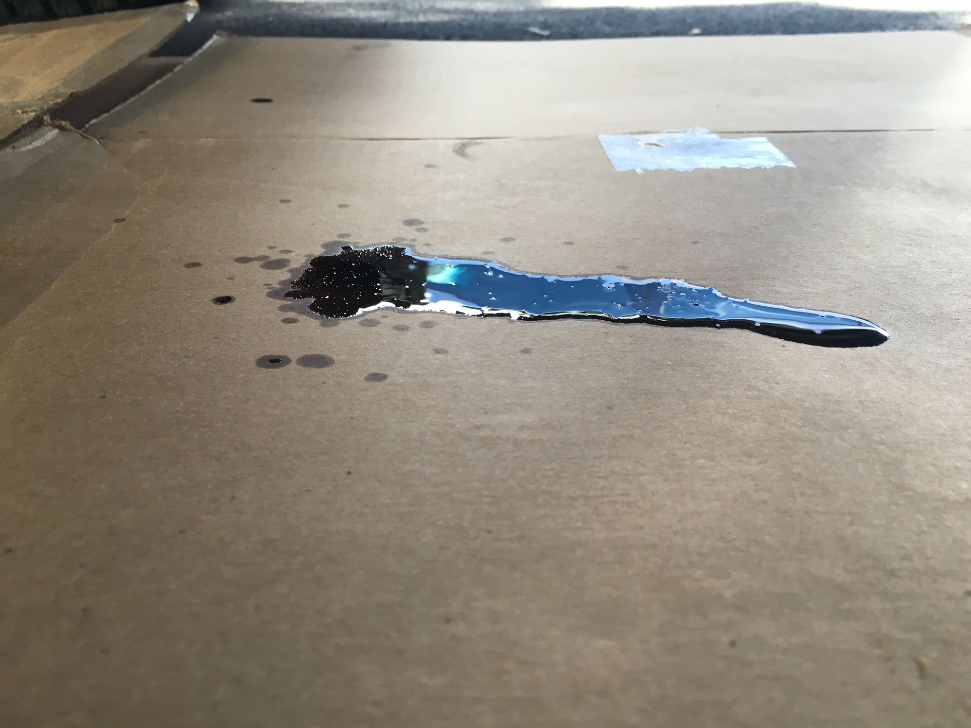

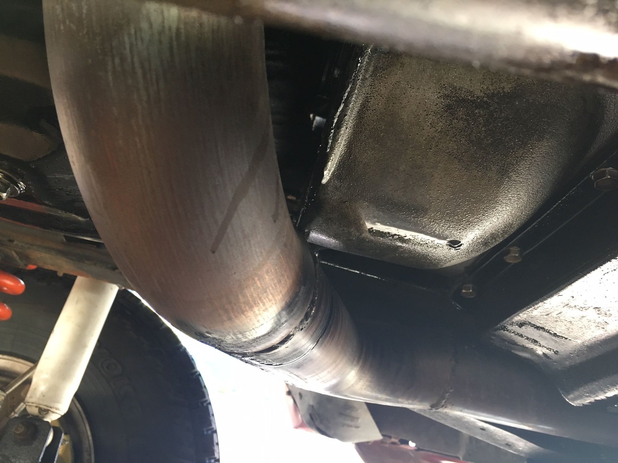

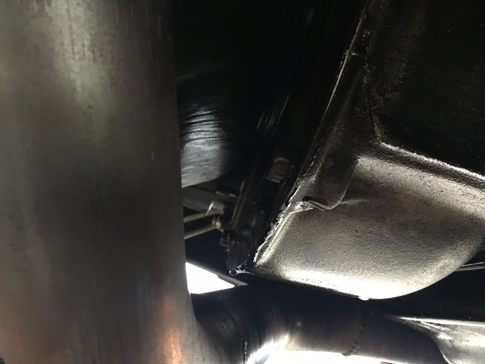

1978 F150. truck has a fresh built 545. only about 500 miles on it. getting a pretty good oil leak. the pic with the pool of oil on cardboard is after 30 mins of sitting after driving. the other 2 pics are about as near as I can tell to where the leak is coming from. any ideas? thanks
oil collecting before dripping down on cardboard
after 30 mins os sitting after a short drive
you can see where the oil seems to be coming from before collecting and dripping down on cardboard

I'm guessing rear main seal.

I'd crawl on top of the block with a flashlight and mirror and work down. Gravity will show you the high point of your leak. Inspect the sides of the block also. The good news is that there is a LOT of room in our engine compartments and only a couple of things could leak that badly down to the transmission dust shield - including the rear main seal.

well its needs a new transmission anyway, and I have one its way. I guess thats a good time to replace the rear main seal, if in fact that's where the leak is coming from.

Who did the "fresh rebuild" on the 545? I would think that with all that work and $, you would get a new rear main seal and it would last more than 500 miles.
If you took it to a pro shop I would ask them if they put a new one in. And what was the mileage that your warranty was on items like seals. Never hurts to ask.

Do you know this is engine oil for sure? I know it looks dark in the picture but so does burnt tranny oil too.

I'm betting that's crappy trans oil from the front seal. It will have a very distinct smell if it is.
