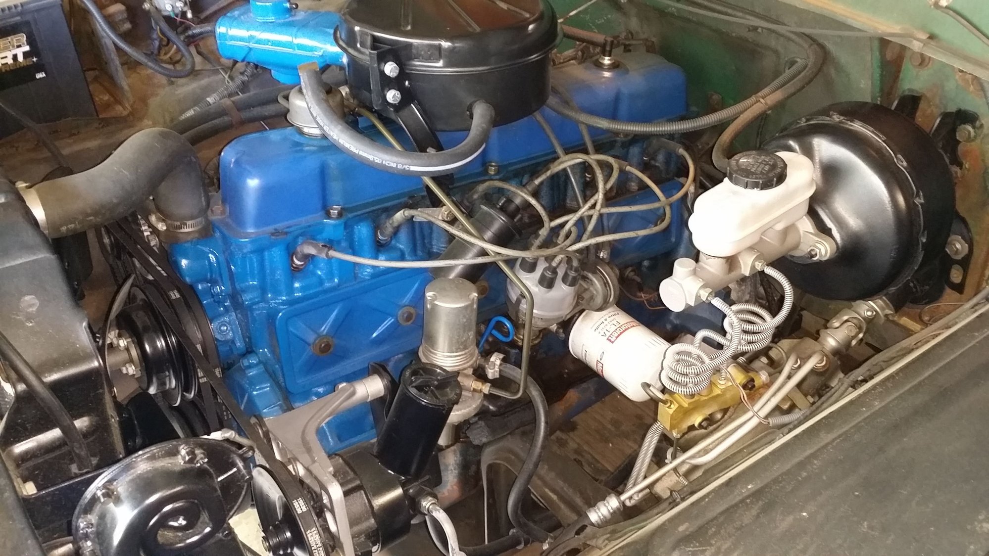

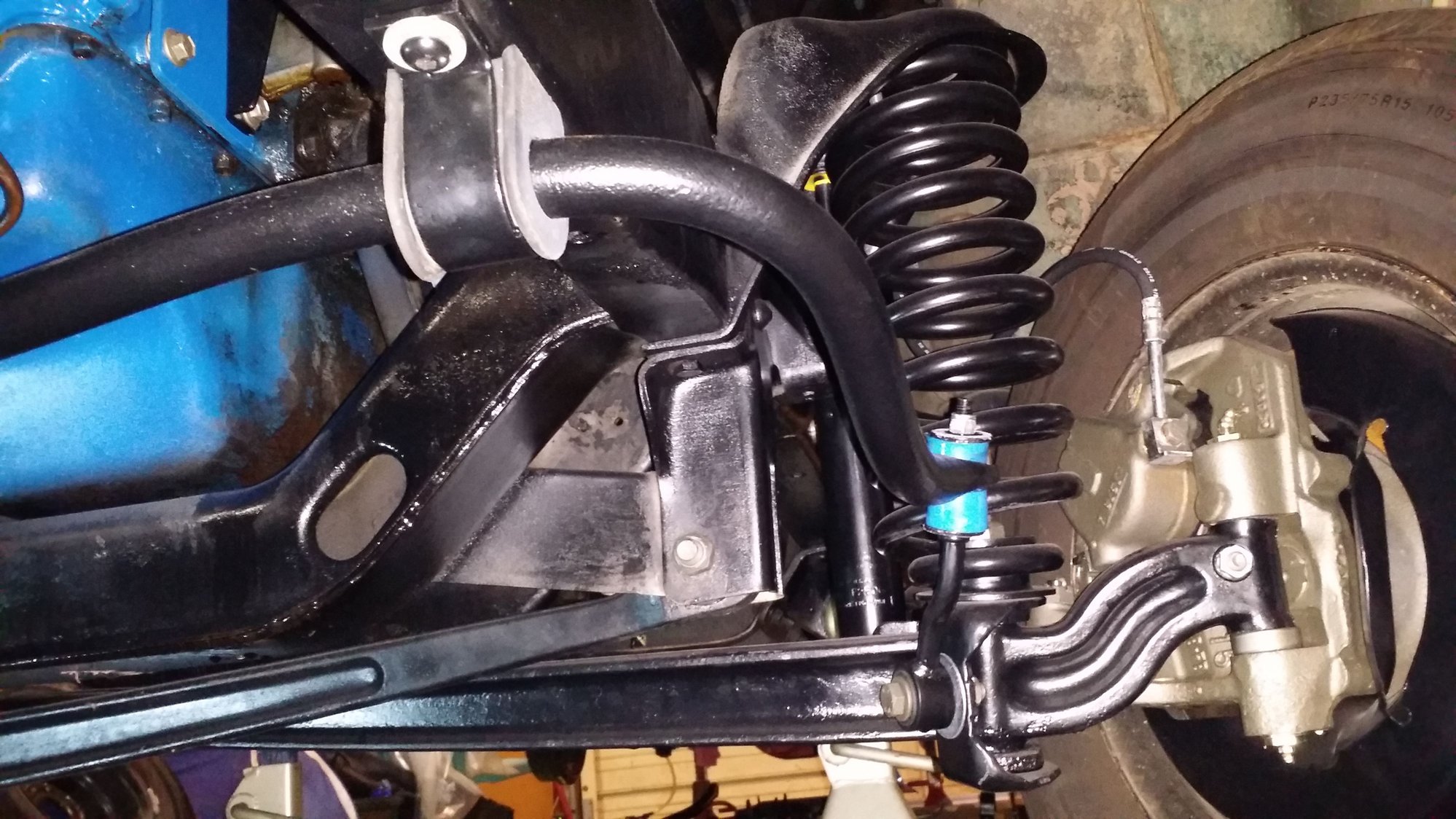

Currently, my truck has a 240 inline six and a C4 automatic. My truck didn't have power steering, power brakes or discs on the front when I got it in April, 2011.
I've since added front discs/suspension from a '77 F100, a dual diaphragm brake booster/mounting brackets from a '75 F350, a (Saginaw) power steering gearbox from a '78 F150 and a power steering pump/pulleys/brackets from an '82 F150 that had a 300 in it.
You could do something similar to the truck you have to make it safer and more enjoyable to drive.

Finding the conversion parts just depends on what's available in your local wrecking yards or what private individuals might have. Unfortunately for the last number of years, wrecking yards have been on a rampage to crush Dentside and earlier model trucks, thus, the loss of lots of valuable parts one could have used on their Bumpside/Dentside trucks.
I have the main suspension components to do a front disc brake/suspension conversion from a '75 F100, spare F350 dual diaphragm booster/brackets/dust boot for the power brakes and several power steering pumps/brackets/pulleys for a 240/300 inline six from Bullnose era 300s. --these are all parts just like I installed on my '69 F100 Ranger shown in my previous photos.
If you can't find anything locally, you can P.M. me for more information/photos of what spare parts I have.
