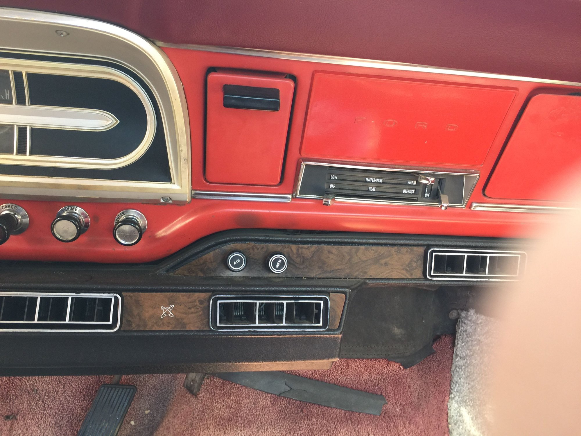

Old Sep 14, 2017 | 06:00 PM
Flooringit's Avatar
Flooringit
Joined: Jul 2017
Posts: 148
Is this factory ac? It's not in the other control so I'm guessing not?
