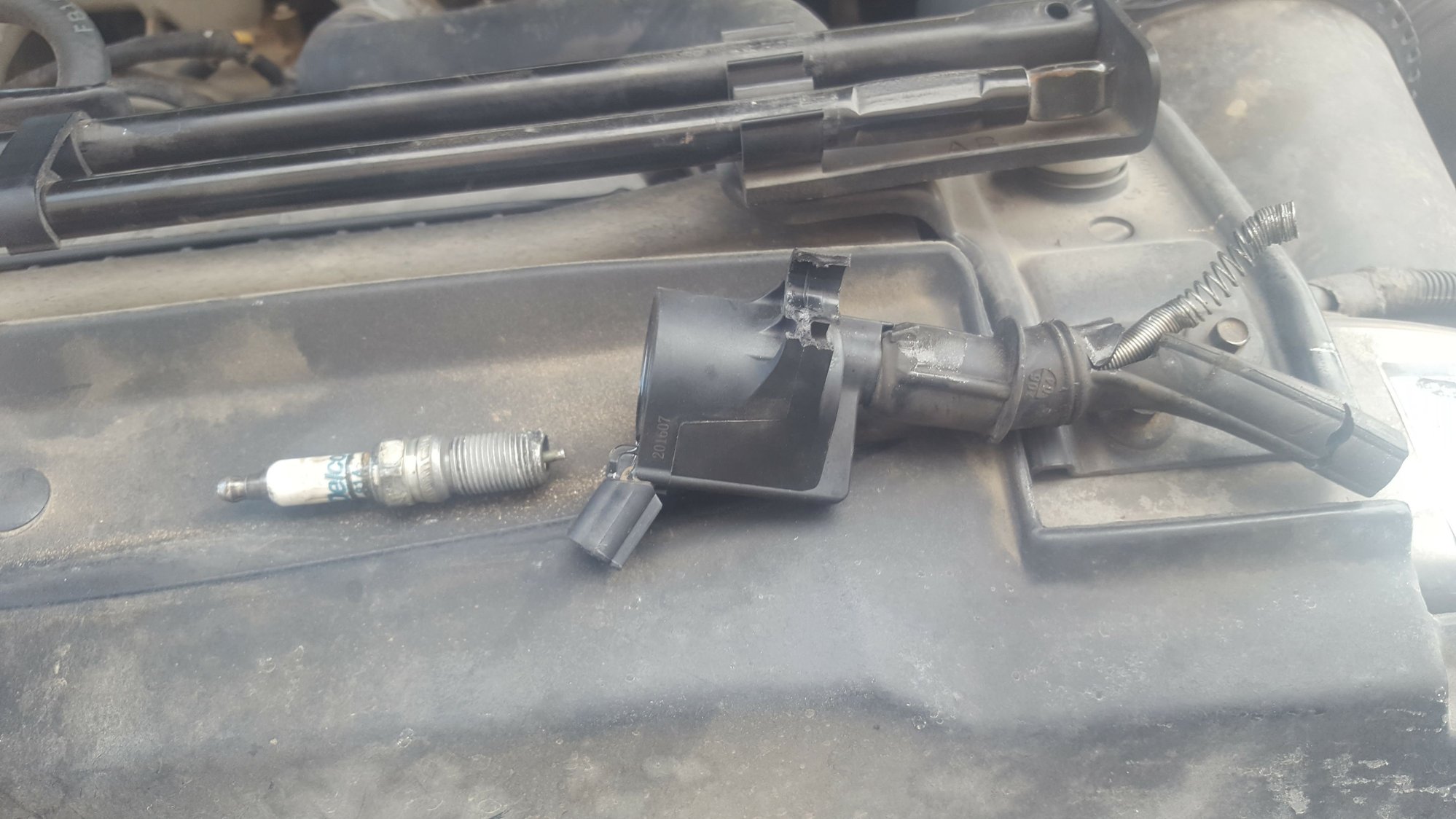

Blew a plug in Lawton OK.
2003 V10.
Anyone know a good shop in the area?

Ended up driving it home after disconnecting the injector.
About 200 miles with wife, 5 kids, dog, and a 7,500 lb camper.
Time-Sert kit is on order.
I bought the vehicle a few months ago and changed the plugs and boots then.
#10 had an oddball plug so I assumed it had some kind of insert.
I put the old oddball plug back in as I couldn't find one locally.
Figured I would get to it later. Had trouble finding a match online as well.
One guess on which one blew. Looks like it melted before coming out as well.

Hopefully that ground strap broke during the launch/landing of the plug and not before. To be sure, I would look down in that hole with a borescope and make sure you dont have damaged piston/bore/valve.

Everything is good from what I can see with the borescope.
I did use anti seize.
Don't remember what I torqued them to but it was an amount decided on after several hours of reading/searching, mostly on this forum.
Now need to decide if I should put inserts in the others.
I was thinking I wouldn't need to since it is an 03. Maybe I will just throw the kit in with my onboard tools.
