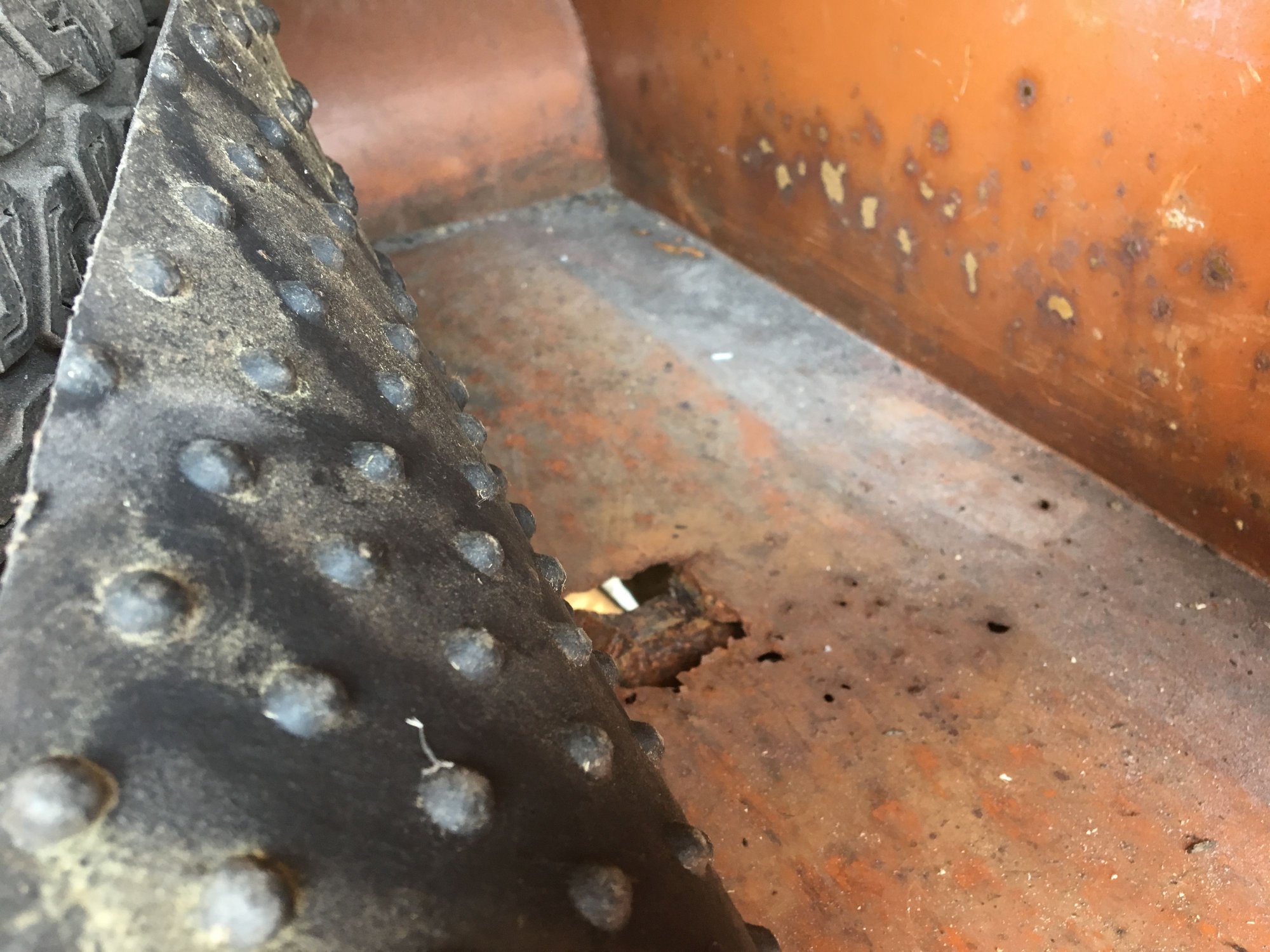

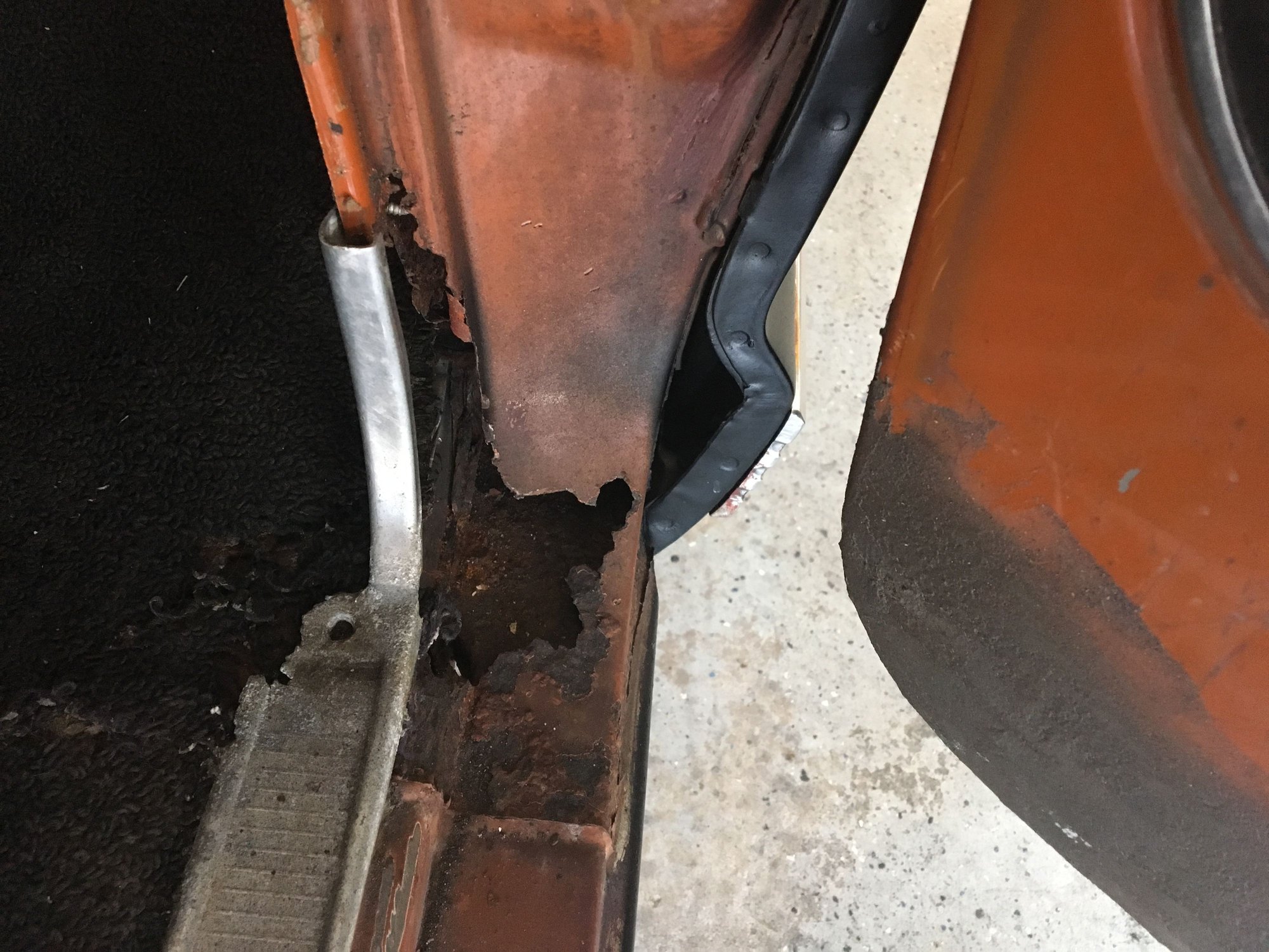

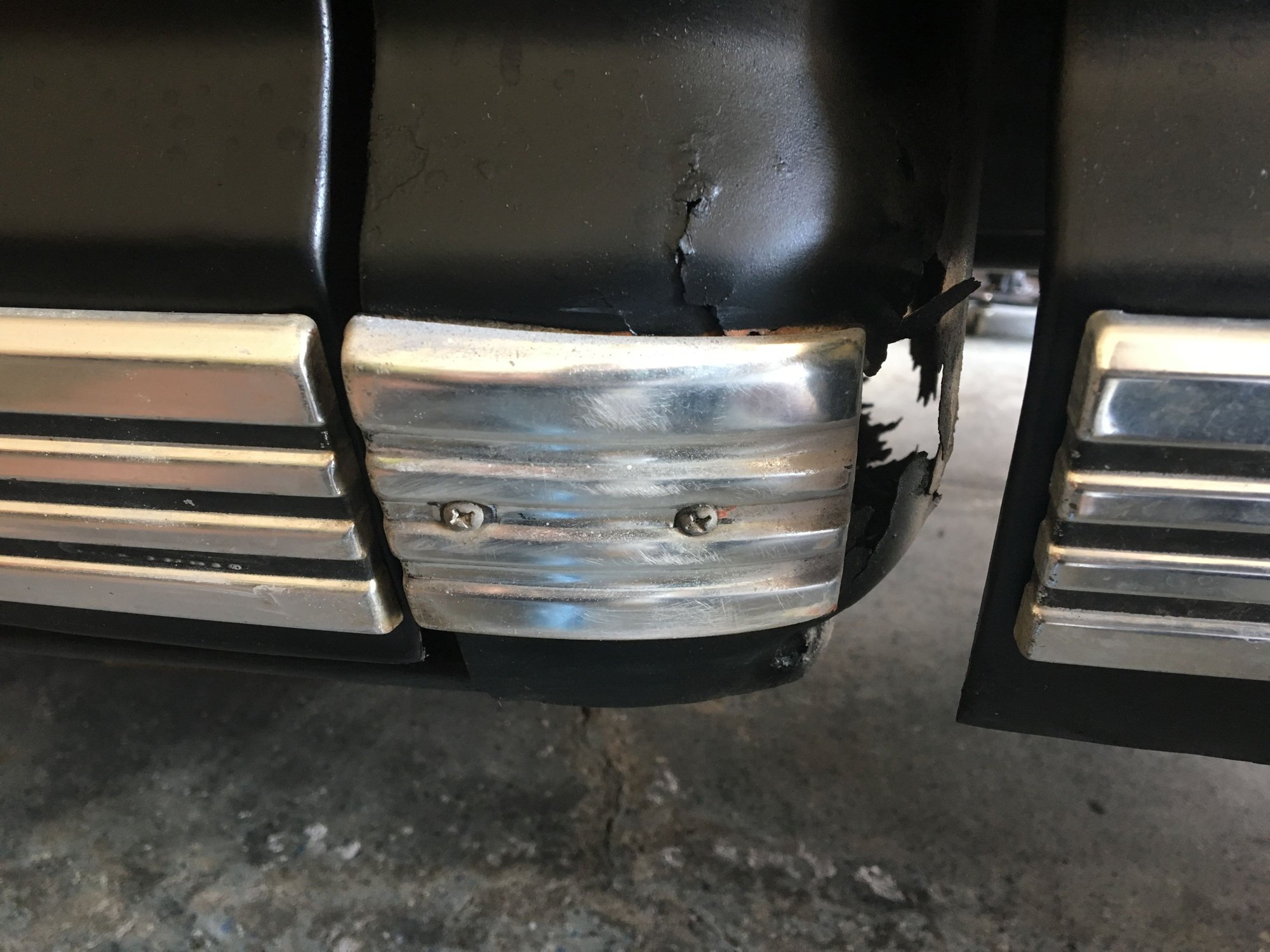

Thanks for the info. Couple other photos of the truck where its rusted. Patch panels come with the truck.
What do you guys think?
Bed
Bed

I'd pass. On rigs like that, especially in the snow belt, there is always more rust than what you see at 1st.
Have you thought of buying a truck outside of the snow belt and having it transported to you?

Look at the bed floor, it's not the original.
Floor was probably rusted out, then someone welded in a piece of 'plain-jane' steel, then covered it with that ugly diamond plate, that has been peeled back.
Look at the rusty bed cross member. Is there a patch panel for that? No...and if one is rusty, you can bet the farm that the others are in the same condition.
Truck in reality is rusty mess, gawd only knows what the mechanical condition is. Seller says he needs the garage space, probably for something else he bought since it's a 3 car garage.

The truck has way more rust than you see since the trucks rust from the inside out. Like those kick panels, they are so pitted and thin on the backside you will have to replace them all the way to the dash.

The rust on the kick panel and door sill area behind the passenger fender is a huge pain to fix.They don't make a good patch panel for it so you will be fabricating. If you have to ask, then probably better pass
