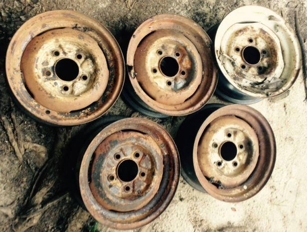

Innie nub wheels
Anybody near Auburn? Looks like a good deal 5 for $50.00 (One is an outie nub).

That's a smokin' deal! Wonder if they're 16"?

Says 60 F100 most likely 15

8C-1015 .. 16" Innie Wheel - 16" x 4.25" = 1948/52 F1; 1953/62 F100.
B4TZ-1007-A (replaced B3C & B4C 1015-A) .. 16" Innie Wheel - 16" x 5" = 1953/66 F100.
B5C-1015-A .. 15" Innie Wheel - 15" x 5" = 1955/62 F100.
5 lug 5.50" bolt circle innie wheels: 1940/48 Ford/Merc Passenger Cars; 1948/52 F1; 1953/65 F100, some 1966 F100.
5 lug 5.50" bolt circle outie wheels: Some 1966 F100; 1966/96 Bronco; 1967/83* F100; 1975/96 F150.
*Some 1980/83 F100's have 5 lug wheels on a 4.50" bolt circle, some have 5 lug wheels on a 5.50" bolt circle.
Bill - you fell victim to the typo in the Chassis Catalog. The 8C 1015 is 4.50" wide. Stu
