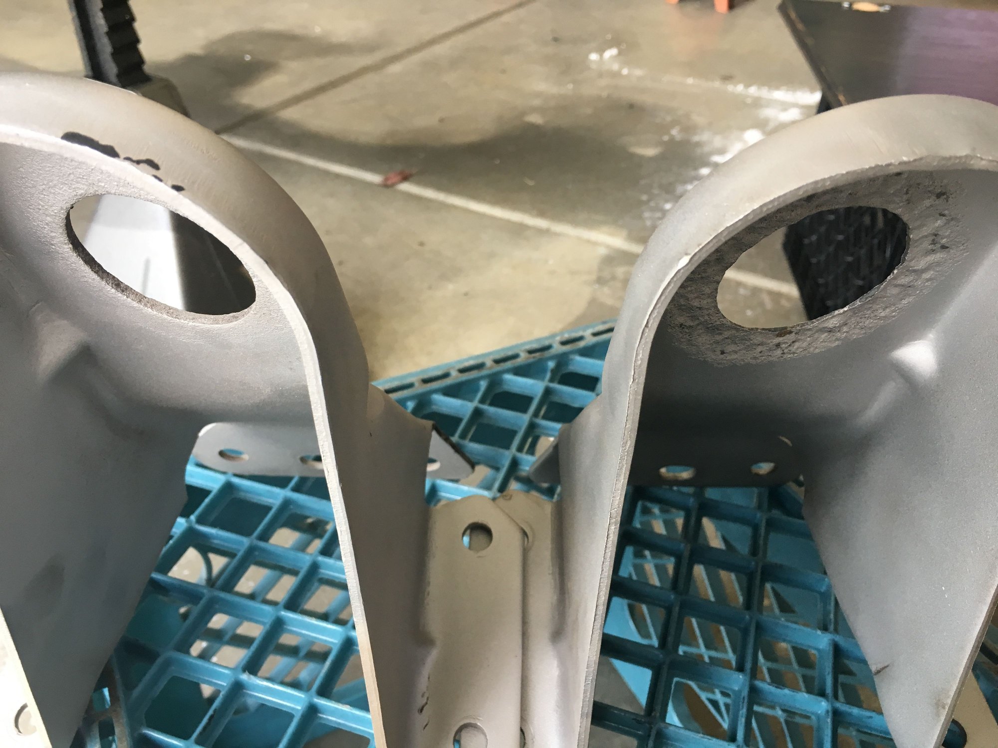

Finally got a little time to work the project and found a problem... Upon getting the 'cab perches' sand blasted, I noticed the left perch has suffered considerable corrosion around the hole where the mount bushing goes. These brackets came from the factory measuring about 9/32" (a bit thicker than an 1/8"). There are numerous areas that measure around 3/32" (thinner than 1/16"). This is a loss of over 0.100" in material.
I think it should be replaced... Does anyone know a source for these? A search on eBay and several internet vendors that specialize in old Fords and trucks turned up nothing.
I think realistically, this is probably a trip to the junkyard. I imagine any half-ton 4x4 dentside (or bronco) will do... Does anyone have a more expanded parts interchange for this?

Your photobucket link doesn't show. I have a frame I am parting out that I could remove them from. I'm not a home right now so I can't get you pictures. right now.

Yeah Photobucket sucks. I am trying to find a new image hosting service that works with this site right now.

Old Aug 27, 2017 | 03:11 PM

This is the so called "cab perch" the OP asked about. Says he needs a left, but didn't specify Regular or Super Cab or front or rear (Rear: F100/250 Super Cab; F250 4WD & F350).
D3TZ-5077-C .. Bracket to Frame Kit-Front - Includes right & left sides / Obsolete
1973/77 F100/250 2WD/4WD & F350.
No Ford dealer or obsolete parts vendor has any.

Thanks for all the replies. It is a regular cab. There are only the front perches on this model. The rear cab mounts go through the cross member. I might just do the frame saver option... A lot less hunting this way.
