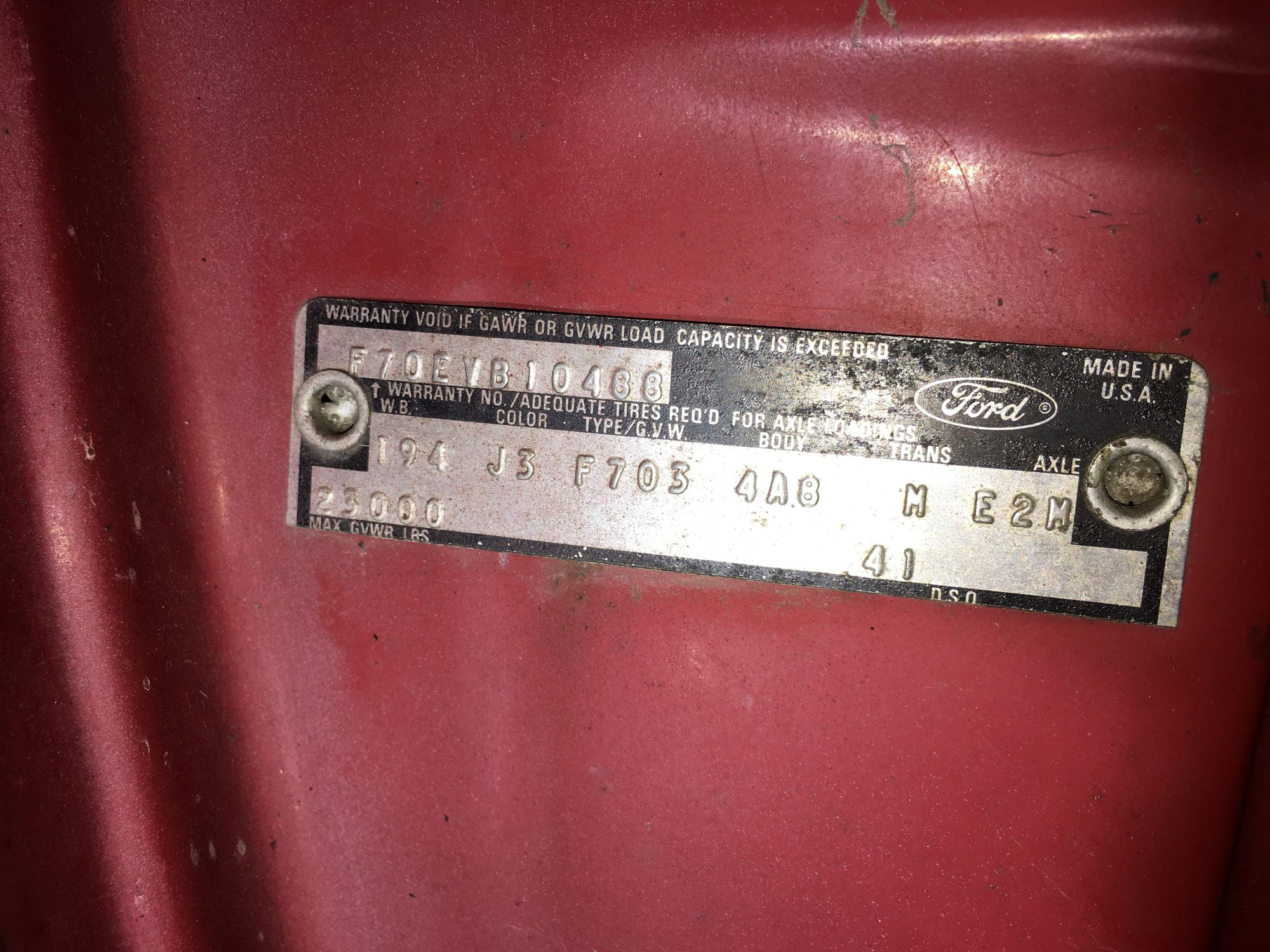

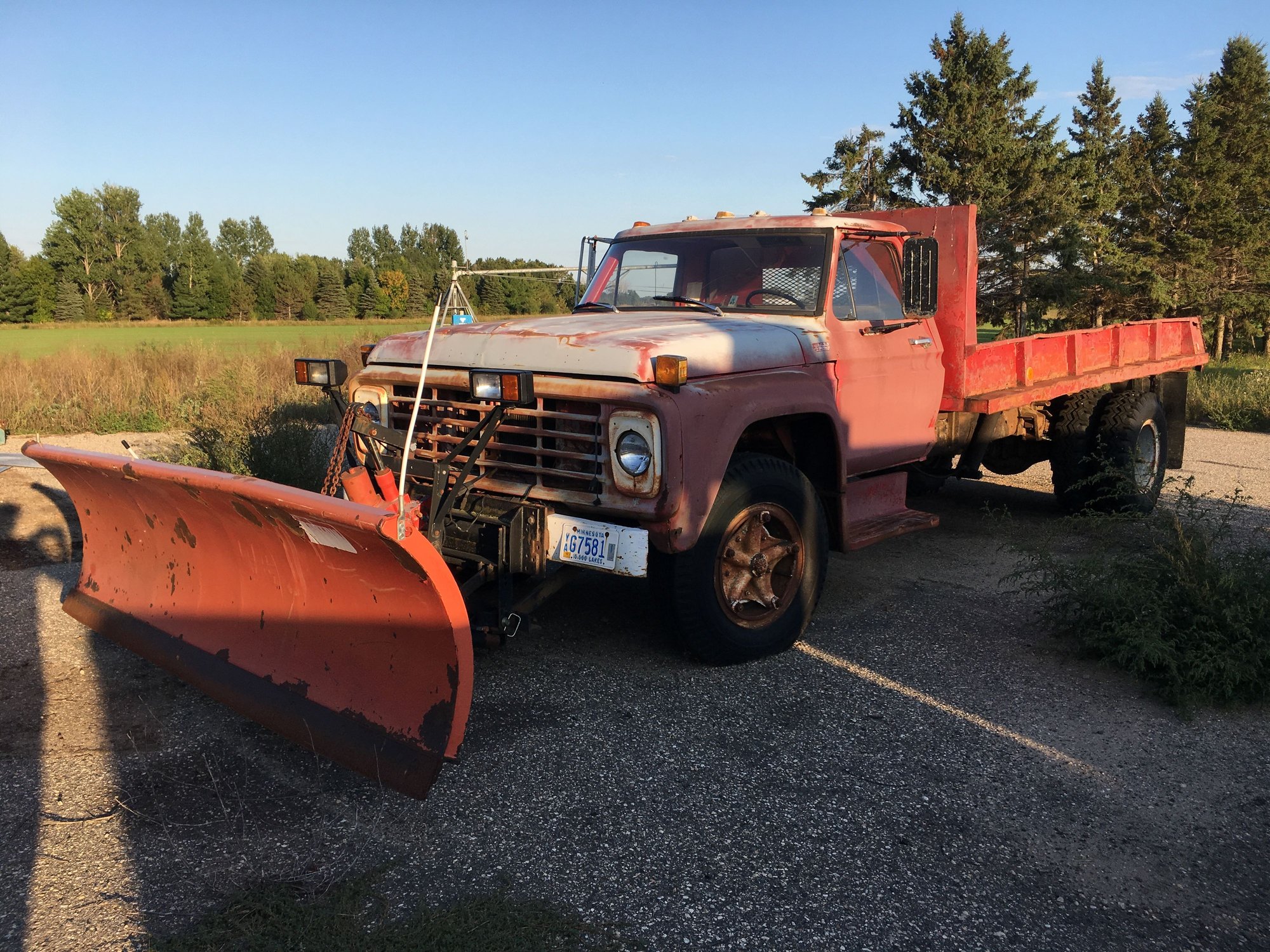

Hello! I came across this Forum doing some research on a truck we found on a local farm. I know it's a mid-70's F-700, but was hoping someone could decode this VIN and tell us what exactly we have here. Any help would be really appreciated.
Please ask further questions in the LARGE TRUCK forum, most members of this forum (1957/60) have pickups, plus your truck is a 1976.
F70 = F700 (gas).
E = 361 2V or 4V FT engine.
V = Kentucky Truck Assembly Plant.
B10488 = 1976.
194" Wheelbase.
J3: J = Rangoon Red // 3 = Tan.
F703 = F700 (gas), 23,000 lbs. GVWR
4A8: 4A = Black Heavy Duty Vinyl - Full Width Seat / 8 = 81A Standard Cab.
M = Clark model 285V 5 Speed Direct
E2M:
E2 = Eaton model 16244 Two Speed Rear Axle / 6.17/8.58 / 17,500 lbs. Rear Axle Capacity.
M = Ford 7,000 lbs. Capacity Front Axle with Power Steering.
23,000 lbs. Gross Vehicle Weight Rating.
41 = Chicago IL Ford District Sales Office, where the original selling dealer ordered the truck from.
