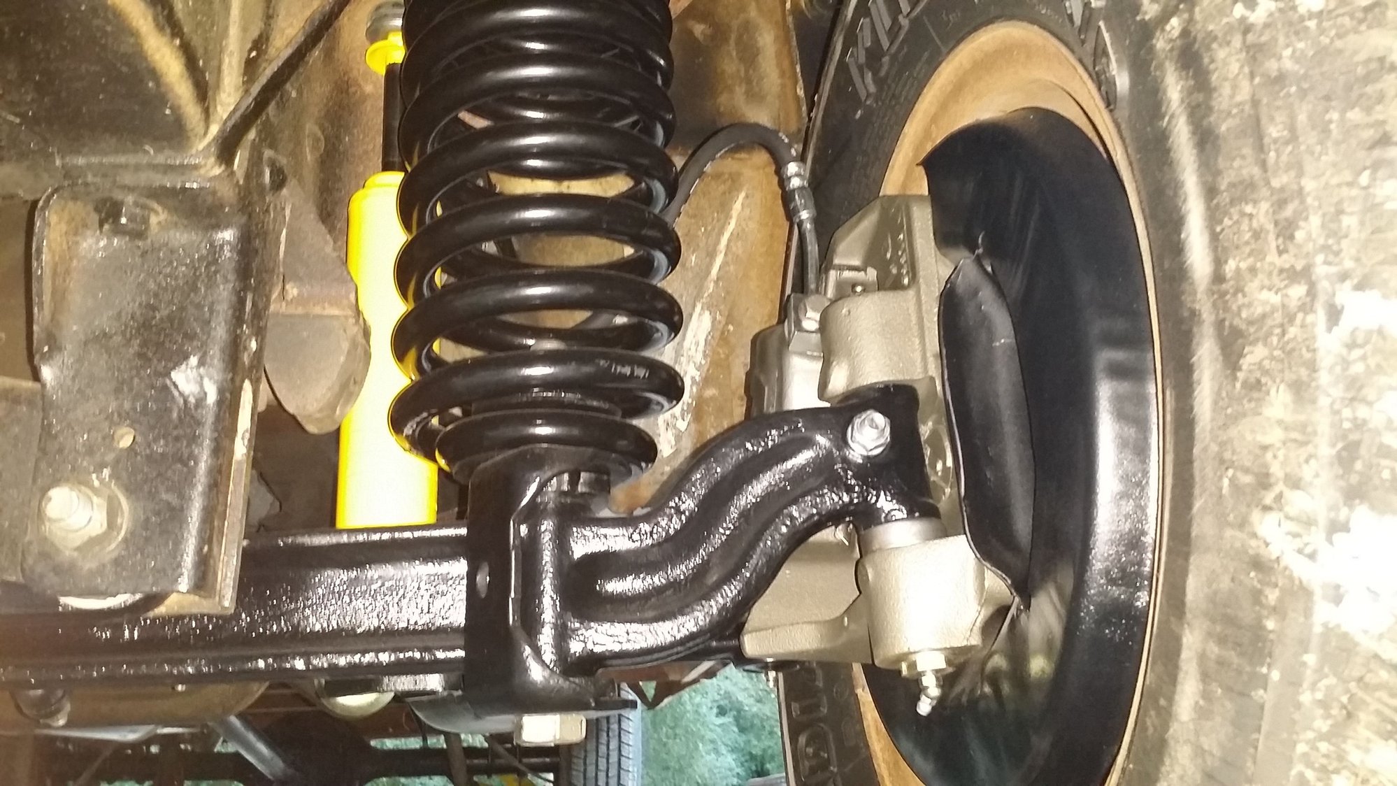

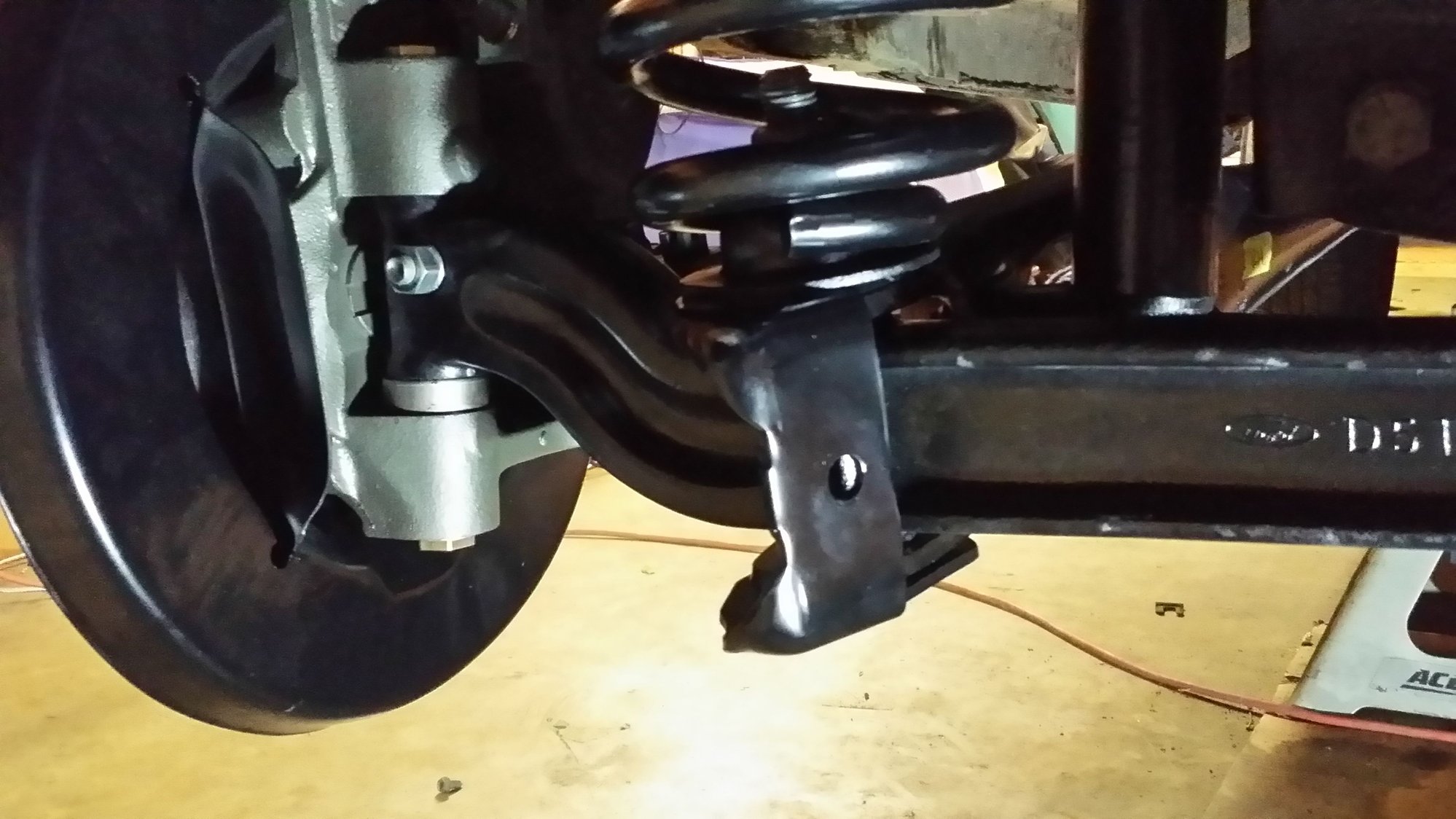

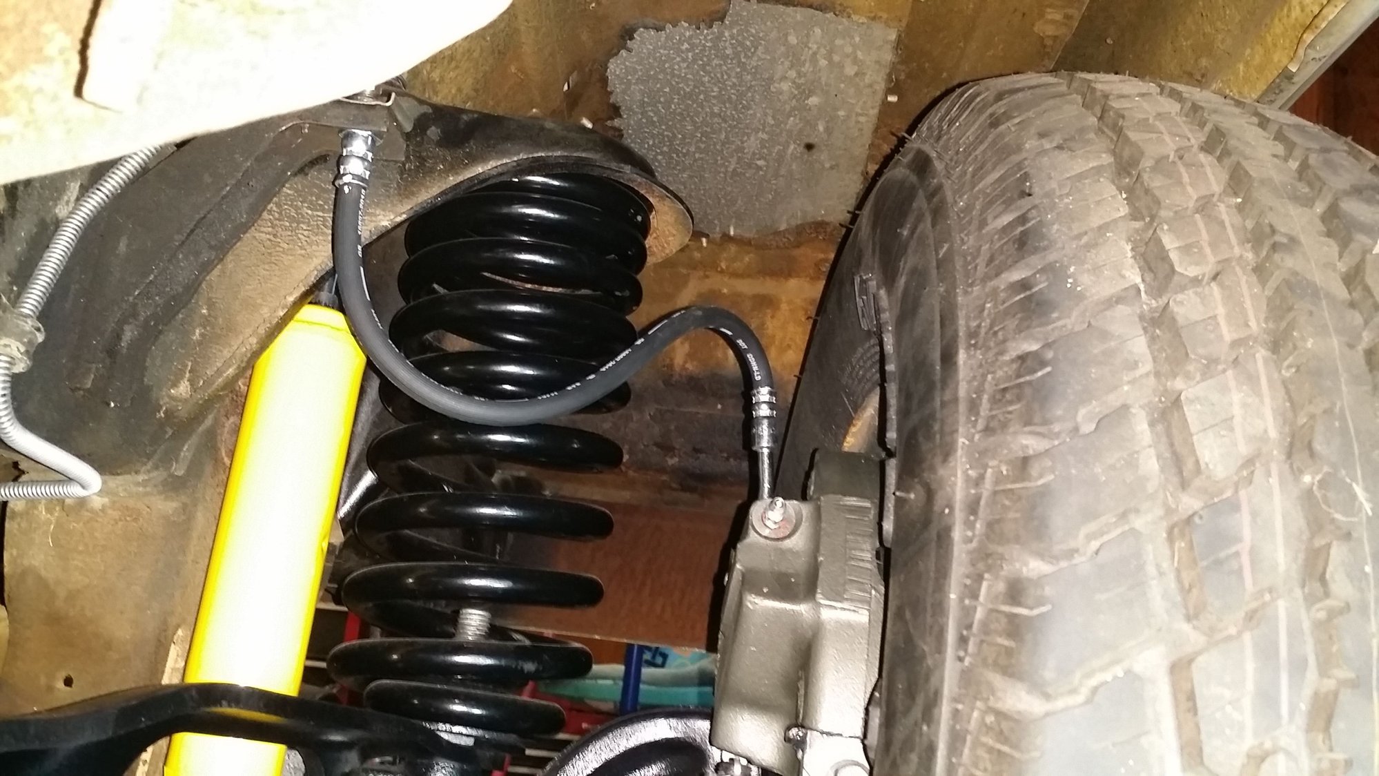

There are no bushings on the springs. They just attach to the spring seat at the lower end on top of the radius arm/I-beam and the upper end of the coil spring is just indexed into the pocket of the spring 'bucket'.
This was on a '72 F100 I had converted to front discs and installed the Moog CC808 progressive springs on.
This was on my own '69 F100 I converted to front discs and installed the Moog CC808 springs on.
