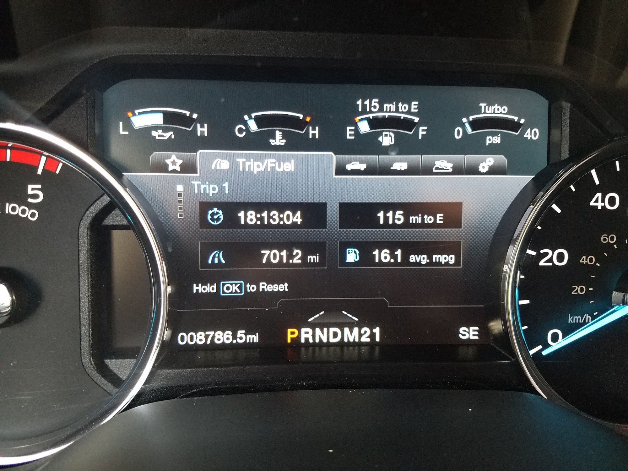

Originally Posted by Top_Speed1
You're (only) fooling yourself! No serious. Unless your name is Gordon Lightfoot, or maybe you always have tailwinds vs. my headwinds. It ain't ever happening period. And this coming from a dual owner of both trucks. My personal F350 averages 17 unloaded and with my heavy (sometimes) foot. My business F450 is at about 3mpg under this at around 14ish. Granted, if you never do high speed Interstates, the difference is very minimal.
Speed kills!... the F450 mileage that is!
How am I fooling myself? How can you say "It ain't ever happening period."? It did happen; the screenshot above is from over 700 miles on a tank of fuel in my 2017 F450. Clearly I didn't have 700 miles of tail winds. Most of those miles are my 25 mile commute. Hand calculating the mileage gave the 16.1 shown on my screen.
The majority of those 700 miles were on 55-70 MPH roads. I do drive gently, but the F450 can clearly get good mileage - I've proven it!
I really like the 4.30 gears in my F450. The short gears make it feel snappy, minimize downshifting when towing, and don't seem to hurt my mileage. I'm actually getting better mileage than I've seen anyone with the 3.55 F350 DRW get (and the 450 weighs 500# more).
Note that I normally get 15.5 or so. The tank above was a little better than average, but shows why I enjoy my 4.30 gears.
Where's the lifetime mpg? Lol
