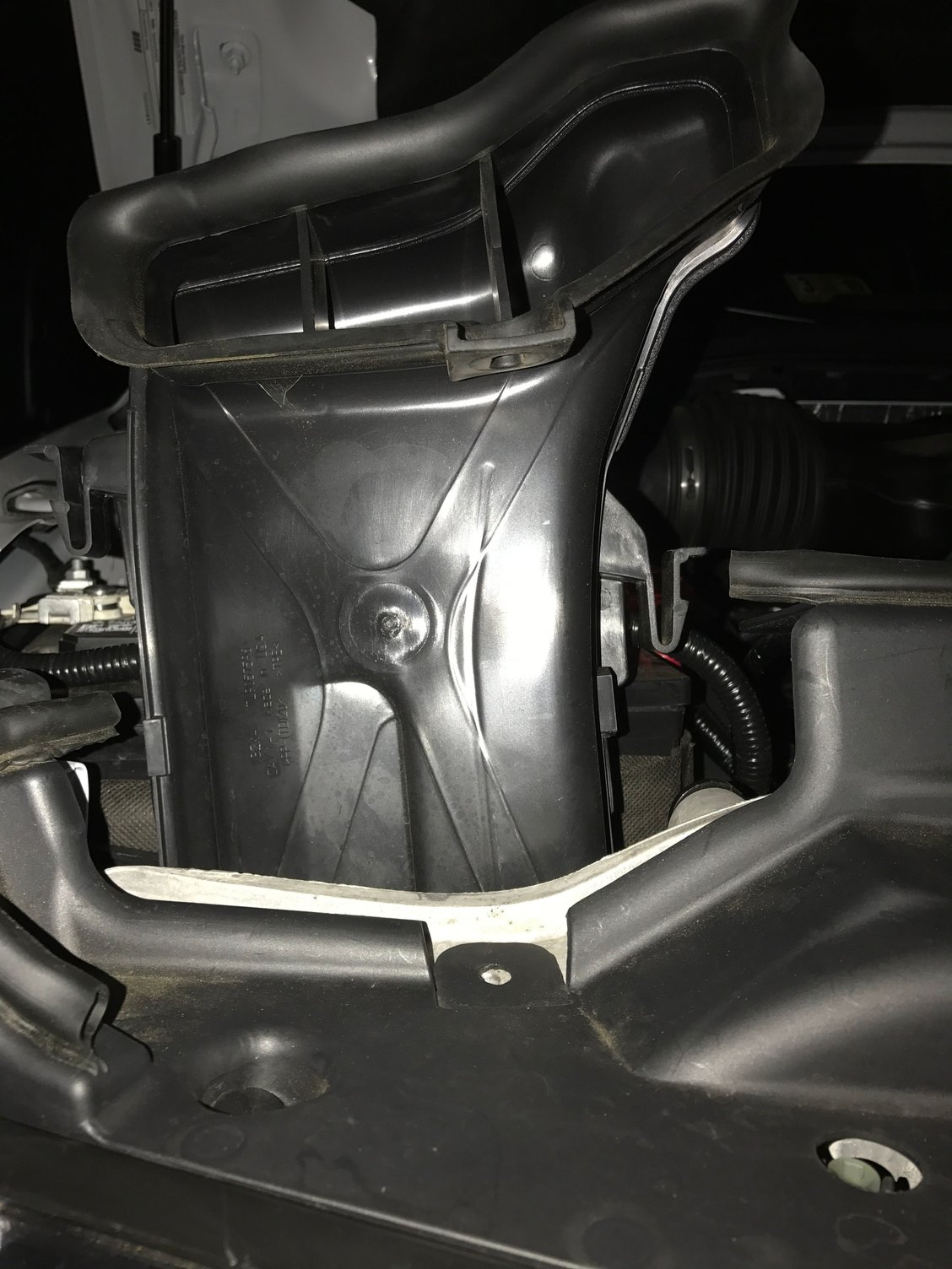

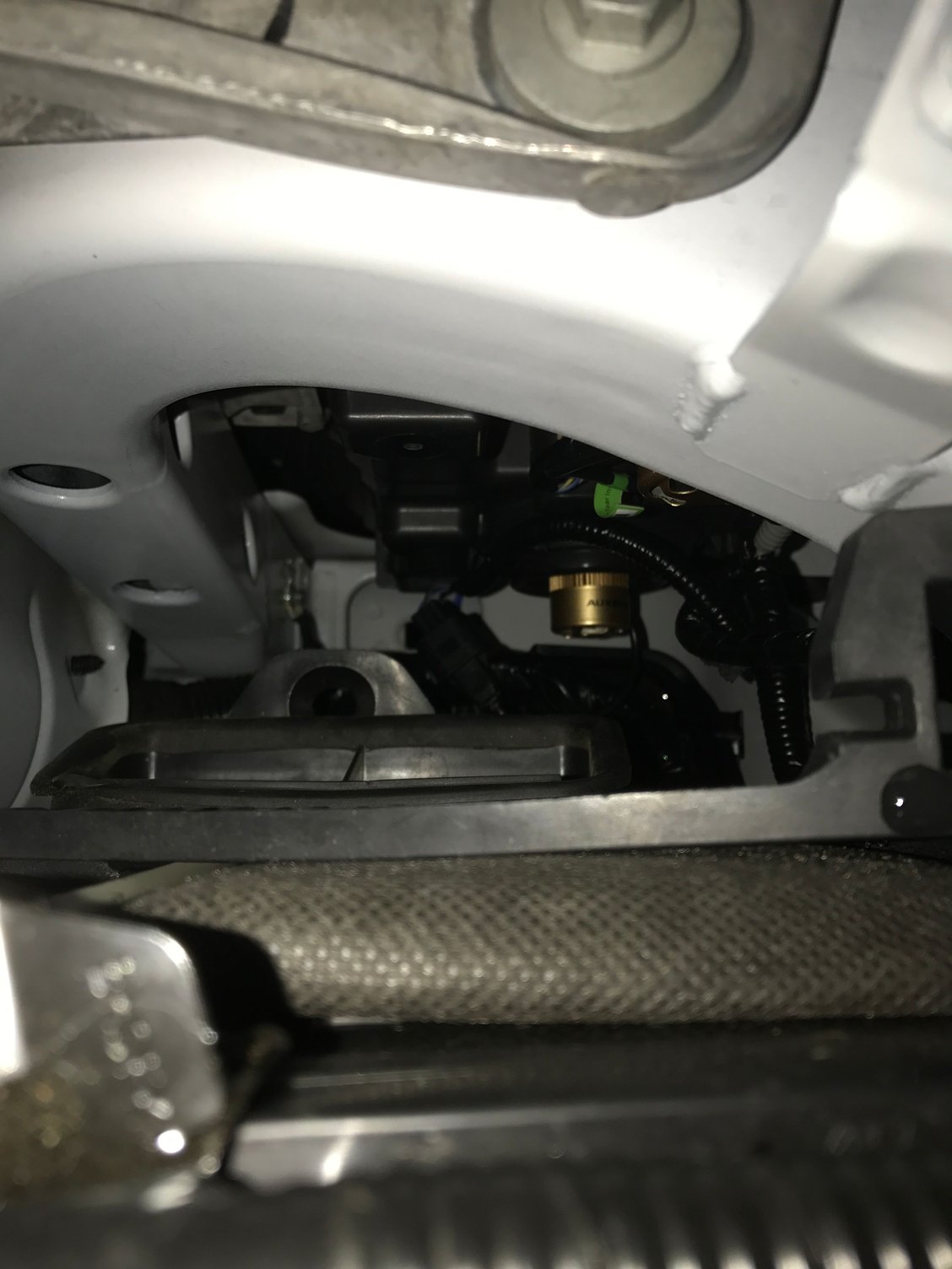

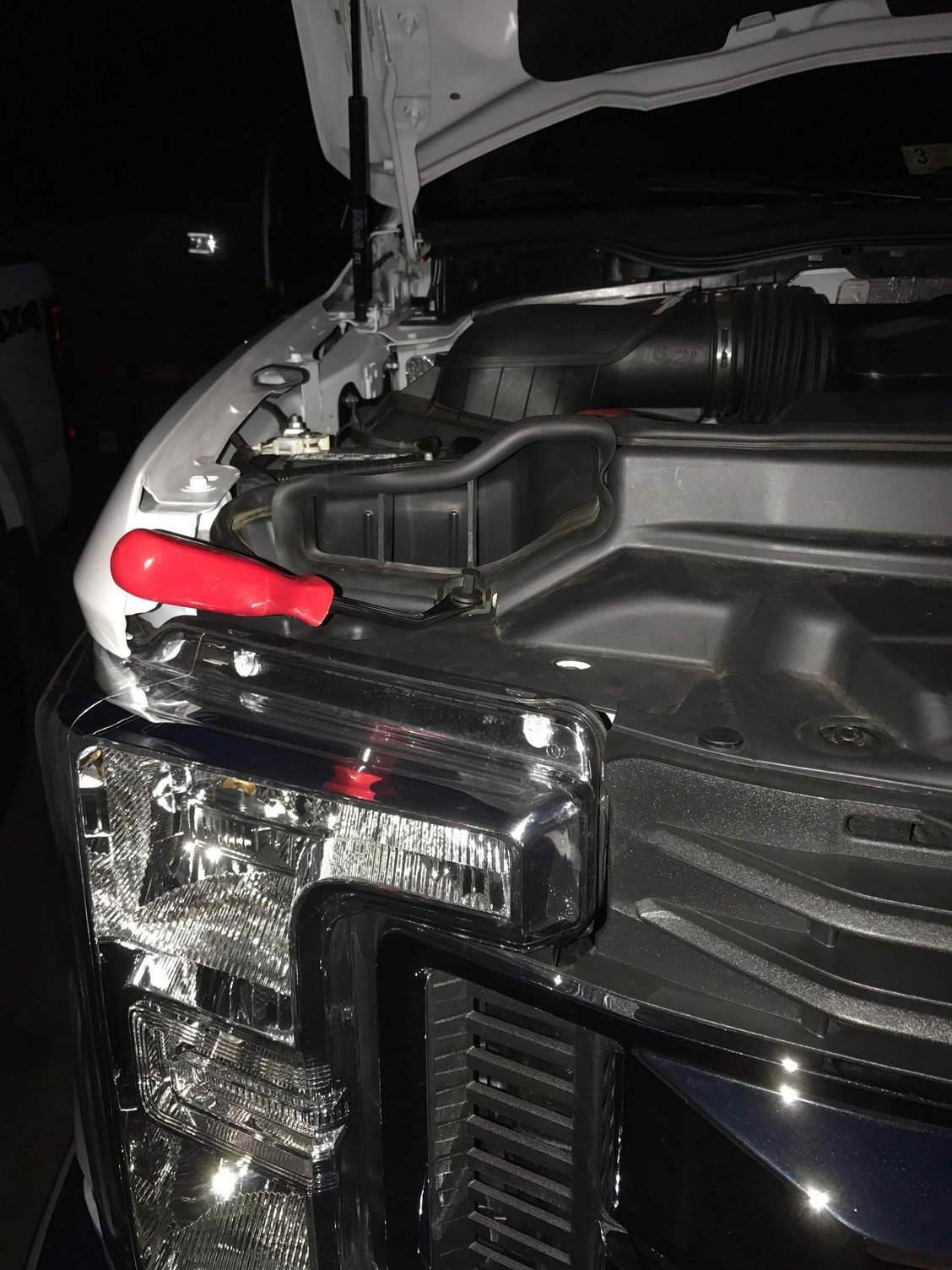

Don't pull the Battery wast of time
Easy just pull the the air funnel. There is one pin in the center, two tabs on the sides and you have full access. If you want I can take some pics
I just PM you
Old Aug 21, 2017 | 07:35 PM
user 474747383's Avatar
user 474747383
Joined: Aug 2016
Posts: 1,182
Likes: 176
Plenty of room to change the bulbs
