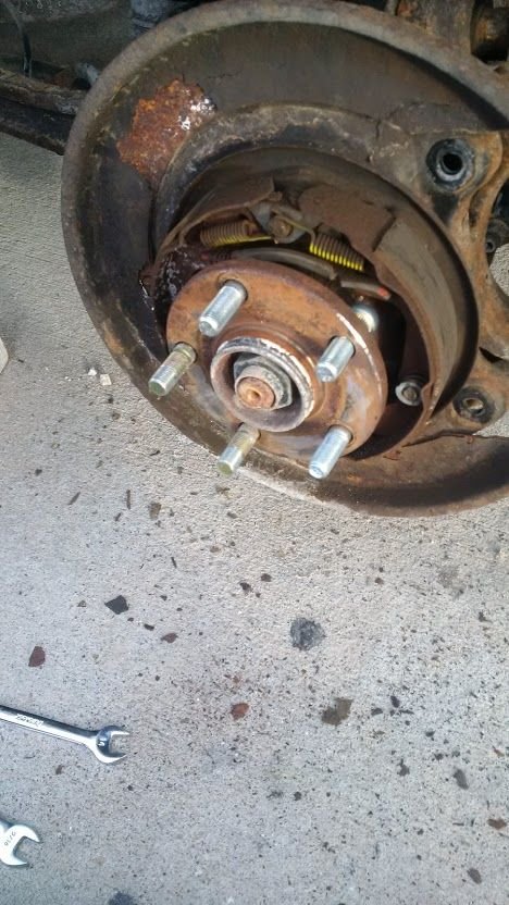

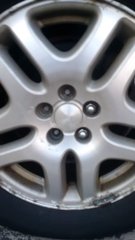

I've also seen, in person, with my own two eyes, a guy driving a car with 5-lug rims using only two lug nuts.
Hey I have done that Was it me? Coming up I25 in New Mexico driving the Subaru about midnight felt a bad wobble. Pulled over 3 of 5 studs snapped off. Called looking for a tow and was told 3 hour wait wait and $500. Tightened up the remaining 2 as much as I dared. Put the hazards on and rolled 30-40mph for about an hour or so to the closest town with an autoparts store to spend the night. Bought studs and nuts in the morning and swapped in the parking lot. Even down south concrete and tools are cold working outside on January 4th lol
