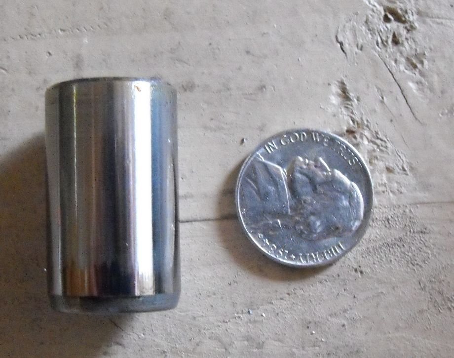

60 PSI at cruising is pretty good. Some drop is expected when getting on it with the mechanical pump, that's why some go with e-fuel.. The piston in the pump is very small, see picture below of a disassembled pump.
Could be you just had air in the fuel after replacing replacing injectors causing lower pressure, just a guess.
