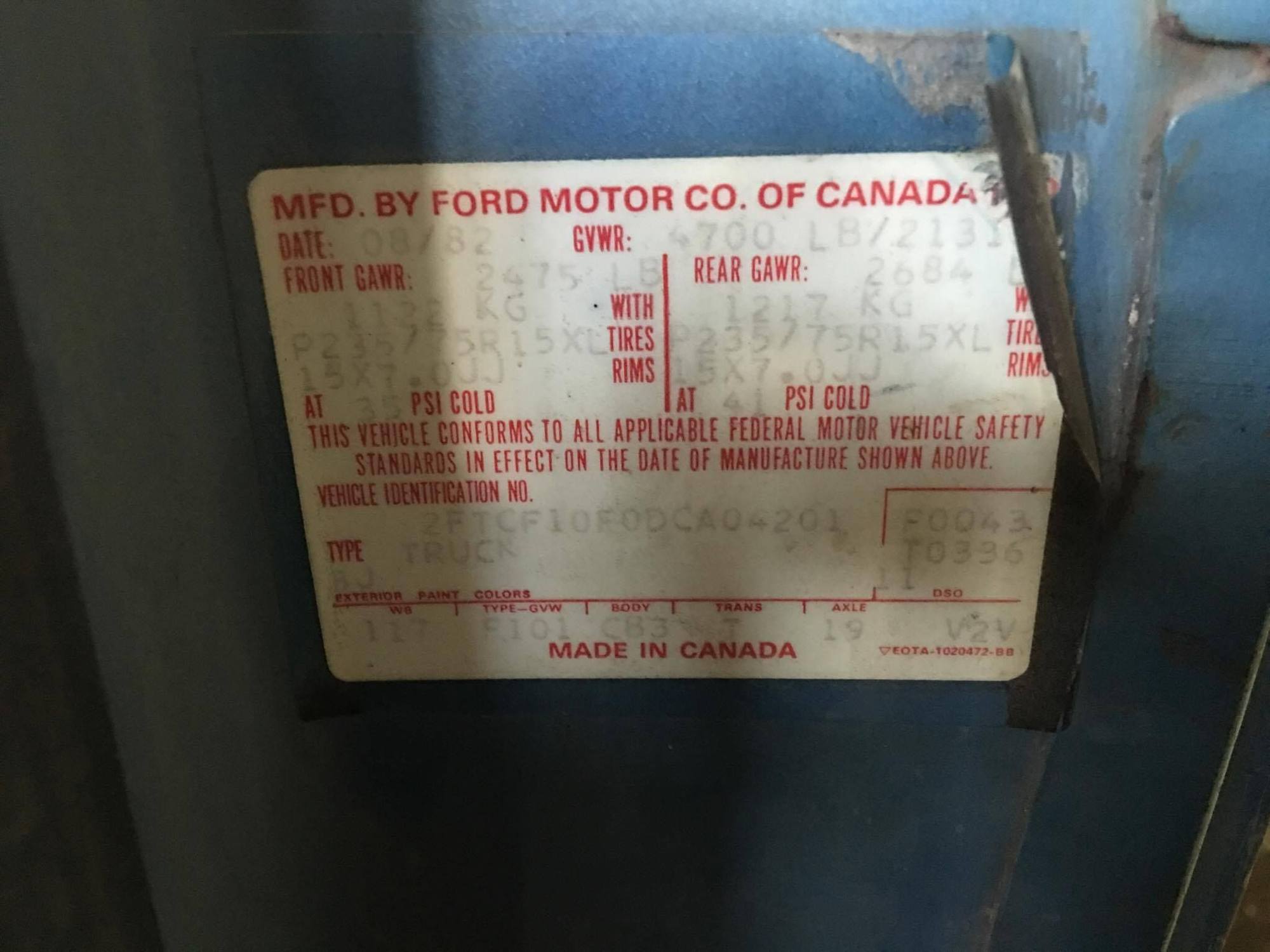

when ever you get a chance NumberDummy

What is it you want him to do?
You can do it your self here Certification Label - ???Gary's Garagemahal
2FT = FoMoCo of Canada - Ford Truck - Complete Vehicle.
C = Class 3 Hydraulic Brakes .. 4,001-5,000 lbs. GVWR
F10 = F100 2WD Pickup.
F = 302 2V
0 = Check Digit, FoMoCo use only.
D = 1983.
C = Oakville Ontario Canada Truck Assembly Plant.
A04201 = 1983 Numerical Sequence of Assembly, the trucks specific serial number.
I cannot make out the COLOR code.
DSO 11 = Boston MA Ford District Sales Office, where the original selling dealer ordered the truck from.
117" Wheelbase.
F101 = F100 2WD Pickup, 4,700 lbs. Gross Vehicle Weight Rating.
CB3: CB = Blue Cloth & Vinyl / 3 = Flareside Pickup.
T = Automatic Overdrive Transmission.
19 = Ford 8.8" Integral Rear Axle / 3.55-1 / 3,750 lbs. Rear Axle Capacity.
wow that sight is great...i could not sleep last night and i was checking it out at 2 AM
Thanx FuzzFace2
Yes it is a great site.
He just did a "make over" or more like a up grade / add on and changed something around.
I also see Bill aka ND did a de-code of the label and now you have to post up pictures of the truck.
We can never see enough flare sides
Dave ----
Dave ----
Thanks for the link Fuzzface2,
I was playing around with the tag info again this morning while having my coffee and was able to figure out a few things I had previously missed using that site. Great stuff.
Hey NumberDummy,
Just curious, but in studying my own data tag info on the Garagemahal page linked above, it shows on the Canadian district codes chart that "11" means export. Could that be the case with the tag pictured above? Truck built in Canada, and exported to the USA?
Mine shows "B3" in that location, which is Atlantic Ford, which makes sense for me since I know the dealer where this truck was sold new.
