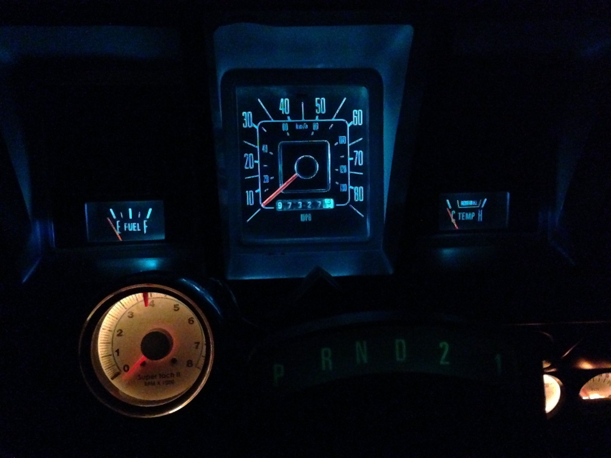

Ok, finally had time to mess around with the led dash lights I got from amazon. Changed them out and everything went well. The dimmer also still works with these lights. I read some reviews that people said their dimmers didn't work.
Before. The picture actually make the old lights looks brighter than they actually were. Even in pitch black they were very hard to see.
After, with the leds. Very readable dash now!!

Whether LED's dim or not depends on the bulb (and probably the dimmer as well) working together. Many LED's simply do not work with a rheostat, so those that post that theirs don't dim are usually correct and telling the truth in their case.
Great that yours do dim though. Score!
