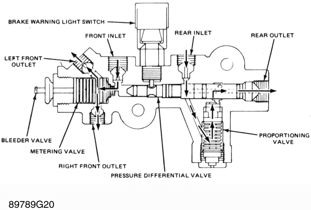

Well there are the metal brake lines where they come out up top down to your flexible brake lines or the metering block--the only other place where fluid to individual wheels is still segregated. Of course, if you change that, I'm thinking to myself that you would want to have the hardware around to replace the brake lines--that's the kinda crap that happens to me-starting a job and "oops I don't have that"
These are around $30 to $50.
